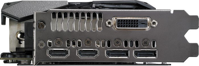

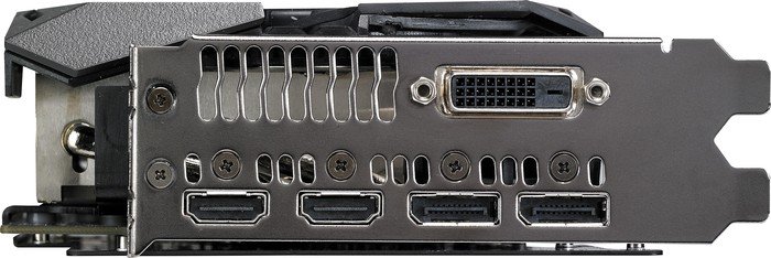

Works, but this one is a very oversize video card and when installed will block the PCIe slot-2:
Any GPU that the heatsink is wider than the GPU PCIe slot bracket, easy to see with the photo above, will gonna block the PCIe slot-2.
Yep, a sapphire nitro + looks the same and it does block a port.
I am not using so I'm OK with it but if I need to expand I will have to get a pci expander (or whatever is called)

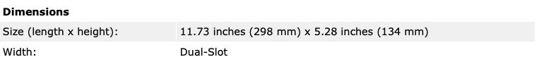

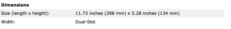

On gpu-zoo.com, it says 2 slots:
Maybe i should buy this one, because is more powerful than the classic one, but i have seen just one, and i think someone is buying it 😵😅😓...

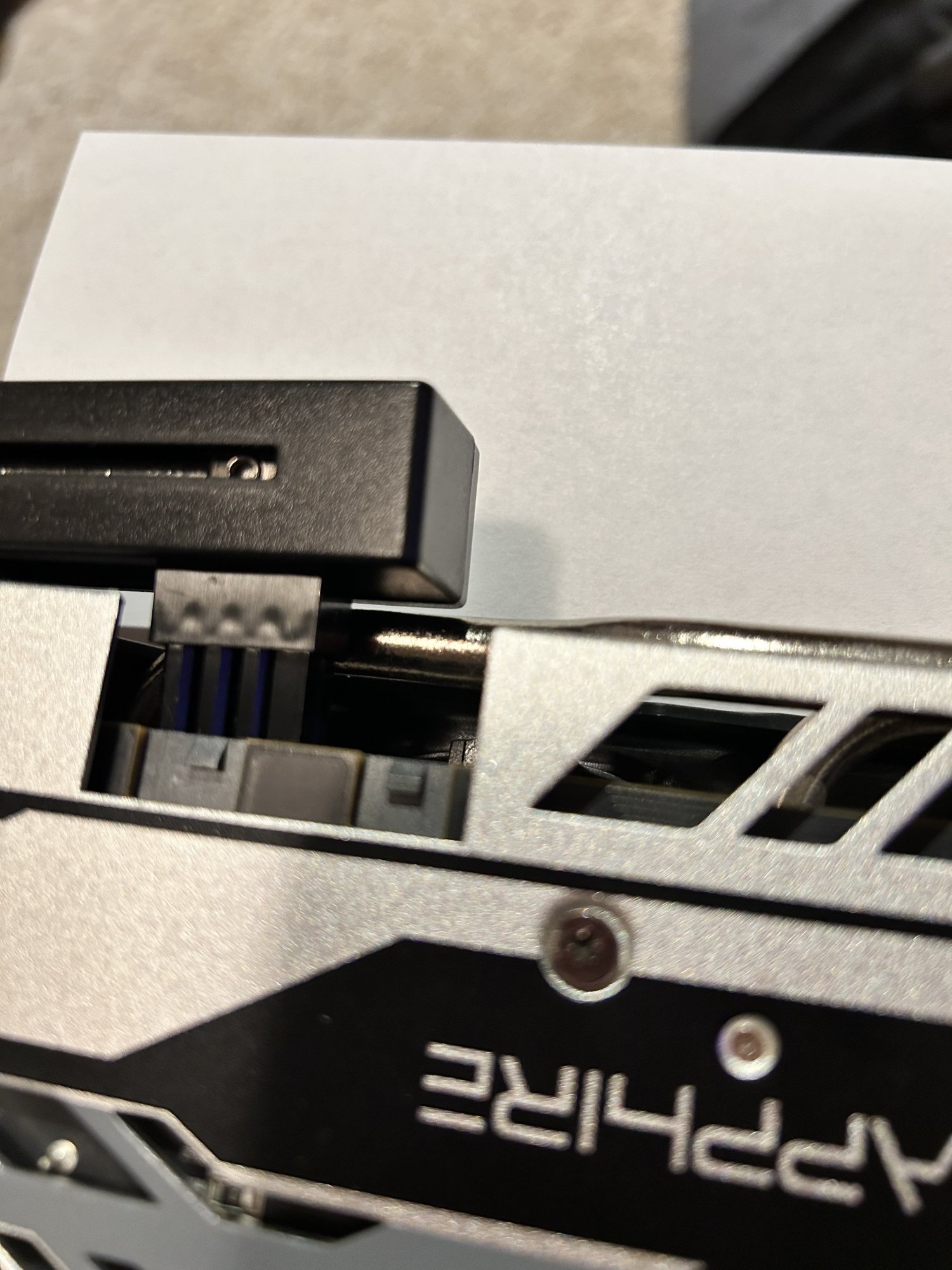

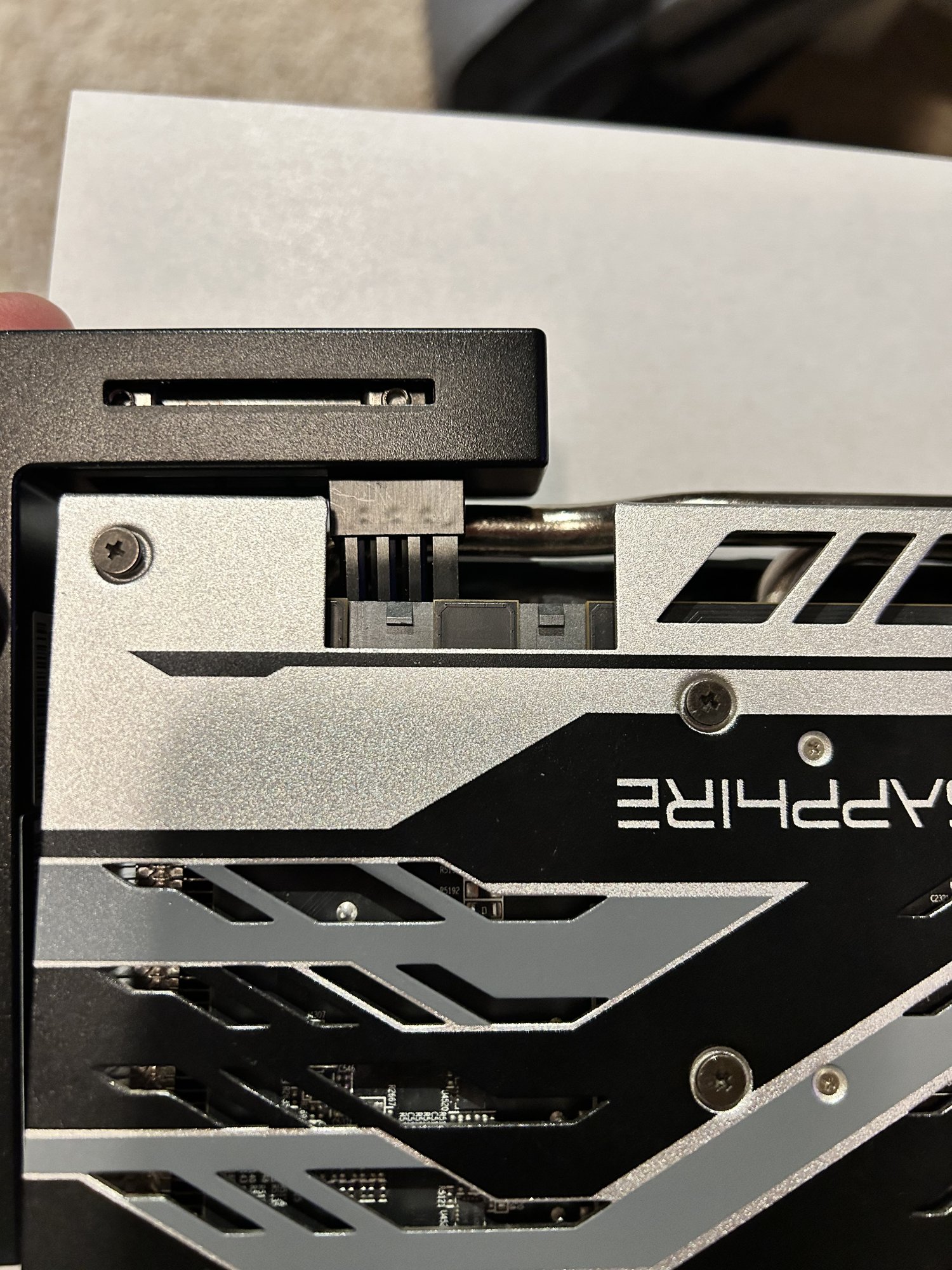

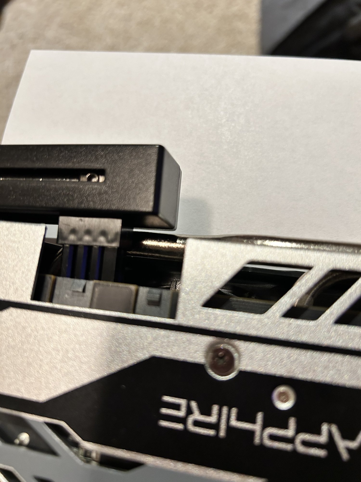

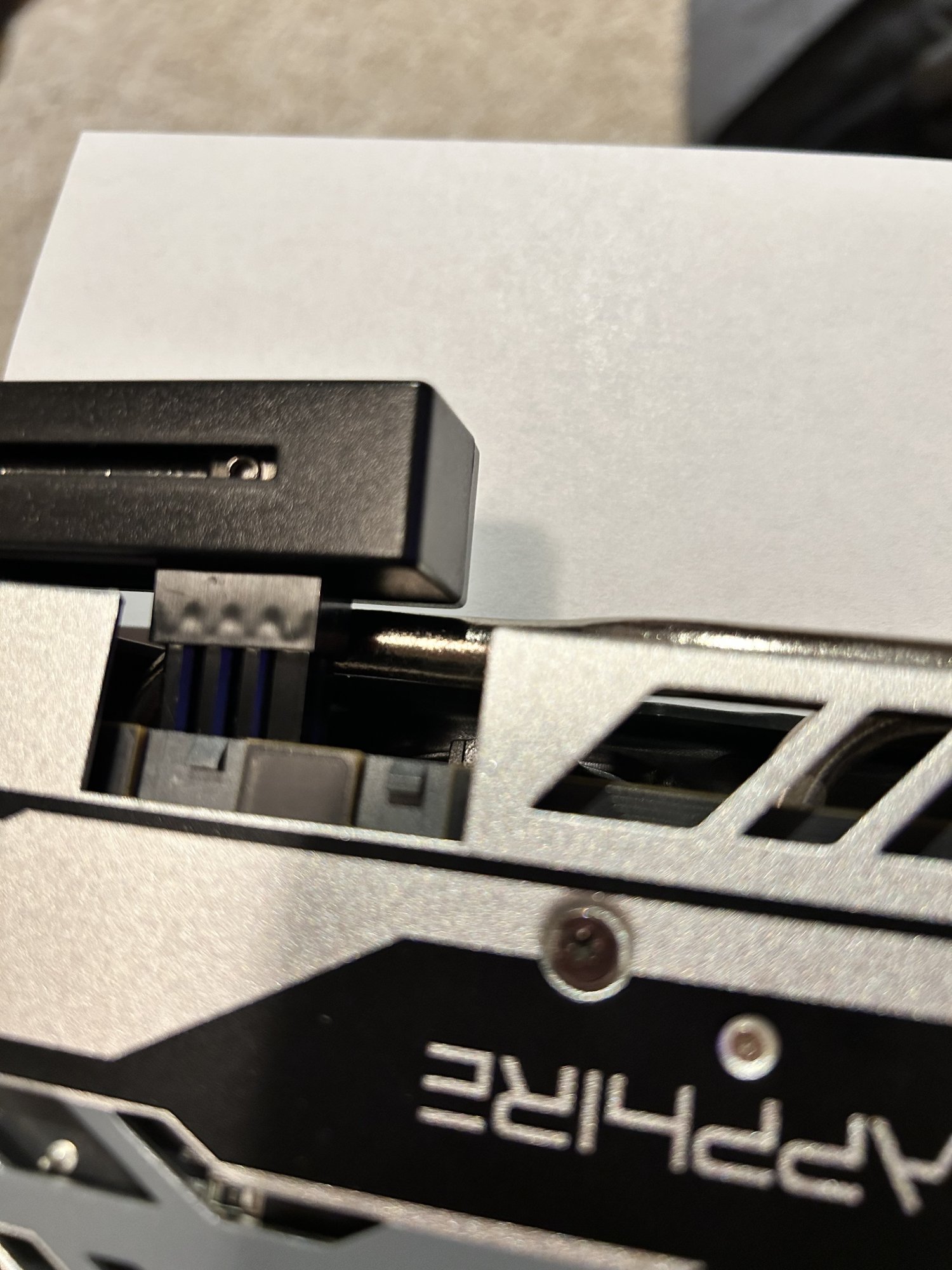

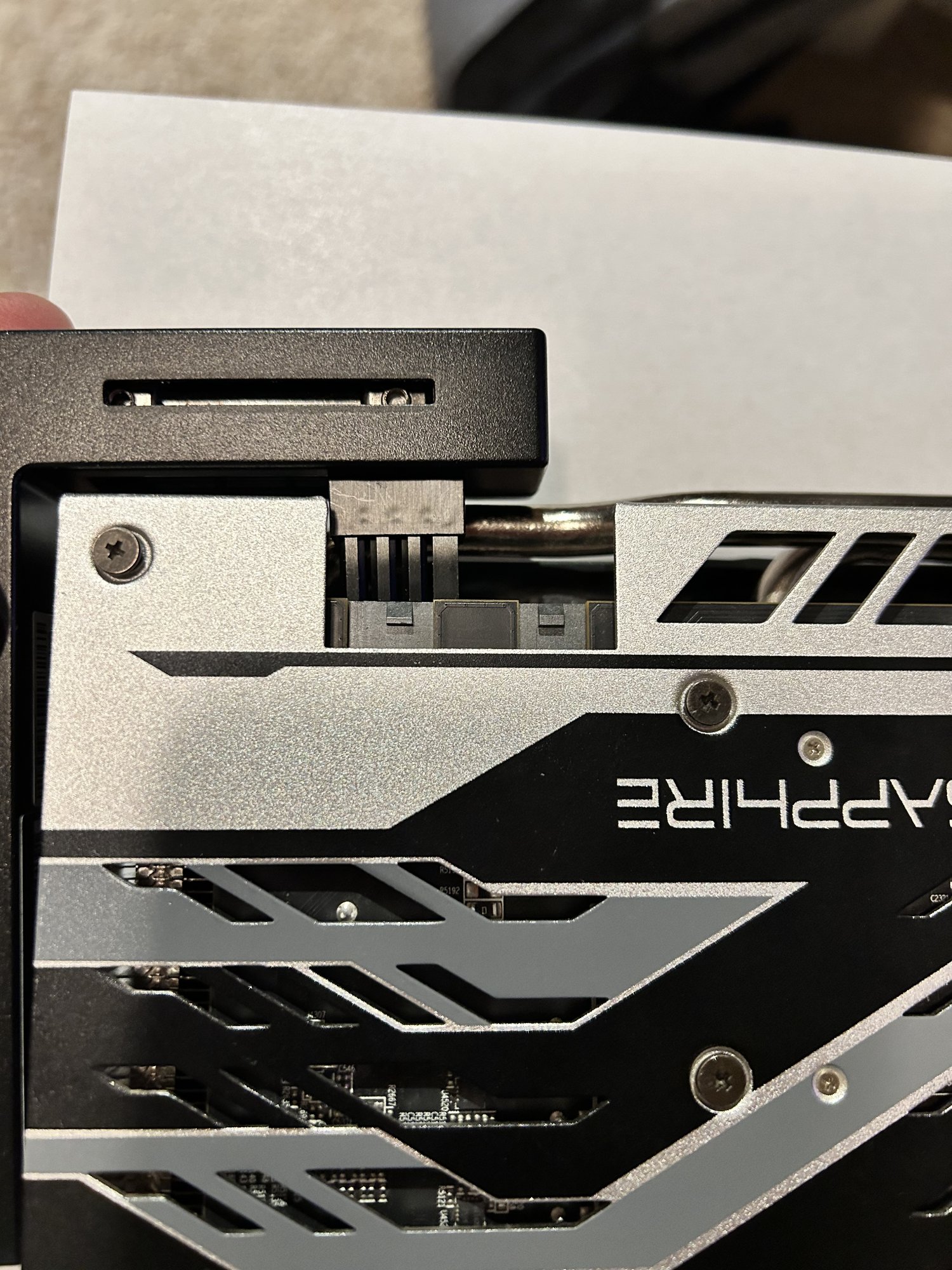

I bought one of these but apparently did not read between the lines that it works best with evga cards.
My sapphire did not work
Oh well
