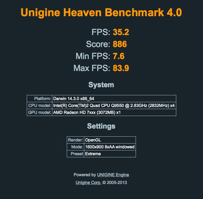

I can confirm that R9 280X is a reasonable upgrade for an old comp to replace autdated graphic cards. FCPX works a lot faster now.
Unigine Heaven Benchmark:
Unigine Heaven Benchmark 4.0
FPS: 35.2
Score: 886
Min FPS: 7.6
Max FPS: 83.9
System
Platform: Darwin 14.3.0 x86_64
CPU model: Intel(R) Core(TM)2 Quad CPU Q9550 @ 2.83GHz (2832MHz) x4
GPU model: AMD Radeon HD 7xxx (3072MB) x1
Settings
Render: OpenGL
Mode: 1600x900 8xAA windowed
Preset Extreme

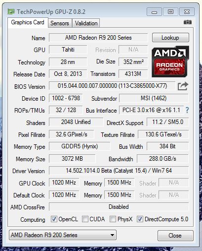

Trying to avoid too much work I threw caution to the wind and flashed it with mr Zarniwoops bios, looked great and appeared to work fine except that the RAM on the card was showing wrongly a huge amount, I was not sure if this is just cosmetic or affects performance. Then I see mamfo had the exact same problem, great I think I will just use the rom posted for hi,e unfortunately I get VBIOS not found error when trying to flash with his rom but the original Zarniwoops bios flashes fine. I opened both up in a hex editor and can only see the bios string as being different, I double checked using cpuz that mamfo bios is the same as mine which it is. (however both have x77 at the end and its written as 077 in the bios - does that matter?)

I could live with mr Zarniwoops bios as long as I know that the incorrect RAM amount is just a comment (shows up in windows gpuz incorrect as well) and doesn't affect speed

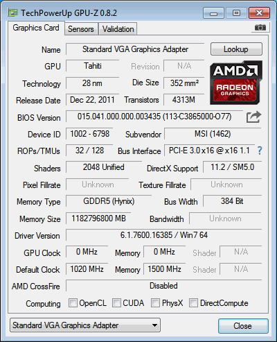

I have the exact same model EAN and UPC as zarniwoop so I expected his to work out of the box but I see strange memroy size in gpuz see attached.

in the GPUz screenshot i noticed that the OpenCL box is not ticked, thinking it was a driver issues in windows I installed the driver from the disk that came with the card and its still the same and some fields show as unknown but I have see screen shots with OpenCL ticked and also all fields filled in.
does the displayed memory size matter or is it just cosmetic.

I have just reread the thread and must have somehow missed the posts from someone with the exact same issue and reply about incorrect memory size so I try whats suggested - thanks
