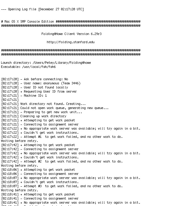

Im trying to get set up with F@H, but i can't seem to get the Client to talk to the work server (i guess thats how it works?) Im a bit new to all this kinda stuff. I have been looking through the guides on the stanford site, but i can't seem to make head or tail of it all. I have tried to get it set up through the terminal/console client, but am a bit clueless. (although fascinated by how it all works!) (i do understand programming to an extent, and am ok with programming instructions but i can't really 'just do it' per se.
At the moment i have the Graphical Interface installed through the system preferences. I have applied for, received through the stanford.edu site and input my passkey into the system preferences pane, and have set myself to be in team 3446.

If its the system preferences version, then its likely v6.
Without seeing the log, it's hard to be sure, but i suspect that the normal v6 work server is out of work. Try adding the -advmethods flag to the additional parameters and see if that helps
(first stop the client, wait a minute, add the flag and start it again - i've never had much luck with the graphical clients setting flags properly so it might not stick on your first try)

lol.. i can only answer about 2 of the 6 questions set there? ahaha ;)
Twoodcc was correct its version 6, 6.29r3 to be precise. (i do know how to find the F@H text log file under library. (see included) I'm on lion 10.7.2, most up-to date etc etc (I'm obsessive about such things)
Looking in the client.cfg file its stating that I'm anonymous-(although checking system preferences i noticed that it had changed from my name i registered-MWPULSE, to that in the F@H pane, also it wiped my passkey. The team name remained however.
I haven't touched anything under the 'advanced' tab, nor 'networking' I don't use proxies anywhere particularly...
I have also included the client.cfg opened up in textedit (lavv that program sometimes lol)
What is the SMP Argument? Sounds dangerous! haha ;)

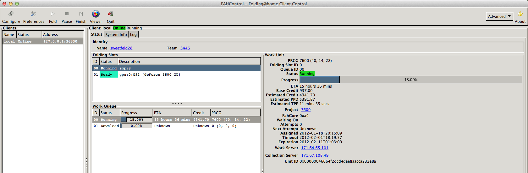

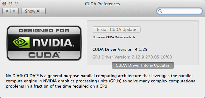

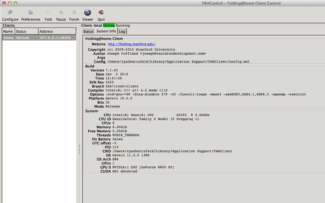

Ok, I have recently got my hands on a 8800GT for my Mac Pro. Ever since I installed it, I have been trying to figure out how to get the CUDA crunching numbers for Folding. Does anyone know how to get this working with the Folding@Home open beta 7 release 5?
In the System Info pic, it states that CUDA is not detected. Even though, I installed the latest Dev drivers, and CUDA drivers for OS X.
Here are some screen shots of what I am looking at:

Pretty sure GPU folding for OS X still doesn't work in v7. Maybe in the future. Have you heard otherwise? It says CUDA is not installed. Did you install it?

yes it does. that card might work for folding in windows, but you didn't buy a mac to run windows. hopefully we'll get GPU support for mac in the near future though
Even if we do, it may not be very much of a benefit because Macs use ATI cards now, which aren't as good for Folding.
