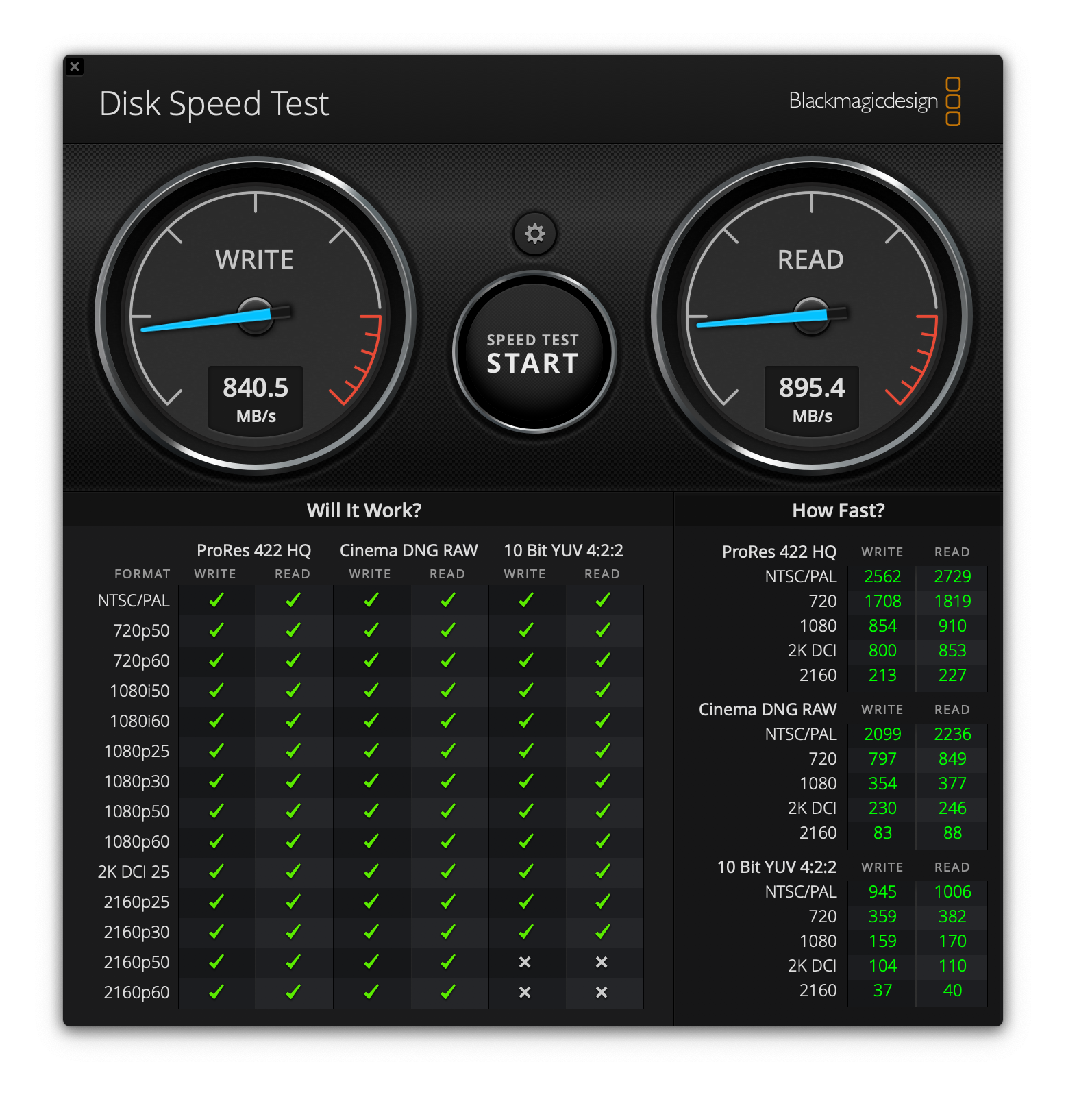

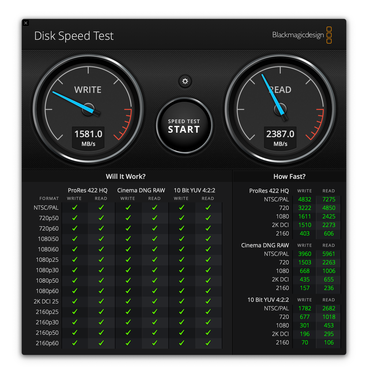

I was testing different methods of booting from external drives on my 2019 iMac (i5, 24GB RAM.) Here are the BlackMagic speedtest results of different drives I tried:
Samsung T5
Samsung T7
Samsung X5 (500GB)
NVMe enclosure with TB3 connection (using Samsung 970 EVO, 500GB)
Hope this helps.
Samsung T5
Samsung T7
View attachment 940593Samsung X5 (500GB)
WhAt was the brand and model of the NVMe enclosure with TB3 connection?
Hope this helps.
What was the brand/model of the NVMe enclosure with TB3 connection?
