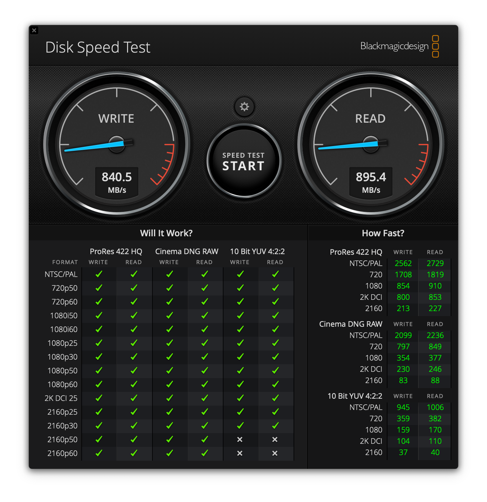

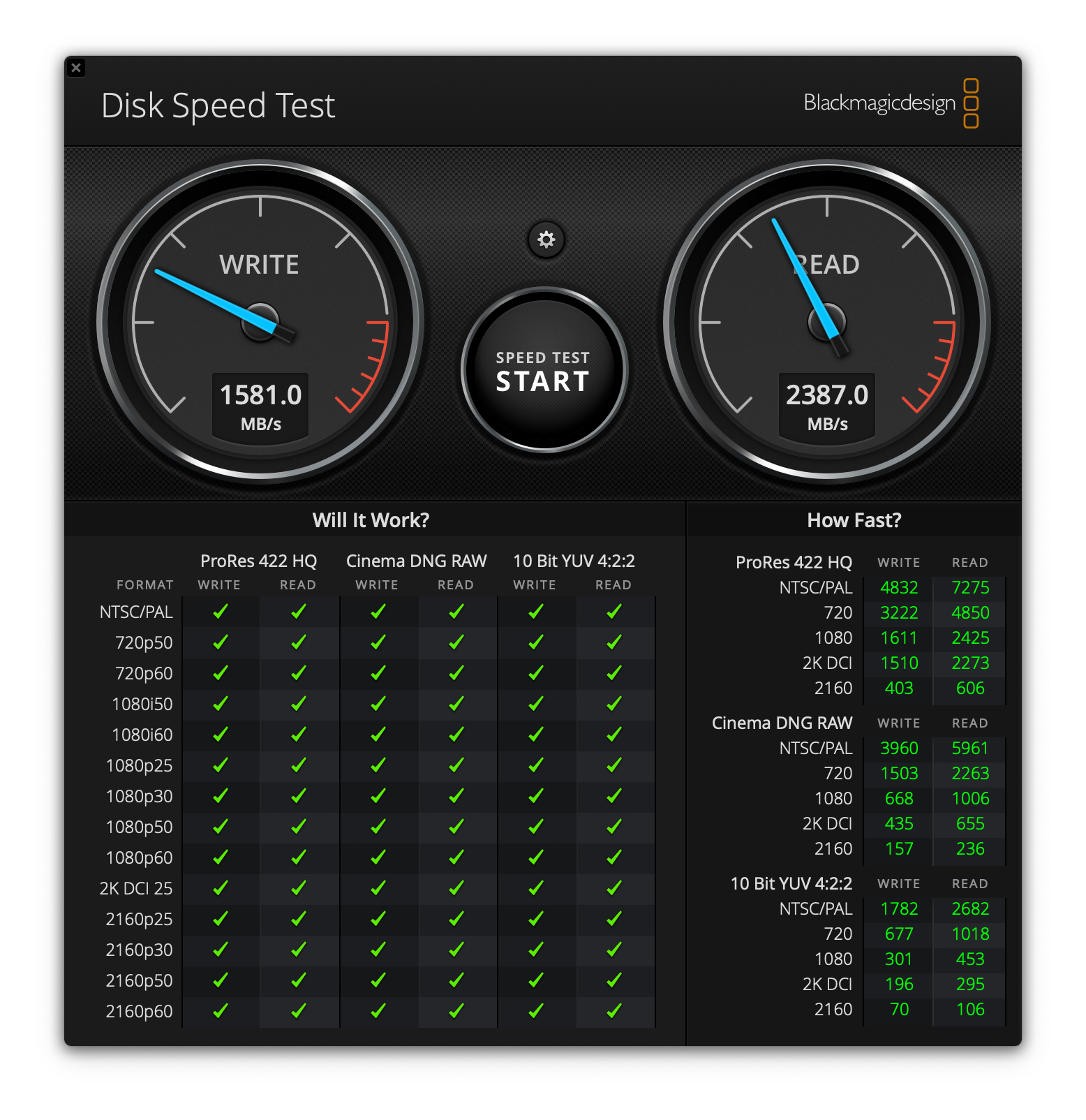

I was testing different methods of booting from external drives on my 2019 iMac (i5, 24GB RAM.) Here are the BlackMagic speedtest results of different drives I tried:
Samsung T5
Samsung T7
View attachment 940593Samsung X5 (500GB)
NVMe enclosure with TB3 connection (using Samsung 970 EVO, 500GB)
Hope this helps.

Good point. For the TEKQ, however, I'm getting 1500/2400 speed using the Samsung 970 EVO so it's close to the max speed of the controller.
