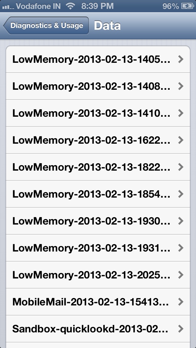

I would like to add that in theory almost all OSes nowadays should handle the memory issues without restarts or resprings.
But practical scenario is far from ideal. I have attached the screen shot log of my diagnostic reports. At 8.25 PM springboard crashed on me for no reason and when I saw the log it was the low memory.
And yes it was after being jail broken. Before which I have had low memory logs but it never crashed my phone. So jailbreak tweaks are not that perfect and for some reasons iOS cant deal with memory issues when jail broken.

I interpreted your previous post as if you were saying that low memory due to apps/tweaks hogging resources in a manner that Apple approved tweaks and apps normally won't can't cause app crashes or system wide instability. Also, that you said that low memory is never a problem when in reality low memory logs just before a restart of Springboard are far from uncommon made me doubt you.
Some tweaks aren't perfect and iOS can handle most memory issues despite being jailbroken. It's memory issues due to crap tweaks that causes the problems 🙂
