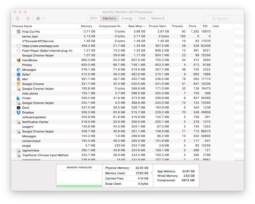

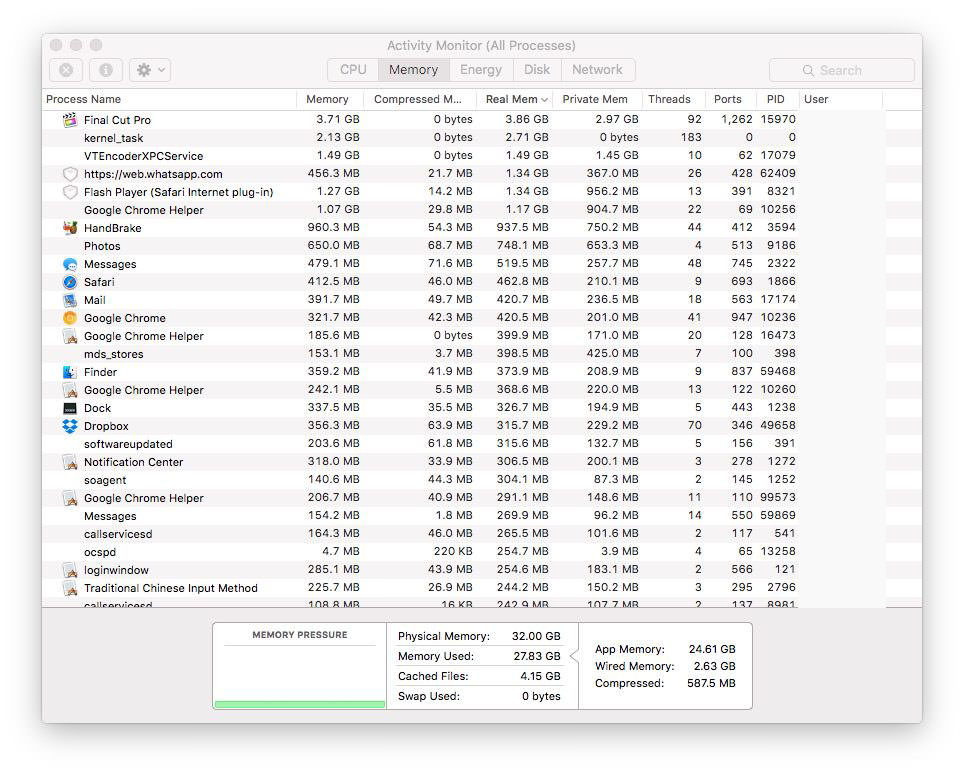

What do you do with 24 gigabytes of RAM?
I don't know how about him, but my machine constantly use up 24G of RAM (or more, the rest are all used as cache). I have 32G of RAM, and I simply use my Mac for Safari, HandBrake (almost running 24/7), FCPX (light editing, nothing close to professional), Chrome, Mail... these kind of "normal stuff".
I did think about run the RAM in 3x8 config for best speed. However, I end up still use 4x8G, and make sure I won't run out of RAM (however, my machine still occasionally need to use Swap).
