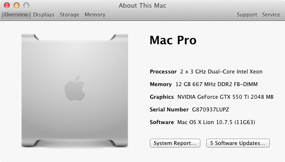

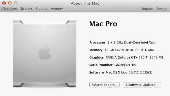

EVGA GTX GeForce 550ti 2gb Success!
I just wanted to mention that my recent install of the EVGA GTX Geforce 550ti 2gb version was a success. I have a Mac Pro 1,1 running 10.7.5. I hope this helps any new owners of first-gen Mac Pro!
Cheers,
Thoughtsponge
