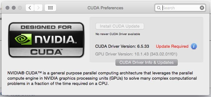

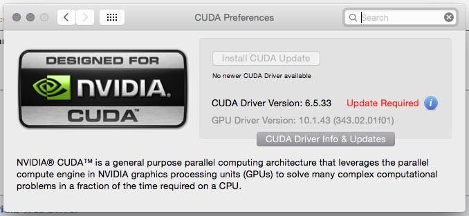

When I updated the Web Driver (343.02.01) The Cuda PP bug reappeared (Update Required).
Lou

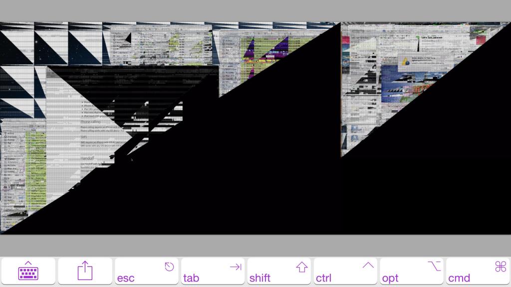

Mac Pro 3,1 on 10.8.4 (or could be 10.8.5). Recently my machine froze. After reseting, I was greeting with the following boot screen,
I tried to remote view thru Screens from iPad and get the same graphical corruption.
I am assuming my stock ATI Radeon HD 2600 XT video card is fried. (Way) too late for the recall as well. http://support.apple.com/en-us/HT203420
Assuming the fix is a new video card, I am interested in a low power card that will drive 2560x1600 displays x2 via DVI (or DP). I mainly use remote desktop, surf web, play videos, and occasional run Parallels. I am choosing between GT 640, GTX 650, or GT 740 (GDDR5). They are all Kepler GK107. GT 640 is slow with DDR3 but I won't need a power cable. The bigger question is whether any of these PC cards will boot without pre-installing Nvidia web driver. Too hard to see to install any drivers with the current set up.
I thought about upgrading to Yosemite and get GTX 750 or 750 Ti. But the thought of turning off kext signing verification to run TRIM Enabler makes it less attractive. Plus I remember reading that support for GTX 750 is not perfect yet.

^^^^It does appear your video card is gone.
You were correct.
