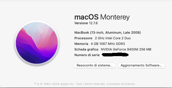

Just upgrade from Catilina to Monterey thanks to OpenCore
I was doubtful if the mac would hold up with only 4GB of ram and I was afraid I would have problems with the USB drivers, but it all works and I must say it is even faster than Catilina. Probably I will buy more ram.
Next step Sequoia 🙂

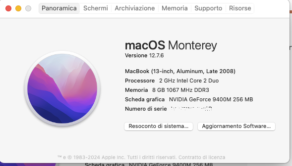

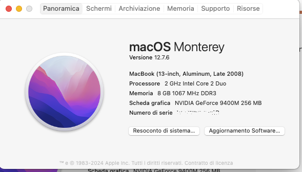

Ok ram upgraded to 8 GB
Better to stay on Monterey or is safe to upgrade to Sequoia?
You're probably better off staying with Monterey for now. You might be able to update to Sonoma after some additional development work is done to fix bugs. There is nothing in the newer version your hardware can run anyway
