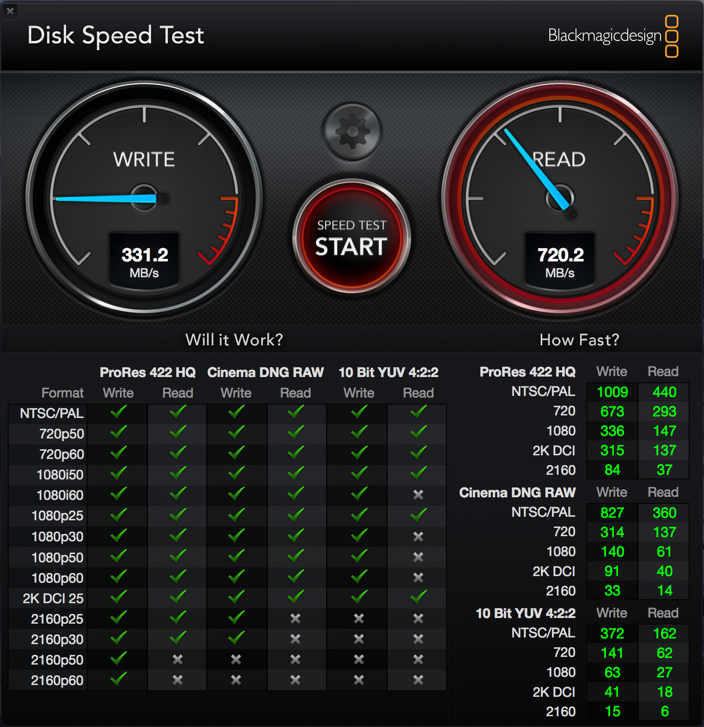

That's the timming for the Fusion in my iMac:

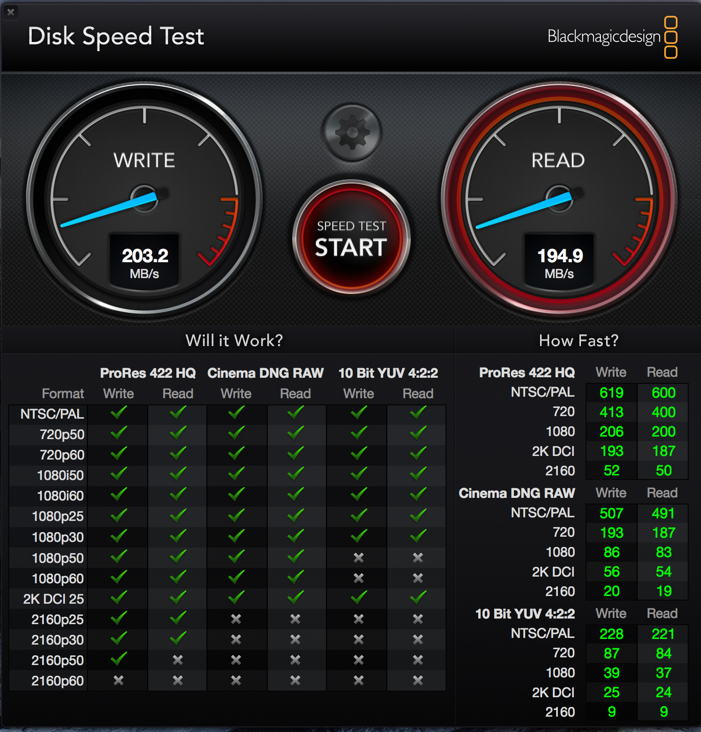

That another is from the SSD connected to USB3:
What do you think, folks?
Based on the images in reply 76 above, I wouldn't change a thing.
You cannot buy a USB3 (or thunderbolt) drive that will give you read speeds of 720mbps.
Just leave it alone.
That project would have no benefits. It would be as fast as current fusion drive.
New large ssd should be used without fusion. Then the old ssd can break without losing system.
The first 24 GB would be as fast as the first 24 GB that is correct. However the remainder drive would perform at ~500 MB/s instead of the ~150 MB/s the hard drive would support. Small benchmarks on the Fusion drive perform excellent, which isn't a very good representative of the overall performance of the drive. You need to compare a benchmark that would force it to access the HD like large libraries of rarely accessed media files.
I think you are measuring the wrong speed, if you are thinking about running macOS. Running an os is about IOPS not about gigabyte size video files.
