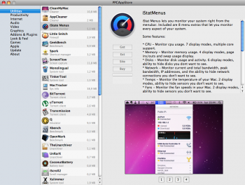

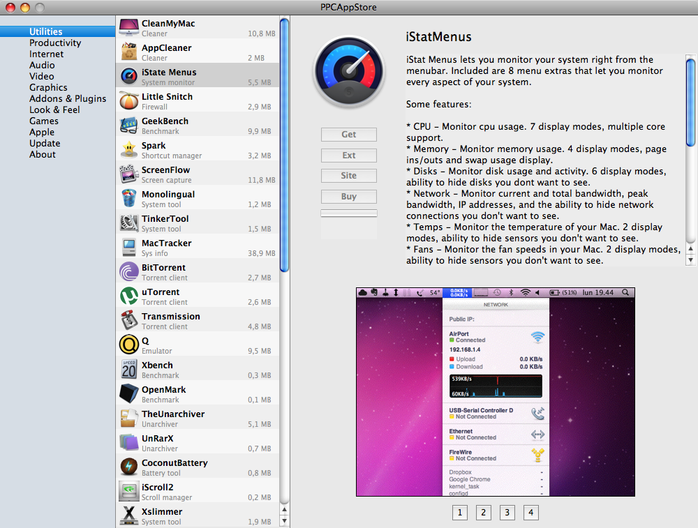

Verify what the idle temps are using iState menu from the PPC App store. Maybe the temps are already right on the edge before a partial CPU load spikes the temperature while using Classic.

Just for the record…it's iStat Menus, not iState. You may have trouble finding it looking for iState.

OK. I loaded it and the hottest idle temp registered is the cpu at 59 degrees and once starting Classic the temp went to 78 in CPU B core 1 (and that's with fans blowing). So is that why fans are picking on?
