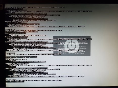

I recently picked up a regrettable PowerMac G5 to stand in for my G4 Digital Audio which won't turn on. (I wish I had just replaced the power supply, but I was taken in by the G5's relative cheapness.) My entire purpose has been to maintain access to old files and applications, which I can't do with the included OS 10.5.
After trying the wrong 10.4 install images, I downloaded and burned disc one of the correct 10.4.2 four disc set. (In several variations: Burned on two different drives and from two different sources of the disc images.)
Most of the time all that happens after launching the installer and restarting when prompted is that the machine restarts to the Leopard installer that is on the first partition of the drive in shipped with (a *laptop* drive, 200gb smaller than advertised, rattling around inside the bay).
The most I am able to acheive is an alarming looking error screen that insists I restart.
Physically, this computer looks like it has been abused, and Im hoping it doesn't have some significant and difficult to diagnose issue that is preventing my progress. (I have not troubleshooted the ram yet.)
If anyone has some insight into this, I would appreciate it greatly.

What disk set are you trying to use. Tiger usually came on dvds. If you got it from the macintosh garden they sometimes use multiple zip files. 001,002 etc. You need to put them all in a folder and unzip them. If you only burned a partial disk image it will cause the mac to kernel panic like that. Sometimes unzipping multiple part files hasnt worked on ppc mac and ive had to use my pc laptop with 7zip to unzip them and send the disk image over to the mac to burn it. If you are using a proper tiger multiple cd set i would stop and download the late 05 g5 10.4.2 restore disk. I know that works cause i just used it yesterday. That one is definitely one of those multi part zip files and all 5 parts need to be unzipped to make one working dvd image. You only need to unzip the first one and if it works right it should unzip the other 4 automatically and give you a dvd sized file. Again you might need to use a pc with 7zip or a newer mac or something like the unarchiver to get it to unzip properly.
EDIT: The part number for the late 05 g5 restore dvd is 691-5025-A. If you search that you should be able to find it on the macintosh garden.
The 4-disk set is for CDs, when there is no DVD burner to use.
I don't think you can describe that as the "correct" set.
The DVD image is for a single (dual-layer) DVD.
Maybe try a different image to burn from, such as one from this page: https://macintoshgarden.org/apps/mac-osx-mac-os-10-ppc
The best one here for you would be download #32, which gives you a disk image of the last commercial installer DVD -- version 10.4.6
( this is also the same Macintosh Garden site mentioned above )
Thank you for your promising suggestions Mustag, Delta, and Amethyst. Mine is the dual 2.3 (late 2005) G5.
Mustag, I have been using disc images downloaded from macrepository, among other sources (can't recall the other at the moment, probably archive.org). I burned one on a PC laptop before i encountered a set that was in toast format. Some of them appear to be identical, but with minor differences in the size by a handful of bytes. One of them I burned onto a CD, to rule out that as an issue. Another I burned on DVD my pc laptop, another still onto DVD on the G5, and others all burned on the G5. They all load and open and appear valid until actually attempting an install. I will make new attempts based on restore disks.
Thank you Delta, I'll give that version a try.
Amethyst, is that really the case? Why would they do something to produce such agonizing frustration to me, an innocent mac enthusiast!?
Yes, I remember checking disc one of that set. The kernel is version 8.0, which corresponds to Mac OS X v10.4.0. If it were v10.4.2, the kernel version would be 8.2.
Your install disks for your machine are to be found here
The first 5 downloads on the right should be the ones you need but if you are going to update to 10.4.11, you might as well start with 10.4.6 retail.
I downloaded those as well as the one suggested by DeltaMac, and they both WORKED for me. I ended up going with the 10.4.6, because the restore disk said that the second disk (comprised by the last 10 links in that list, oddly) would've required a dual layer DVD, and I don't have that blank media on hand. (Target disk mode is out, because I dont have another mac on hand from the same era, and I didnt want the hassle of creating a bootable flash drive.) That second disk appears to be a big bundle of good looking software, but nothing crucial to my immediate goal.
Thanks very much to everyone. It was looking doubtful the last couple days, but I finally found success, and Im extremely appreciative for your help.
