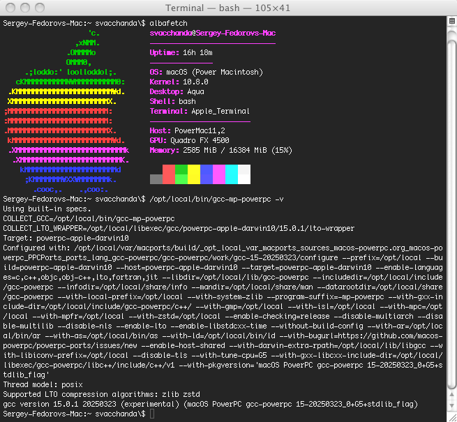

Latest snapshot of gcc15

P. S. Now we know that gcc9 works on ppc. I had an impression that it may not, though never tried using it myself (I went from gcc7 to gcc11 initially, and later it was always gcc-4.2 to gcc10 to gcc-the-latest).
Ability to build the latest gcc for ppc64 has been finally restored. Needs darwin-xtools 0.7.0 (specifically this version), available with GH upstream and my PPCPorts.
