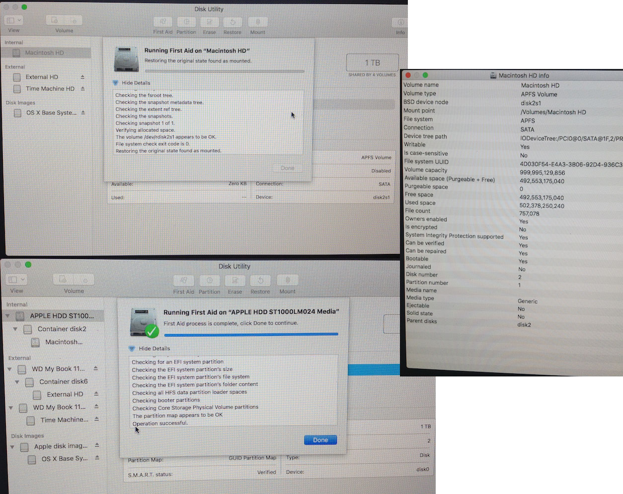

Boot to Recovery (command plus r) and run First Aid on your Macintosh HD (lower entry). You could be experiencing a failing hard drive. The symptoms you describe indicate a failing hard drive although it could very well be something else. It's possible with all the activity of installing High Sierra and the update to it may have caused the HD problems.
I have run first aid on the drive recently and it turned out fine. I've also used OnyX to repair permissions etc and clear all the old caches/garbage out. As I said this only started once I installed High Sierra (which was about 2 weeks ago) I never had this type of hanging problem on Sierra 10.12.

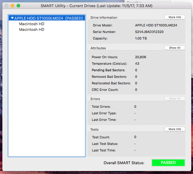

Jeez, guys.... I have no clue here... I even ran S.M.A.R.T. and the hard drive checks out fine :/ I really don't wanna format the drive, re-install everything from a time machine backup only to have this happen again.
