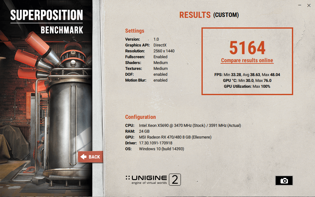

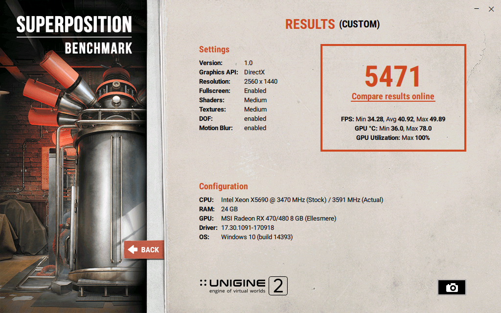

Alright! I've reached the end of Phase 2 of undervolting the RX 580. Amazing results so far. I feel like I have some headroom left, but I thought I'd recap:
Regarding Heaven 4.0 @ 1440p:
Out of box = 44.9 FPS.
Added +20 Power Limit = 45.4 FPS
Reduced voltages by 50mV = 46.6 FPS.
Added 20MHz to the core clock = 47.1 FPS.
Took another 10mV off = 47.4 FPS.
That's a gain of 3 FPS right out of the box with optimizations @ 1090mV.

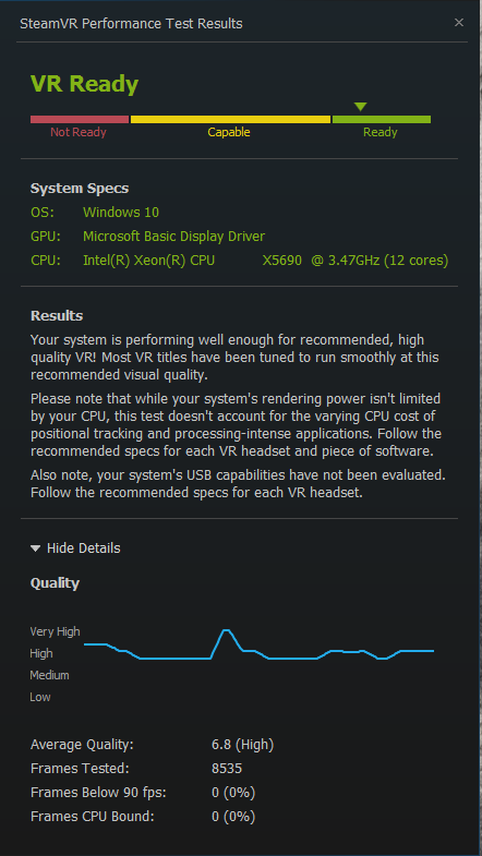

Regarding Steam VR, I went from a 6.8 to a 6.9. As expected.
Good ol' Super Position @ 1440p
Before:
After:

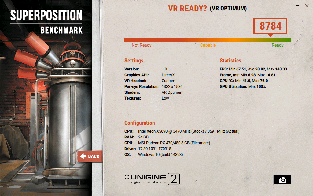

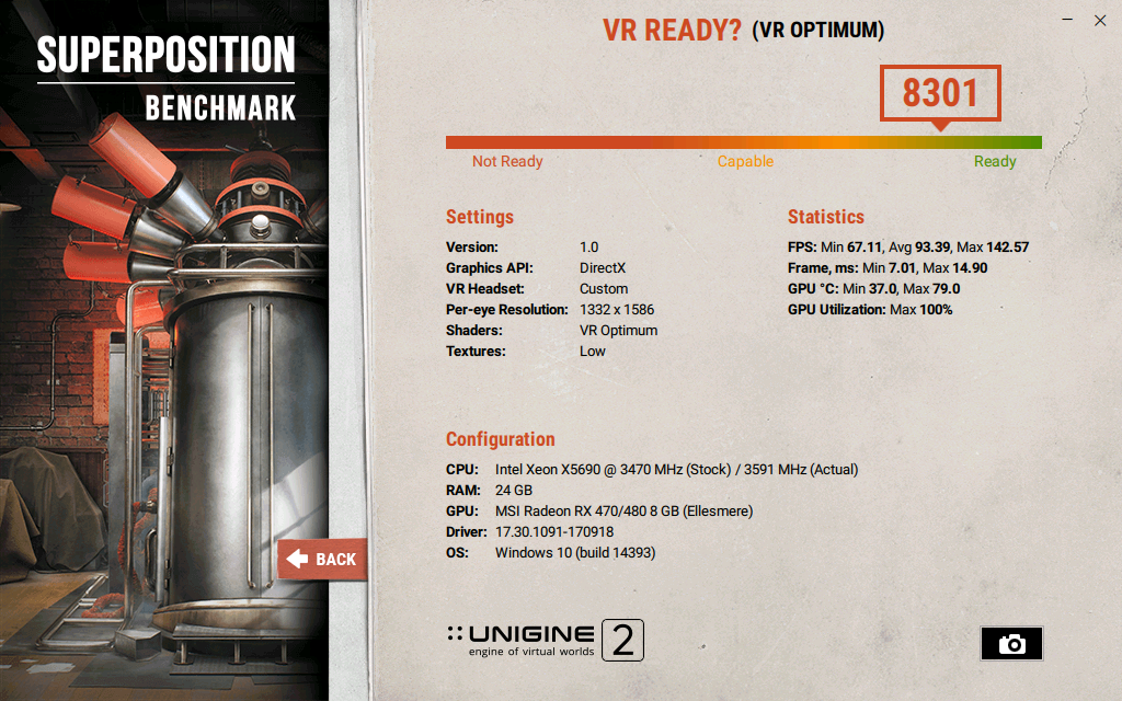

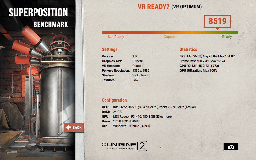

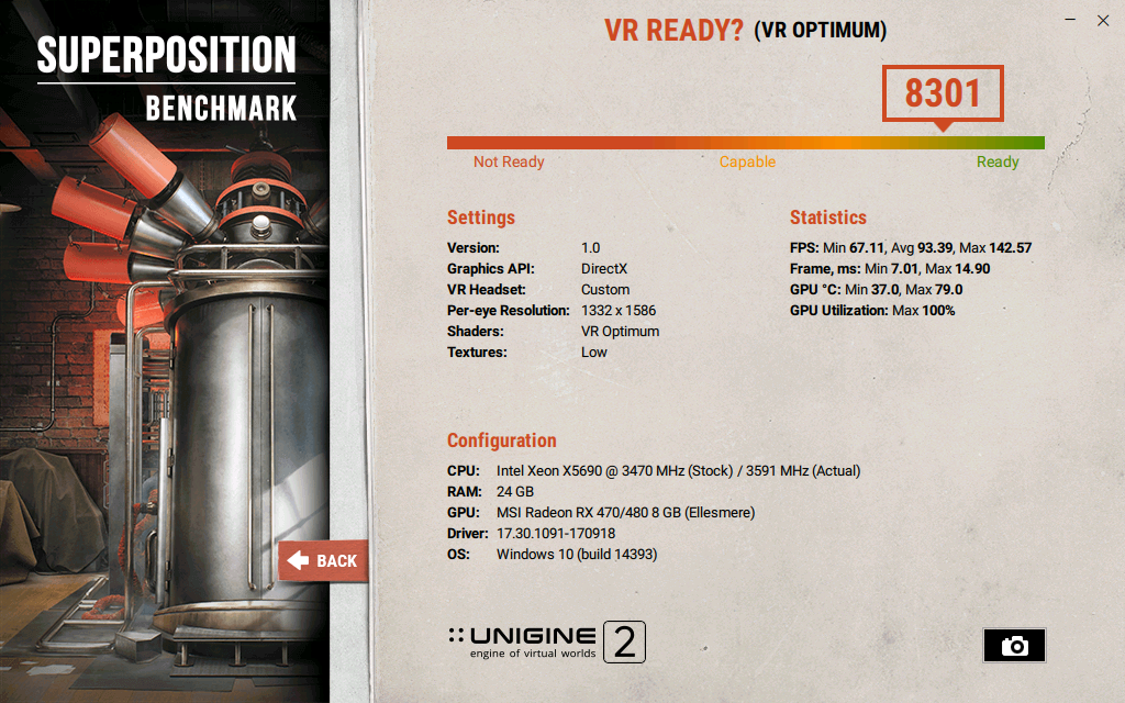

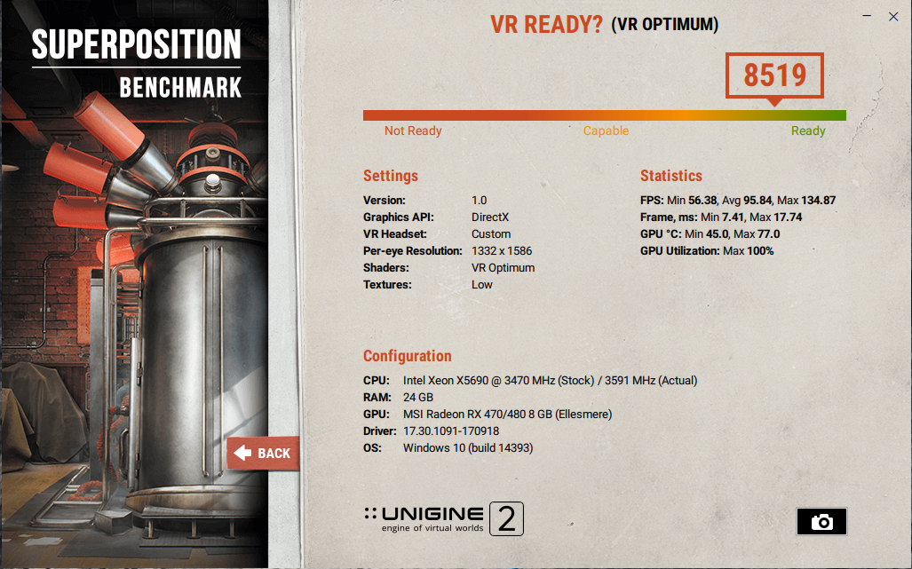

Regarding Superposition VR Optimum...some REALLY interesting results here. Screw the final number, look at the huge differences on the numbers that count.
Before:
After:

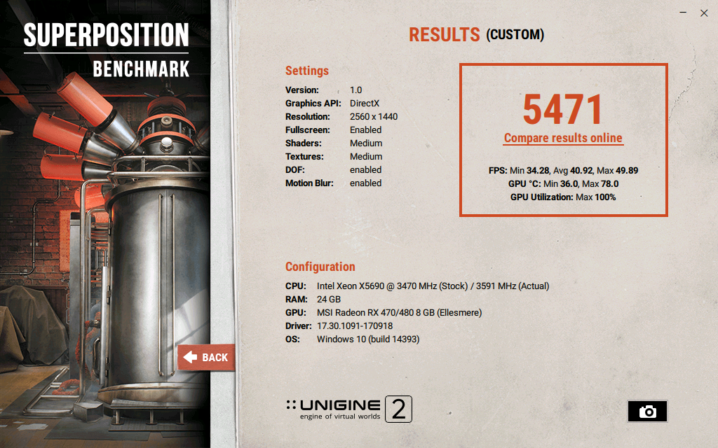

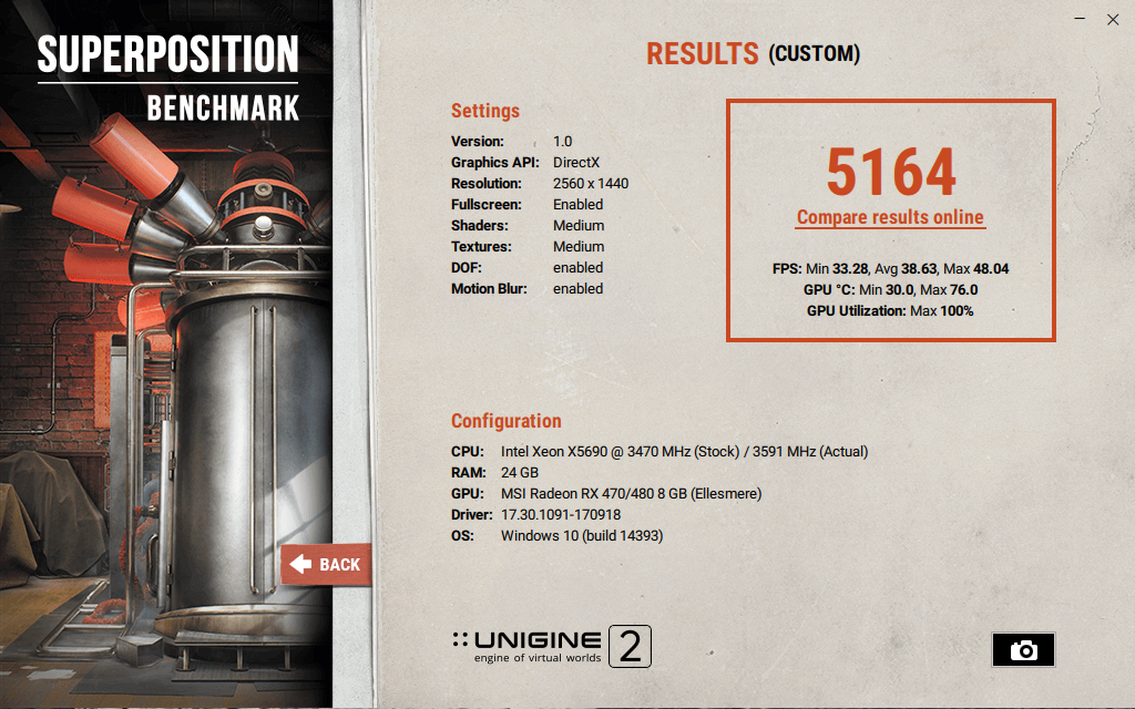

Before:
After:
Before:
After:
The superposition VR score is interesting. You have higher min and max FPS, but lower average. Anyway, the real single most important to define the gaming experience usually is the min FPS, not the average. So, that's a 18% improvement, looks very good to me.
Final mV set at 1060. I didn't even hit the floor limit either, but I finally hit a point where throttling was just about non-existent. FPS gains were starting to become very minuscule. No point to go further. Check out these bad ass numbers:
These gains are significant IMO. We're talking up to 10% faster overall performance, nearly 30w in less power draw, cooler GPU, and quieter fan speeds.

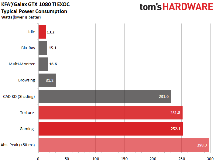

But I really want to avoid the FE, from what I studied, it's the slowest 1080Ti, but not necessary the lowest power consumption one. So, no point to go for the worst cooling solution.
EVGA looks good to me. It's a 250W TDP card, however, I can't found a reliable review for this exact card yet. A review is about it's similar model, which seems target at TDP 270W in real world. So, not sure if this is a good one yet. But technically, This 6391 model should work.
EXOC, just know this card an hour ago. At this moment, it seems the best candidate in terms of power consumption. I found this graph in Tom's Hardware review.
aHR0cDovL21lZGlhLmJlc3RvZm1pY3JvLmNvbS9GL1QvNjc4Mzc3L29yaWdpbmFsLzAwLVdhdHRhZ2UtT3ZlcnZpZXcucG5n.png
Its BIOS set the target at 250W but not higher. Also, the momentary peak is just 300W (some other card can go well above 400W, this may be the reason why some 1080Ti do trigger the cMP's shutdown protection).
