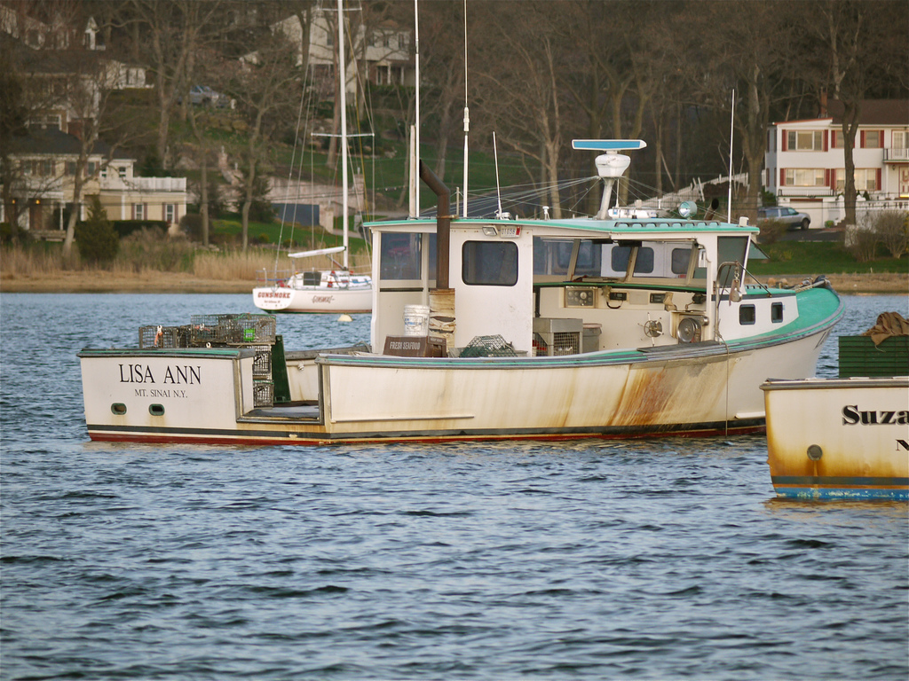

I'm not sure the others who have chimed in have succinctly identified the part of this "experiment" that makes it break down. So I'll put it this way:
You can't "take the same shot" in this scenario if you "mask off the edges." In order to get the same shot, you'll have to then step back from your subject. Stepping back from the subject increases the distance over which the camera has to be steady and therefore increases camera shake.
This is another good way to look at it.
Whatever way it makes the most sense to you, the fact remains that you have to consider the effective focal length, not the actual focal length, when calculating 1/focal length shutter speeds.
Well, it is a stabilized lens. The OIS is good for 2-3 stops, so 1/50 should be OK. At least he shouldn't have to shoot at 1/200.
well, the boat was moving (presumably), so one way or another, 1/50 is too slow. unless the boat was a mile away, in which case it'd look soft anyway.
I'll also say that I have taken several classes at the local community college lately (in Santa Fe, NM, where the community college has EXCELLENT faculty), and all of them have said of digital images, "You will always need to sharpen them with Photoshop." Do others find this to be true, or have I just managed to find some obsessive compulsive teachers?
when shooting RAW, yes, you have to sharpen. how much varies from camera to camera and shot to shot. in jpeg, most people have in-camera sharpening enabled, so usually it's not an issue.

Also I made some adjustments to that original photo using Aperture. It came out better as far as sharpness and I added a little bit more warmth to the image.
Original
Corrected
