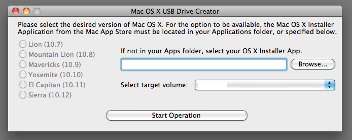

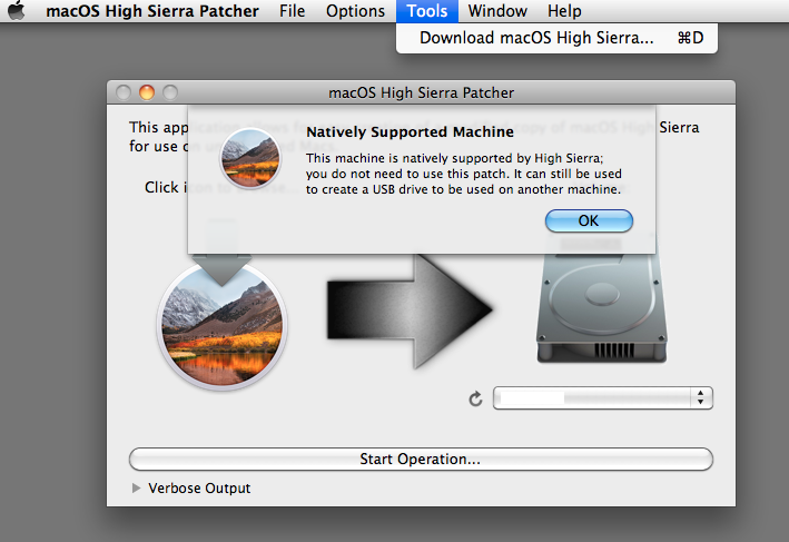

• Since I will be getting more of these old computers, should I try to master dosdude so I can use it in the future to enable those computers to run more recent macOS?
There's not much to master. Those are simple utilities for creating bootable installers, unless you use 'Post Install' option on High Sierra and later patchers.
