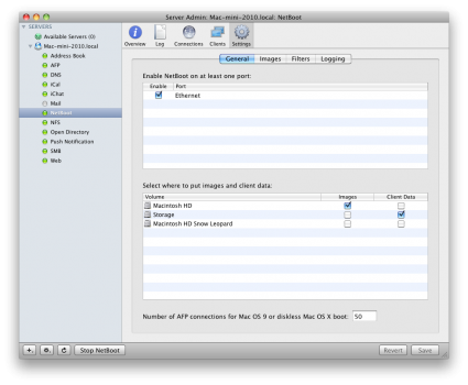

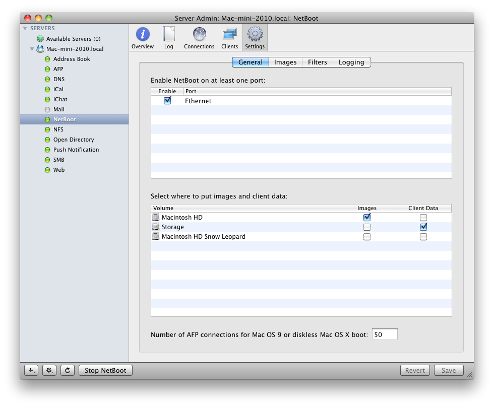

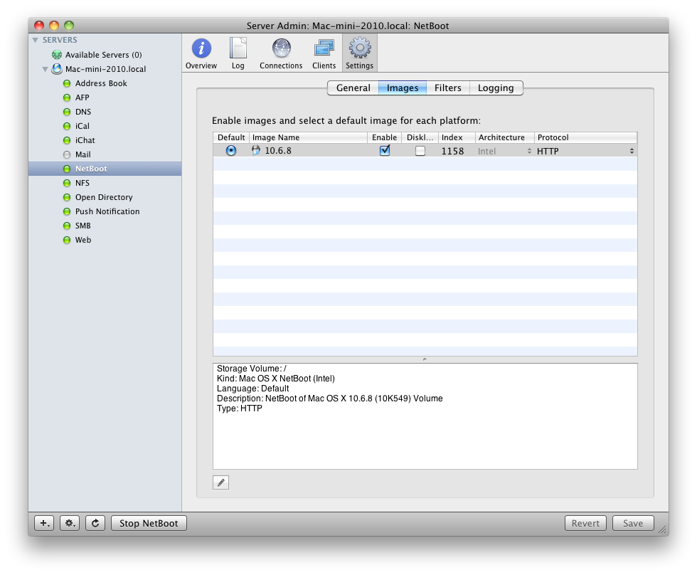

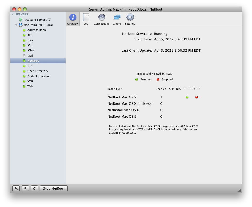

My next question is about why none of my computers are recognizing the Netboot image that says is created and running. I have tried connecting with WiFi as well as ethernet but it doesn't seem to recognize it. Is part of my settings wrong? Please see the attached screenshots.

When I am home I will take a look at my configuration and see what it looks like compared to yours.
Which Mac(s) are you attempting to boot from? As far as I’m aware it only works with Ethernet. Maybe newer ones can do it on Wifi but I mostly netboot old PowerPCs and very early Intel ones that don’t have internet recovery.
When you hold option on the target Mac, does it detect a Netimage at all?

@Project Alice I appreciate your advice. I guess I was making the mistake of testing using my 2010 MBP 17". I just tried with my early 2006 MBP and early 2009 iMac and it seems to work flawlessly. I wonder why it doesn't work with newer things. Thank you again, I am very excited to have this up and running! Your Mac mini setup as a server (which I greatly admire) was what made me want to do this project in the first place, but it's harder than it looks...

It looks like your image is named 10.6.8. Is it actually 10.6.8? If you attempt to boot 10.6.0 on the 2010 it won’t work as it came with 10.6.3 or 10.6.4.

@Project Alice The image is 10.6.8. In an unusual flash of competence I realized the 10.6.3 image I had wouldn't work with all computers so I used Target Disk Mode and took an image of my favorite 2007 MacBook running 10.6.8. (not as nice as your 4,1/5,1 that you impressively modified) It had all my apps too so it's more useful.
Also, I tried Netboot again on the 2010...and it works! I am actually writing this from my 2010 MBP netbooted. I think it might have been the ethernet that I was missing when I tried it (watch me try something new and do absolutely everything wrong) Or maybe it is some magic on your part. 😀
