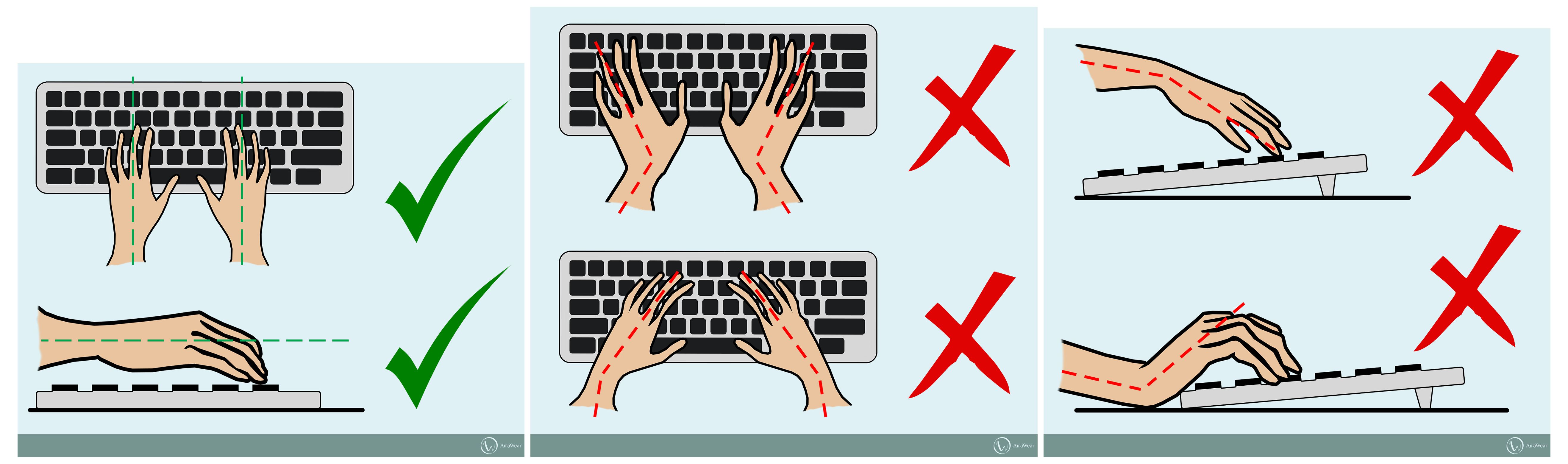

Turning off tap to click helps, but really no better solution than typing without resting palms anywhere. Rest your arms instead and hover with your palms above. It's not only great for avoiding accidental touches, it is also healthier for your wrists. It's the proper way to type, really.

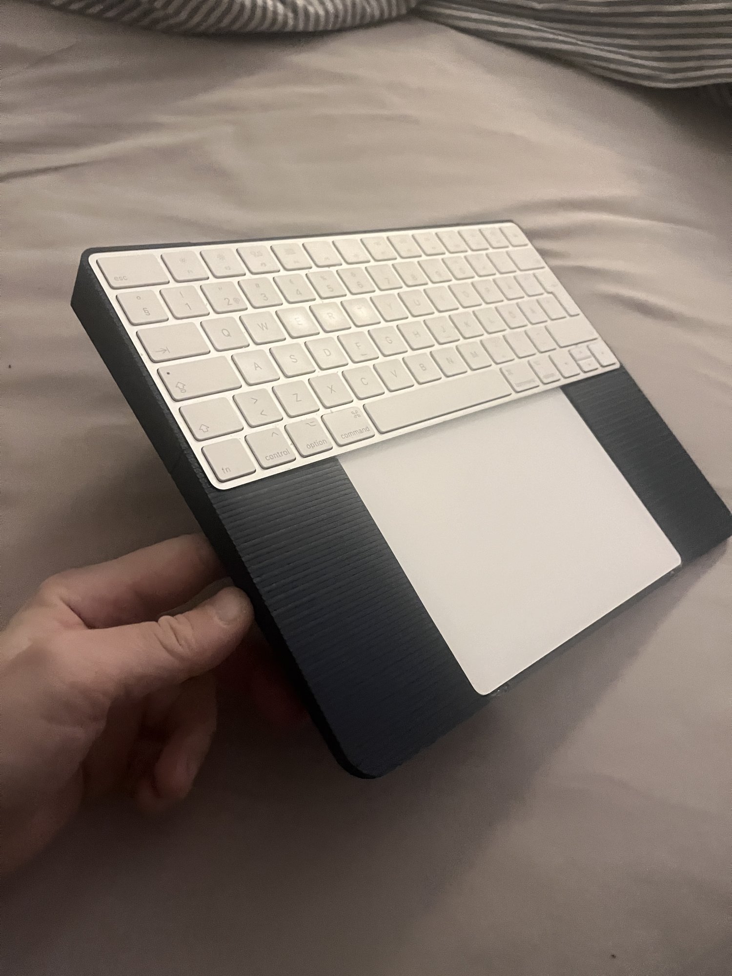

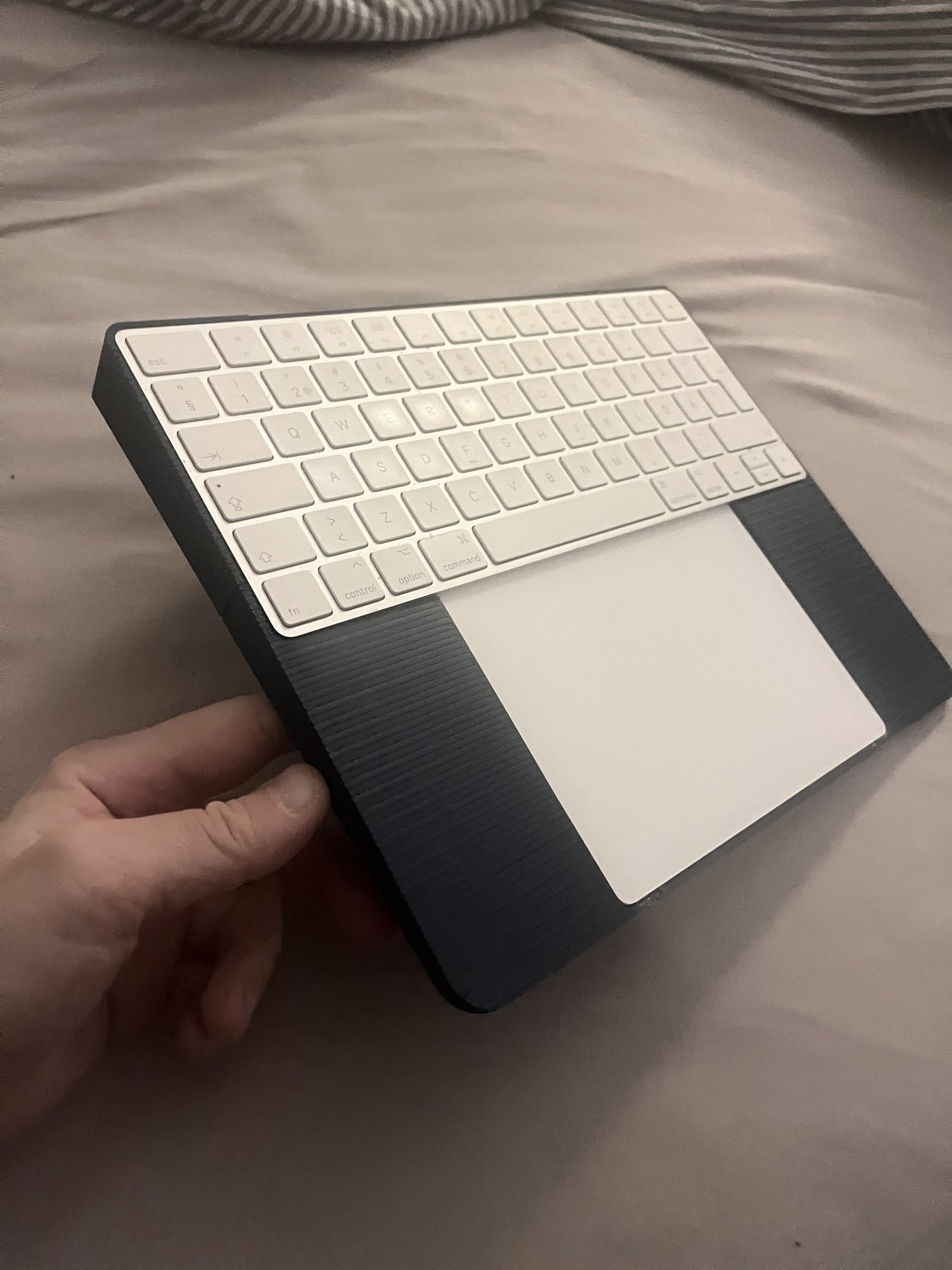

Hello! I have a magic trackpad and keyboard in a holder that mimics a Macbook layout. So i can use it while laying in the sofa.
But the accidental inputs from the trackpad while typing is driving me crazy. I guess the accidental input control for the magic trackpad is not the same as with a built in trackpad in a macbook.
Ive been googling for the last weeks without finding anything. Been looking into Bettertouchtools, keyboard maestro etc.
It feels like it should some how be possible to create some script/app etc that ignores the trackpad for 1 second after the keyboard is pressed.
When I google this problem it seems like im not the only one with accidental input. I think also since the modern trackpads is so large.

wressus
macrumors member
Nov 2, 2010
68
2
I’ve tried it now and it’s working in Sonoma 14.3 MBA M1.
I’ve placed the binary in /usr/local/bin/
Code:
sudo mkdir -p /usr/local/bin/
Code:
sudo cp ~/Downloads/TouchGuard /usr/local/bin/TouchGuard
make it executable
Code:
sudo chmod +x /usr/local/bin/TouchGuard
then run it once
Code:
sudo TouchGuard -time 0.2
stop the run (control+C) and give Terminal Accessibility permission (System Settings – Privacy & Security – Accessibility)
Now open Terminal and run it again
Code:
It should work.
Tried to get it running
wressus
macrumors member
Nov 2, 2010
68
2
Also, I tried it again now. But even if I set it to 0.5 seconds I cant seem to get it to work. If I keep pushing a button on the keyboard I can still move the pointer. The pointer should at least jump or stop while continuously tapping a button on the keyboard and moving the pointer at the same time. Maybe its only configured to work on the built in trackpad?
