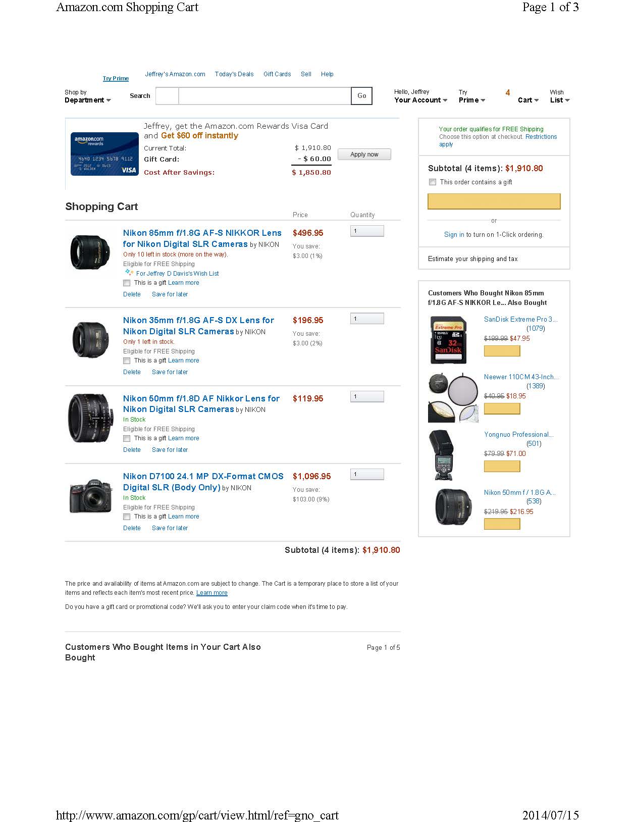

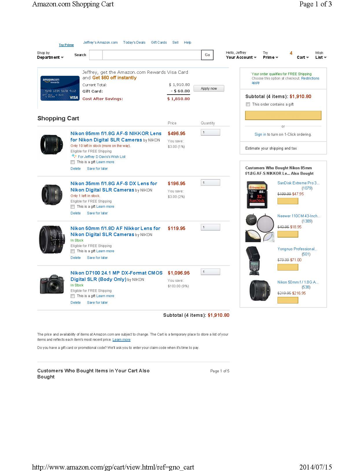

A decent amount of value for 2 grand here and you'd do pretty well in low light. No zoom though unless you want to pay $2k for a f/2.8.
One of the BEST VALUE low light setups for the money would be the Nikon D3300 and 35mm f/1.8 lens. Of course you don't get bragging rights with such a setup and you will have to figure out what to do with the money you save. Yes you can do better with a D800 and the f/1.4 lens.
