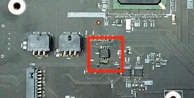

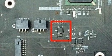

you will find it here (U8700):
mostly:
4,1 (2009) MX25L3205(A)
5,1 (2010) MX25L3205D/MX25L3208D
5,1 (2012) MX25L3206E

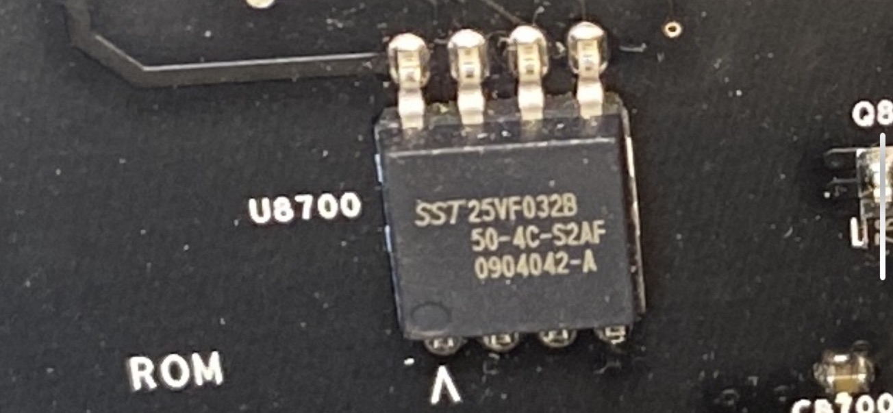

Which one of those 3 is this?

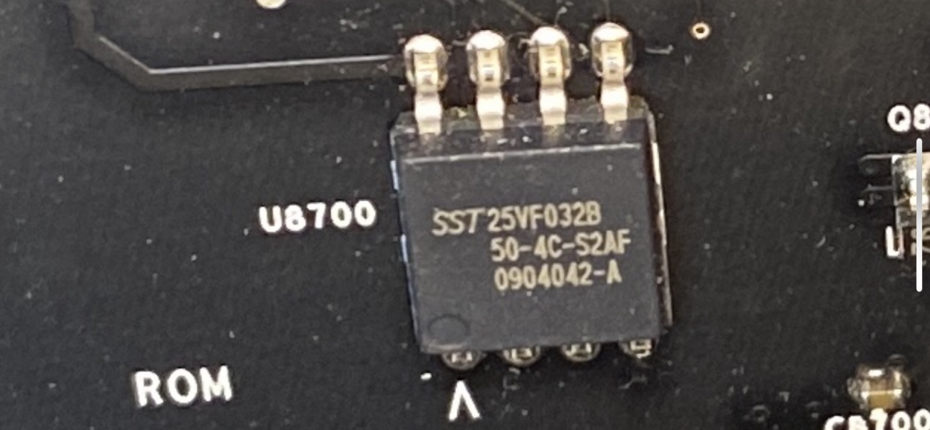

SST25VF032B is the most common used SPI flash for early-2009 Mac Pros from factory. Almost all early-2009 Mac Pros with build date within 2009 have it. ROMTool/flashrom identifies this SPI flash memory model automatically.
The second-source/alternate SPI flash memory for early-2009 Mac Pros is the MX25L3206E.
Reactions: toke lahti
