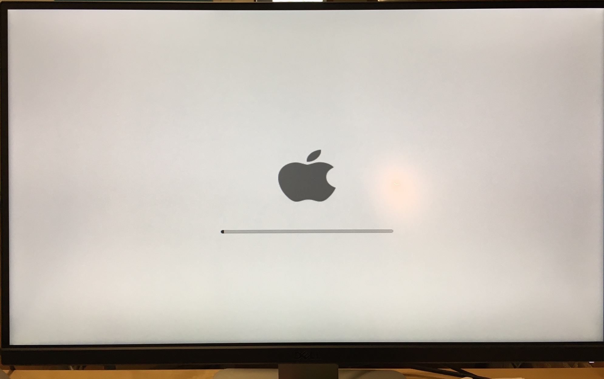

Hey, I switched to a DP-DP cable and am having the same squashed boot screen issue. I don't understand what is going on here. How could I fix this? I've attached a pic of what it looks like.

Tbh if the issue is only on the boot screen I suspect that the culprit is something as ridiculously simple as the EFI firmware not having a 1440p resolution mode for the bootscreen (as it was not a common resolution when the cMP was first around) and as such it's defaulting to a resolution with a different aspect ratio, which will cause it to look too wide or too narrow.
That's my guess anyway.
I can confirm that 1600p works just fine on the GTX 680 ME.
I think your theory might be correct!
Ok, PRAM reset didn't do anything. Is there a way to update the EFI firmware to add a new resolution?
