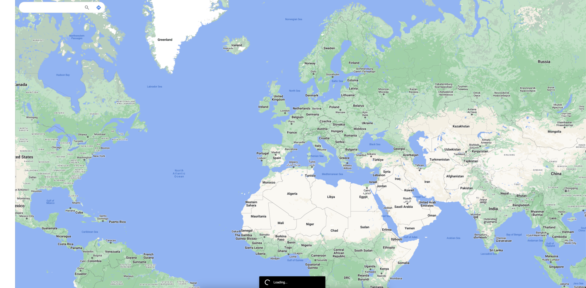

Hello, sorry if this don't belong here.
I have problem with google maps website on safari. When I go on google maps website, map itself shows but not any functions like street view, satellite, also I can't search places. I can only see map itself and can zoom in and out. There is loading icon at bottom of site but it's just rotating infinitely.
Would be glad for any help. It's started doing two os updates ago. When I constantly reload site, sometimes it's just instantly fix and everything works, that's why I don't think it have anything to do with internet or ram.

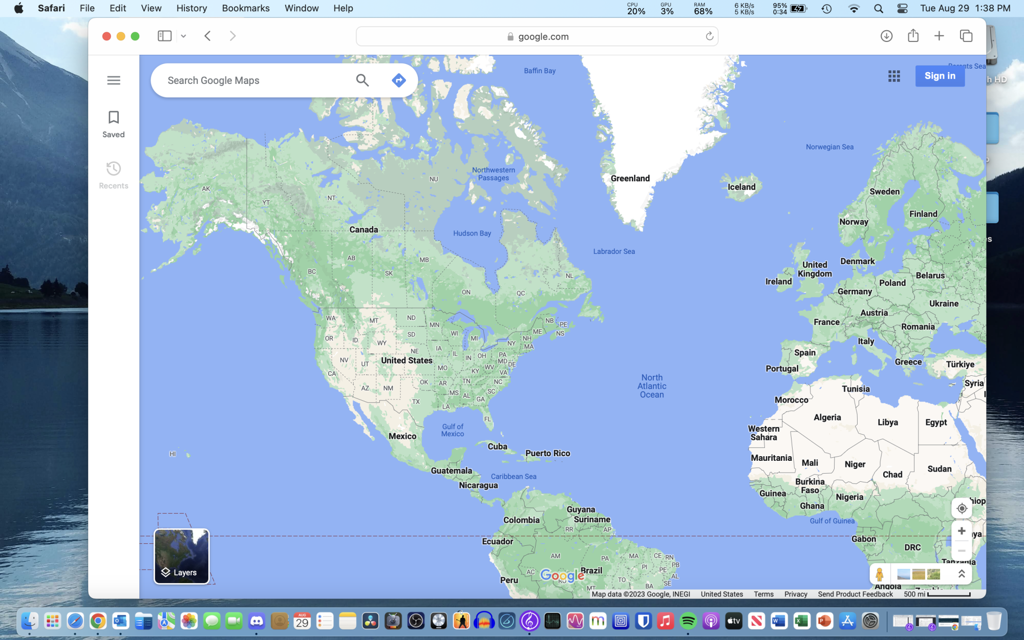

What OS and Safari version are you using? Mine seems to work just fine:
I'm running Safari 16.6 and macOS Ventura 13.5.1
Same, everything is updated. but have this problem for like 4months. I can live with it, if I constantly refresh site then its just magically fix itself, but its annoying when you want to check something a you must refreshing for it few min. Somedays it just load instantly. that's why it is so weird. I have 32gb Ram, 800Mbps internet speed, have max 10tabs open. And don't run anything else in background.

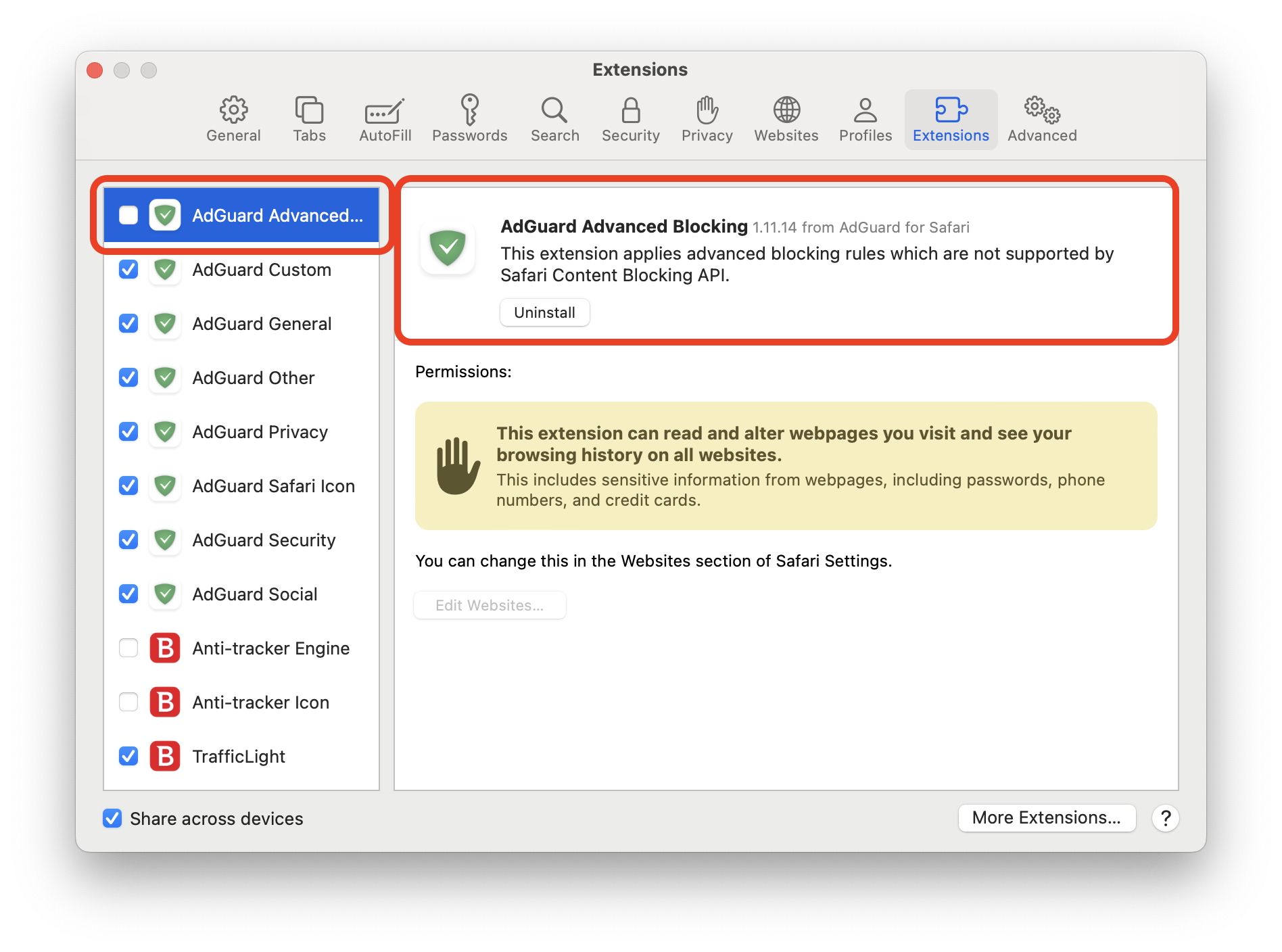

I was using Adblock with name AdGuard a when I deleted it and installed different one, google maps started load instantly.
You're right, thank you!
I also have AdGuard, and that seems to be the problem. I previously only tried disabling AdGuard on www.google.com/maps alone, and that never helped. But this time I decided to try disabling the specific AdGuard Advanced Blocking extension, and that solved the problem!
I tested this many times, and each time I enabled this extension, Google Maps stopped working. Each time I disabled it, Google Maps worked again.
It looks like you can keep the rest of AdGuard's extensions running. The culprit seems to be only this AdGuard Advanced Blocking extension. (see screenshot)
