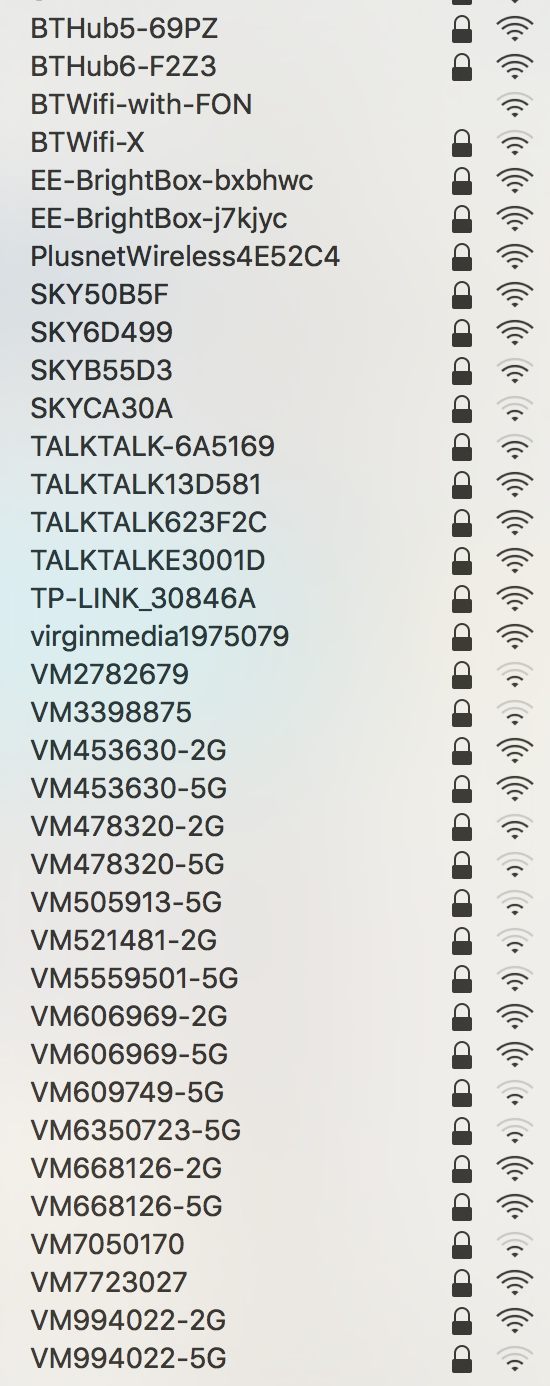

(I have 500+ ft to the next nearest house and only see a few SSIDs.)
That would be my dream. My current network neighbourhood (and it's pretty good at the moment):-
