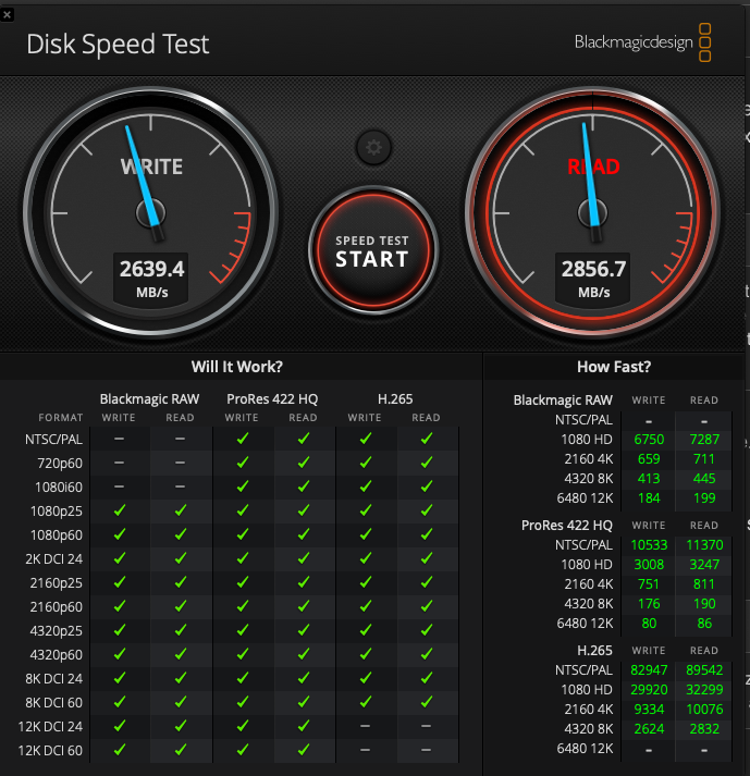

This card: https://www.amazon.com/dp/B0D47B2W75
Not true PXL but it's faking it somehow.
The Amazon page says it’s using a PLX 8747. It would have to be using something like that - your numbers would be impossible otherwise; there’s no way to ‘fake’ them. The reviews all seem positive, albeit with some grousing about fitting the heatsink.
The drive itself should be capable of 2-3x those speeds, but perhaps the card can only deliver that when using RAID arrangements.
The NVMe is PCIe gen 4 but the PCIe bridge of the PCIe card is only PCI gen 3.
You need a PCIe gen 4 bridge to get PCIe gen 4 speed from the NVMe in a PCIe gen 3 or gen 2 Mac.
for example, the HighPoint SSD7505 has a PEX88048 PCIe gen 4 bridge.
https://forums.macrumors.com/threads/pcie-ssds-nvme-ahci.2146725/post-29483973
Or like you said, a software RAID could be created to fill the bandwidth of the PCIe gen 2 slot from a single file system.
