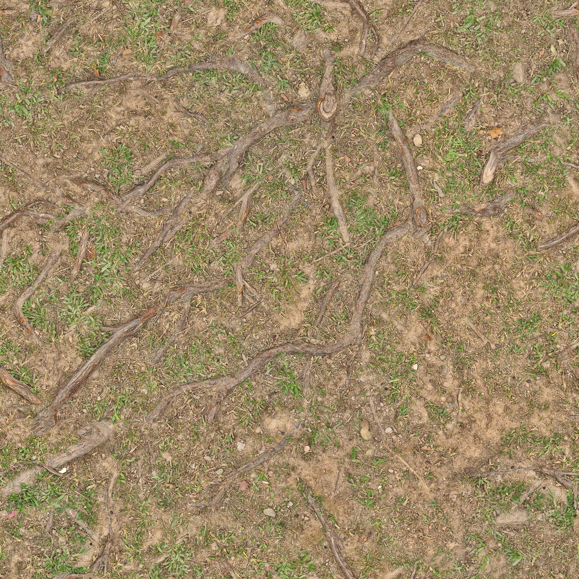

Although I really like Affinity Photo, I still prefer Adobe Photoshop (not Elements) for image editing. I think the main cause is, that I use it for so many years and I rarely find the time to get more comfortable with Affinity Photo. I can recommend all Affinity apps, they´re the tools, I´d definitely use on a new Mac. If you´re planning to buy Affinity Photo, there will soon be a new major version on the 9th of November 2022. They´ll probably have introduction pricing and if not, wait for Black Friday at the end of the month.
I think that's not necessary, as image editing should be powerful enough to get the edit done on a single layer. As there is no absolut right way of doing things, it finally depends on your opinions and preferences of what is a good result. I did 3 fast edits. None is perfect but shows different directions of what could be done.

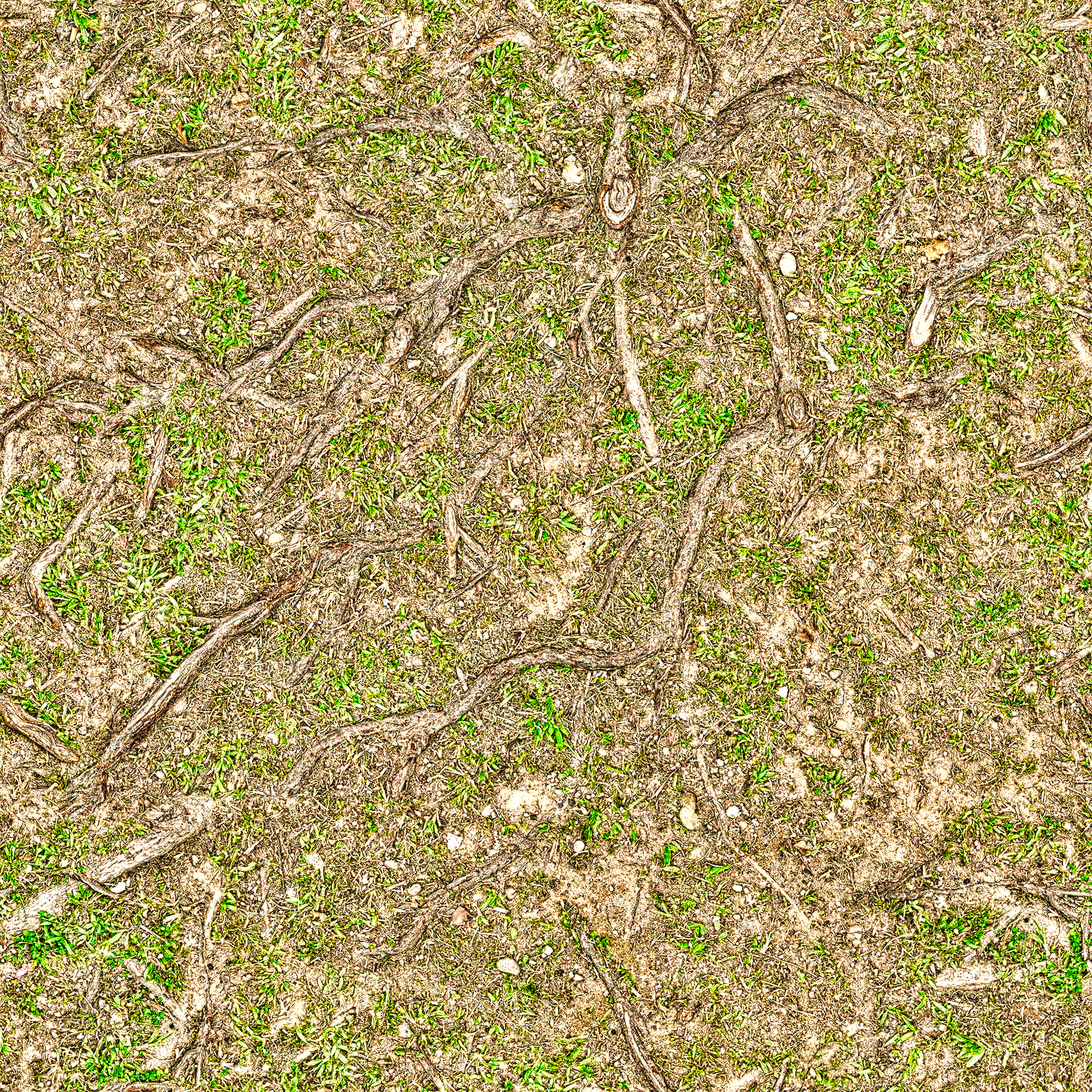

You could use Gimp or Krita for your editing. Another free option is NIK Collection 1.2.1. I´ve attached a 20 seconds edit of your image with NIK Viveza.

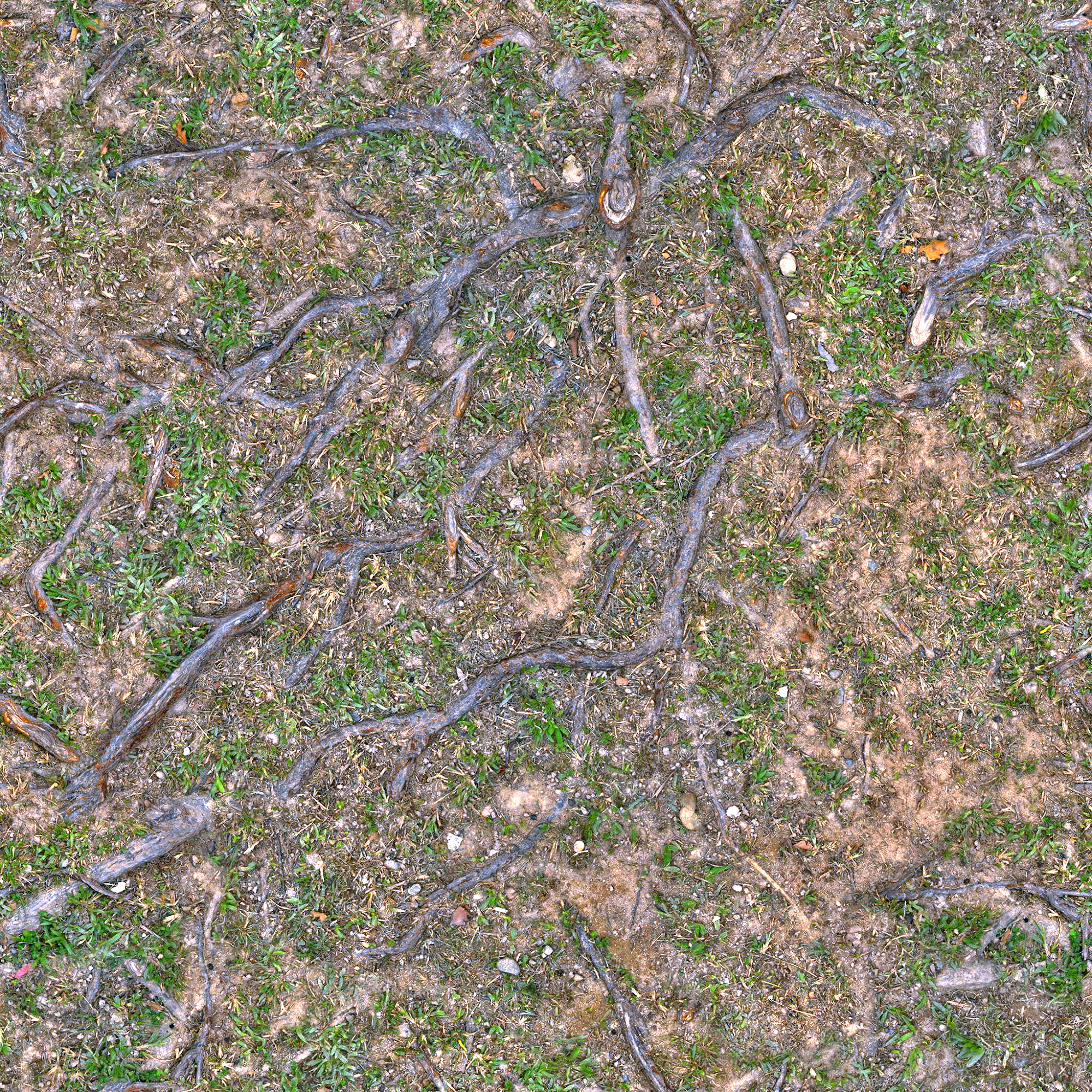

Here another example of a one minute edit in a software called Luminar Neo that is a bit over edited in my opinion, but it goes slightly more in the direction of what people nowadays do with Instagram filters:

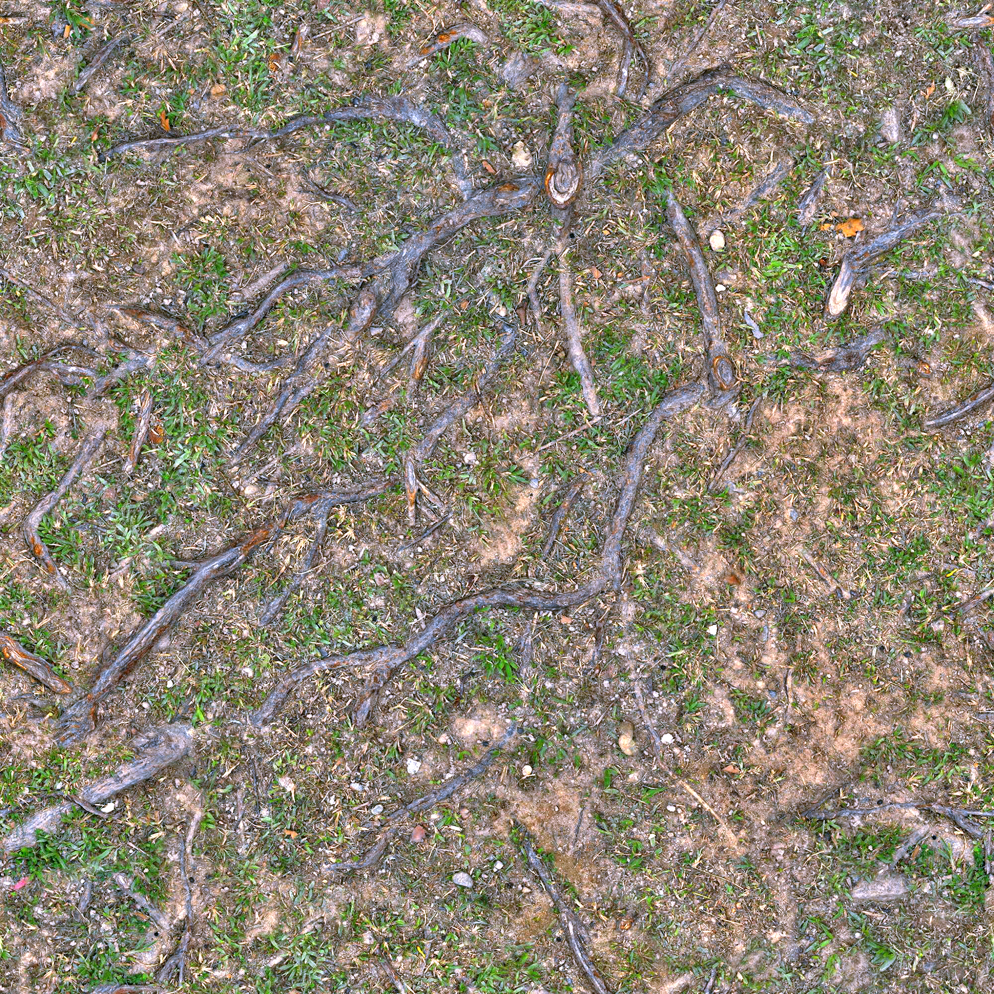

Finally an example of mainly auto color, contrast, tonality and increased clarity in Affinity Photo:

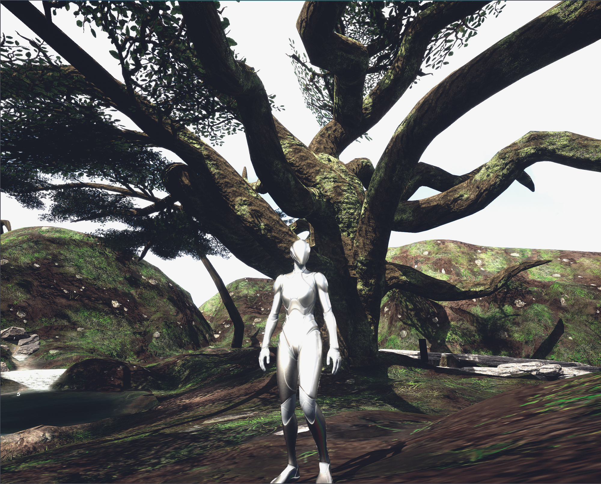

Been working on a big tree:
Rough image​
A Nature Procedural Pack, found in the Epic Market Place that includes a tree toot spline and a tree branch spline. It's pretty incredible. The main trunks of the tree are actually highly flexible tree roots. The flexible branches are attached to these.

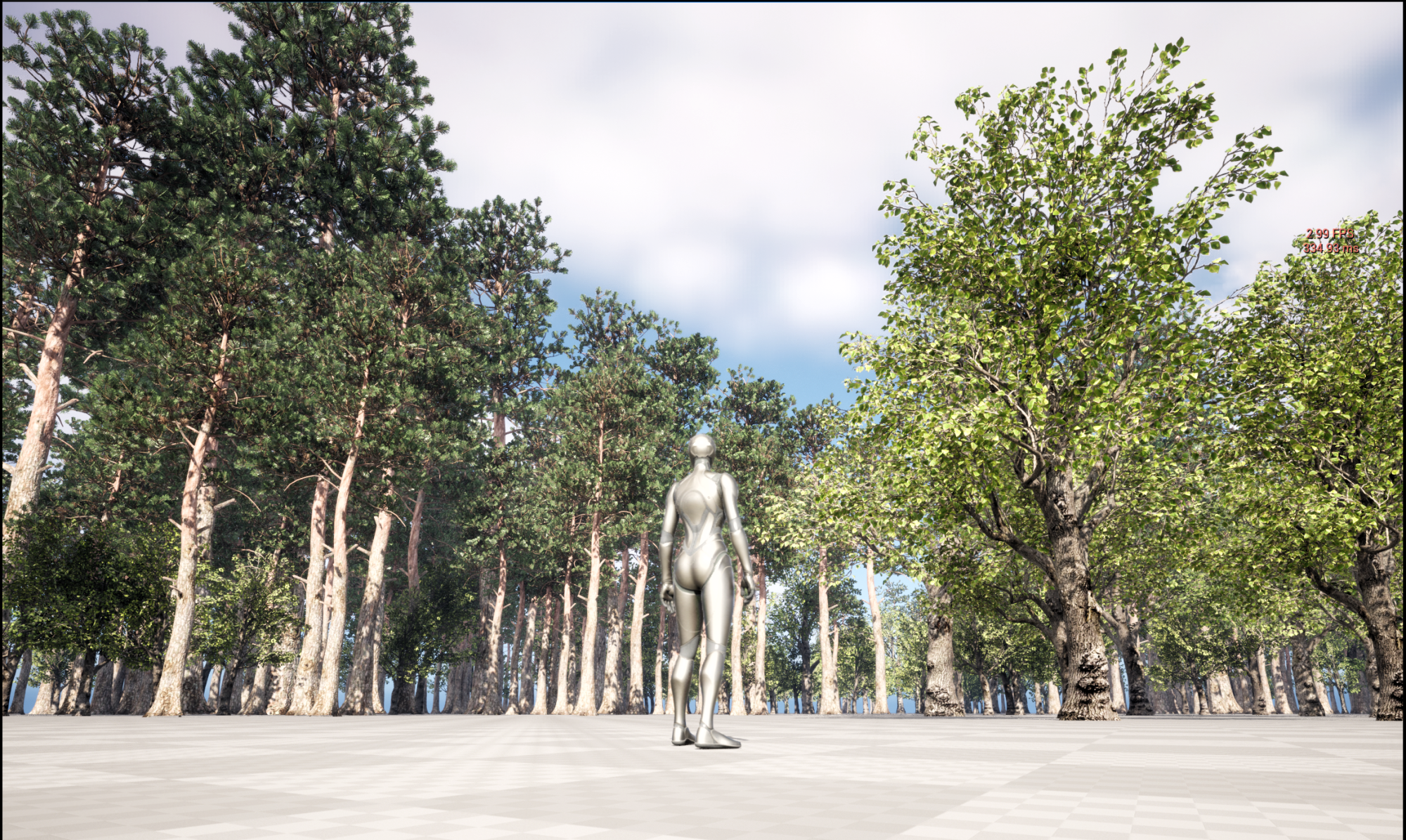

On an exciting note, I had a procedural foliage generator project from the Market Place and saw another that looked amazing, yet I know squat about procedural forests, but then I started in on this tutorial to catch up.
https://docs.unrealengine.com/5.0/en-US/procedural-foliage-tool-in-unreal-engine/
Created following along with the tutorial​
Note: 2 types of trees both on the same Foliage generator volume, but they actually clump in their own predominant groups, instead of mixing with each other evenly and equally...
This is simply amazing for several reasons:
  • You can slap down a realistic forest with minimal effort.
  • Not only that, it looks realistic- it mimics growth of trees as far as how trees would naturally spread, with settings for everything.
  • And for the stuff that is in the wrong spot for whatever the reason, those items can be erased.

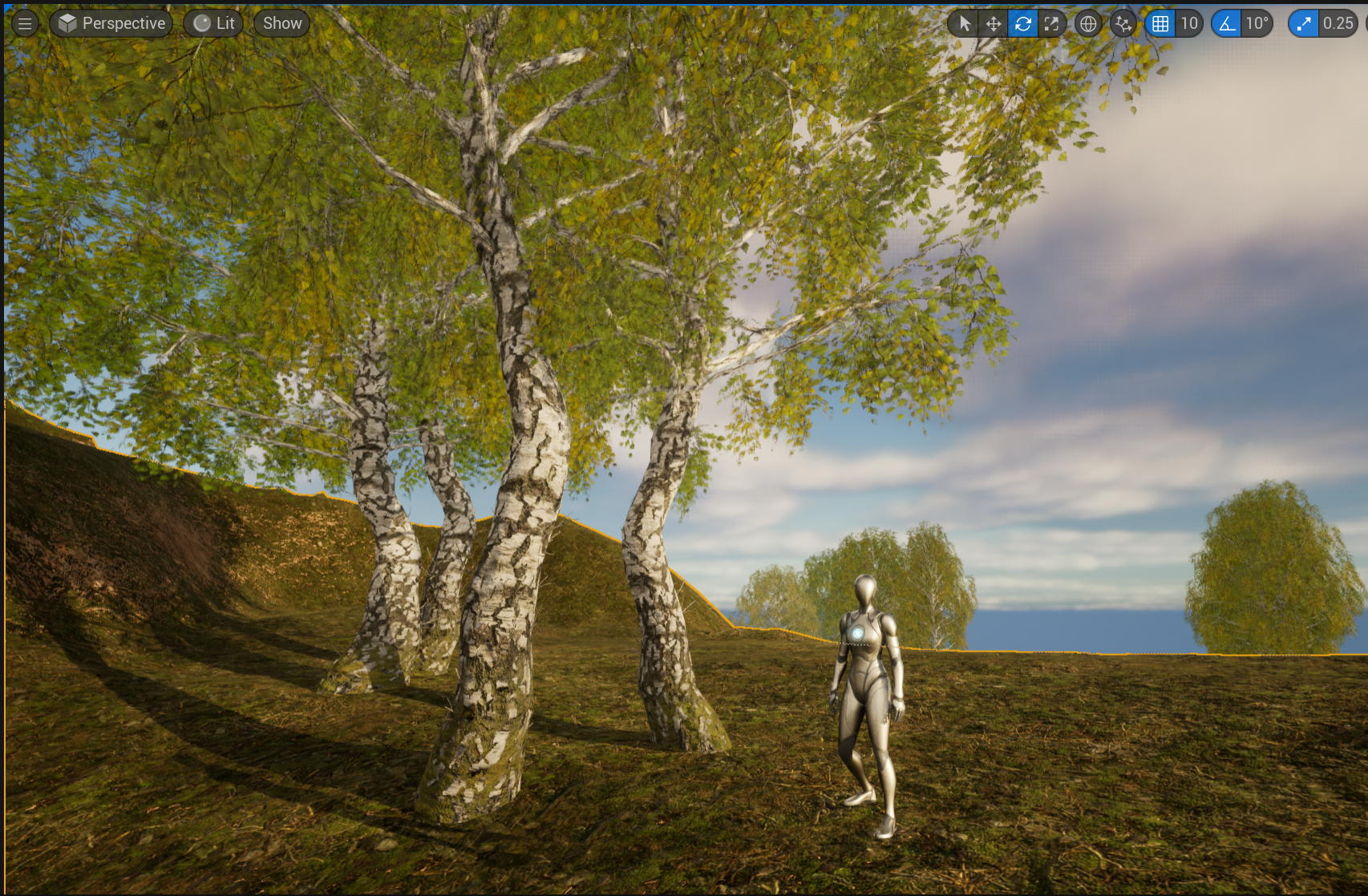

OK, I seem to have gotten though my Runtime Virtual Texture crisis, tomorrow I'll configure another rock and some trees, then I'll be convinced I'm beyond the issue . I found my big Oak trophy tree in a project at Epic that was inexpensive. Playing around with a practice run of applying some instanced Aspen Trees. In game, all the leaves are waving. :D
This is just one tree, rotated and scaled to different sizes. When I start applying them for real there will probably7-10 different trees, but you can see what rotation and scaling does to make it look a bit different.

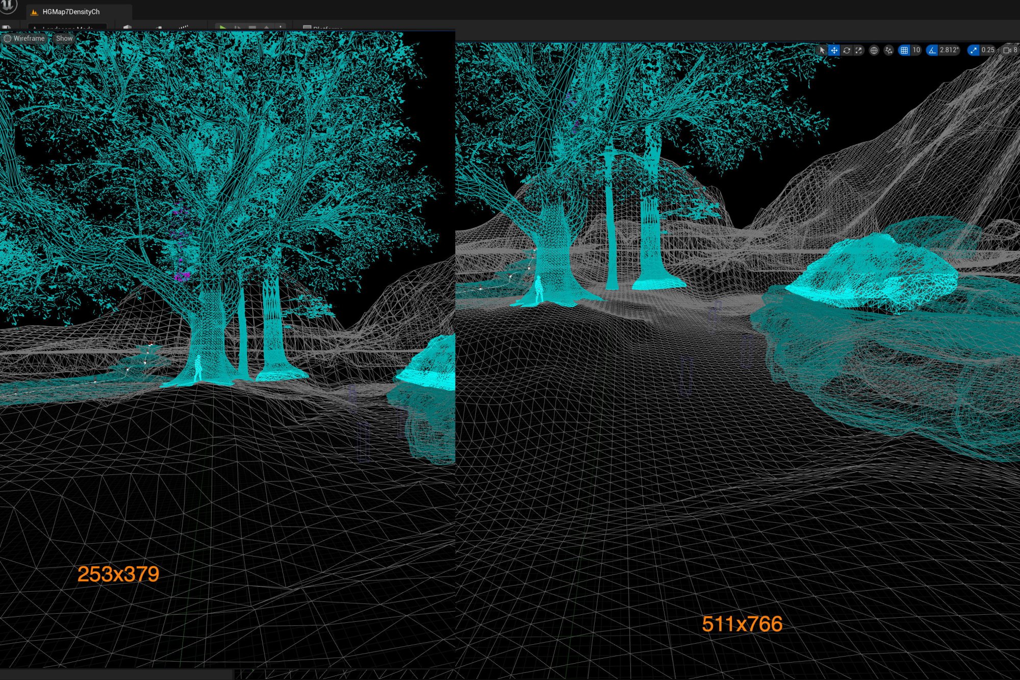

Now this was done in UE4 and UE5 handles LODs (how detail is removed from models as camera distance from an asset becomes greater, but I increased the density of the landscape close up and I'm seeing more smoother detail, and virtually no drop in FPS when looking at it in runtime.
