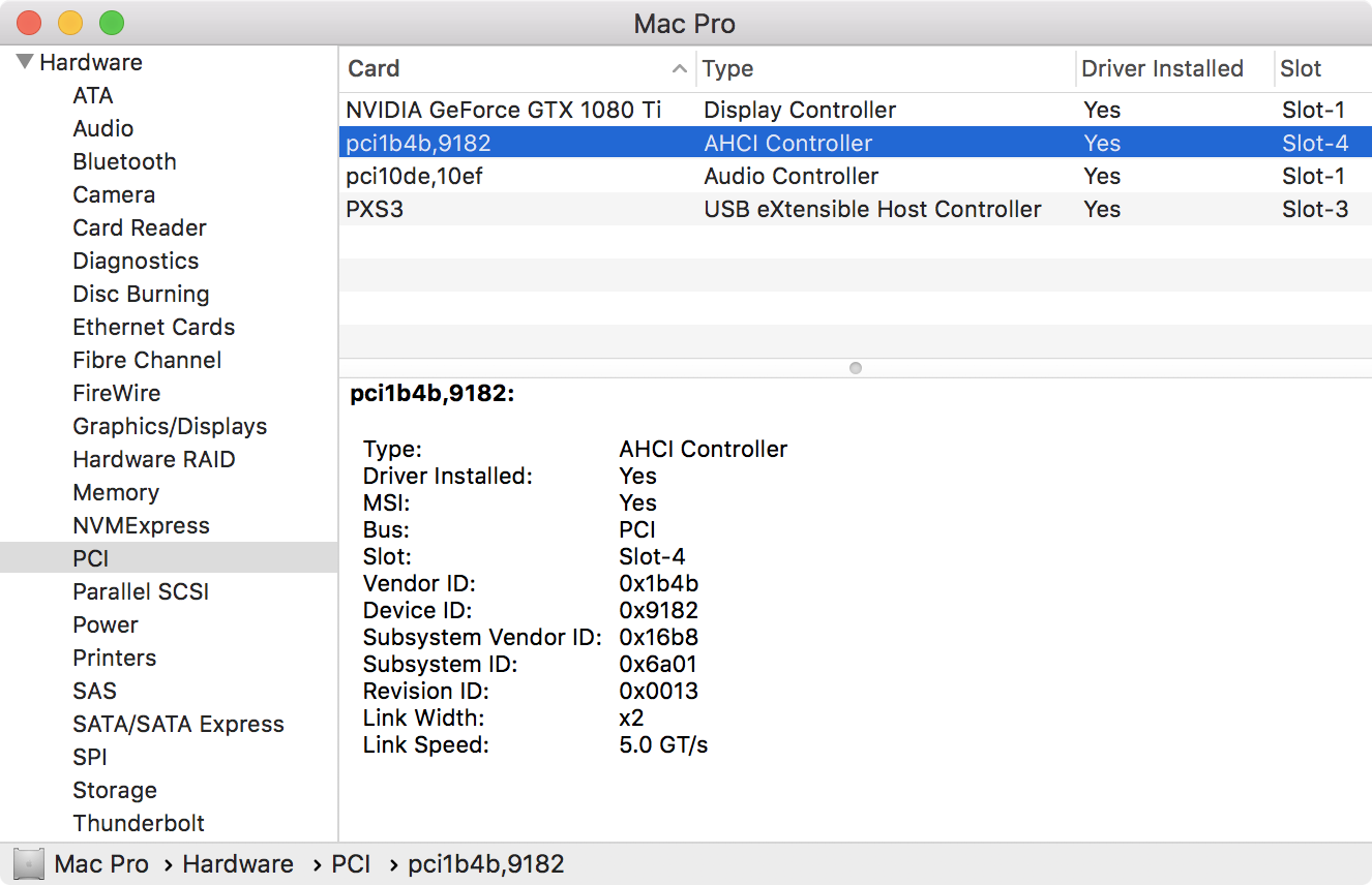

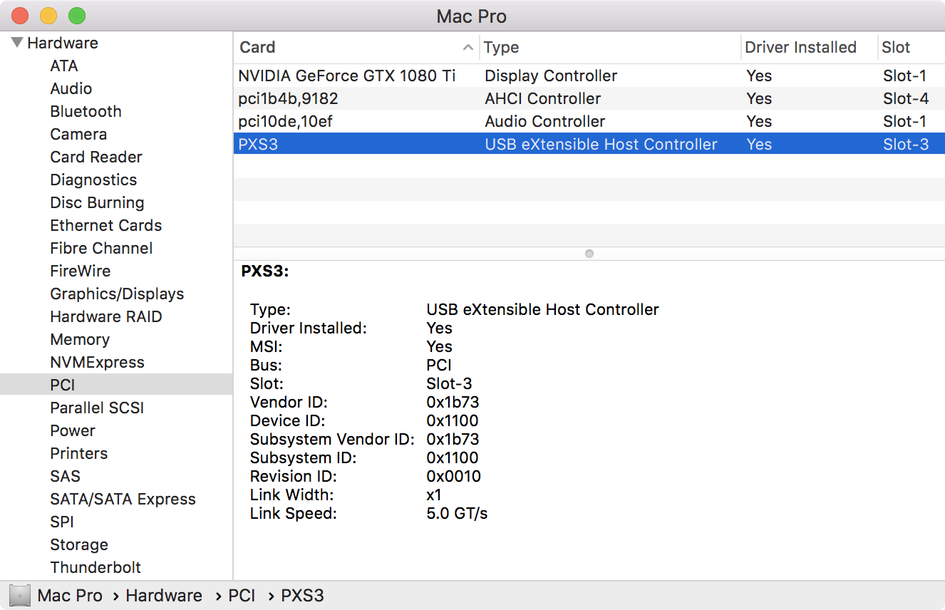

[doublepost=1525814371][/doublepost]e.g. My KT-4004 USB 3.0 card is a PCIe 2.0 x1 card. Therefore, it negotiate at PCIe 2.0 x1 in a slot 2 (x16 slot), but can also negotiate at 5GT/s x1 in slot 3 (x4 slot).
And my Tempo SSD is a PCIe 2.0 x2 card. It negotiate at PCIe 2.0 x2 in slot 2. But also negotiated at 5GT/s x2 in slot 4.
None of these card will further fallback to lower link width just because not installed in a x16 slot.
