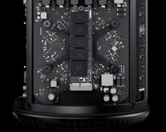

You traced 164 pins and followed the circuits? Through a multilayer PCB ? I'm sorry, that is total BS.
I have repaired damage to MANY GPUs in last 7 years, the traces are barely visible, then vanish from top layer to connect through an intermediate layer and show up 3 inches away from start at a component on backside. And it is in fact the backside that you have pulled this claim from.
Without multilayer schematics and hours tracing circuits there is 100% NO WAY to make any such claim .
I call "shenanigans"
In past Apple changed just a couple pins on AGP connector for use with ADC display and people have had to tape pins 3 & 8 on cards for G4s ever since.
I suggest you recant, or admit it's option 1 or 2.
Or explain how your X-ray vision allows you to see the inner PCB layers from jpegs.
To be clear, I only looked at the general direction of where large groups of pins went and to what circuits they connected to. For example the first few pins go to a series of capacitors, which is consistent given that those are power pins, and the data pins travel to the processing core.
I didn't cross my mind that Apple would mess the PCIe 3.0 standard at all, but I will admit that we can't be 100% certain that everything is kosher just by seeing the back of the card, or even seeing the whole card if Apple messed with the pins before.
Does anyone know if Apple has ever messed with the PCIe standard?

... ever messed with the PCIe standard?
I doubt that they'd do that. Rearrange them perhaps, and add pins for their own purposes, but the PCIe signals, levels etc. should all be the same.
This connection between the new Mac Pro GPUs and the bottom circuit board does not look in any way like a standard PCIe slot to me (the black thing is mounted to the board - it's not like the board has a card edge inserted into a slot). Which is really not that surprising since Apple's design requires additional connections for the display port output and PEG power connections which a PCIe card slot does not facilitate. (And the GPU is piggy-backing the SSD). They most likely opted for a custom integrated connector to handle all of this.
BTW, PCIe bus interconnects can be implemented without using standard PCI Express card slots. This is done in Mac Books, iMacs, the Mac Mini, and millions of other laptops and computers that lack expansion slots.
