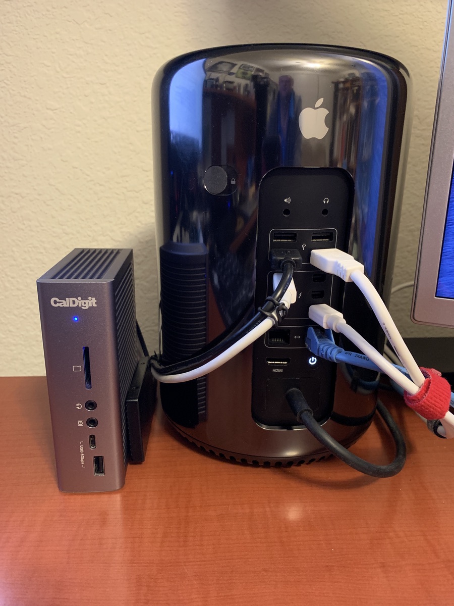

I stumbled upon a great way to add USB-C ports to my 2013 Mac Pro. In summary - buy a CalDigit TS3 Dock !!! I got the CalDigit TS3 as a dock for my 2016 MacBook Pro which connects via Thunderbolt 3 cable (not USB-C as they are different cables). I purchased an Apple Thunderbolt 3 to Thunderbolt 2 adapter so that I could use target disk mode to transfer all my data from the MacBook Pro over to the Mac Pro (which worked great). By the way Apple's adapter is bi-directional, meaning you can use the adapter to go either way (TB2 to TB3 or vice-versa). When I was done using the adapter for file transfer I thought, hmm I wonder what would happen if I plugged the CalDigit into the Mac Pro through the adapter. The CalDigit TS3 is a Thunderbolt 3 Dock so I wasn't sure it would work at all or maybe act squirrely. Well I can report that it works perfect connected to the 2013 Mac Pro using the genuine Apple Thunderbolt adapter and a genuine Apple Thunderbolt 2 cable. The CalDigit TS3 has lots of USB-C ports and all of them work great! I can plug in my iPadPro using the USB-C cable and it works great. My SanDisk USB-C SSD works great too. Now do keep in mind I am obviously getting the lowest common denominator bandwidth (Thunderbolt 2). BUT - it's much faster than connecting these devices over the USB3 ports built into the Mac Pro. So in summary, I highly recommend the CalDigit TS3 as a fantastic companion to the 2013 Mac Pro. What a great way to add the more modern USB-C ports to this older model computer!!
Just to clarify - this is a "TS3 Plus" dock, not TS3 - the TS3 Plus has the memory card slot on the front and the TS3 does not (among other differences).
-bob
You actually don't even need that. There are a lot of USB-A to USB-C cables out there for around $5. I use them all the time to connect USB-C accessories with my 2009.
You'll be capped at the speed of the USB port, USB3 is 5 gbps, which is the same speed as what that dock provides.
