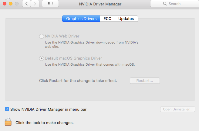

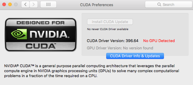

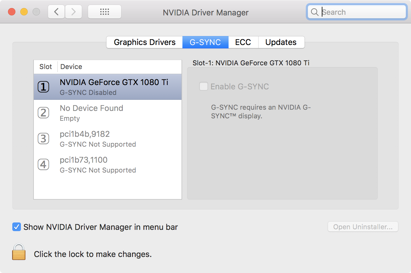

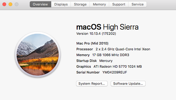

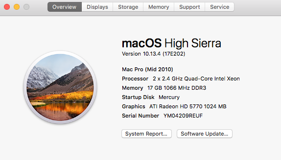

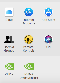

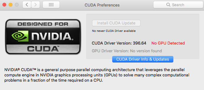

So this is what I'm looking at now without my titan x installed. I think that g-sync option you have is different between the cards. Not sure if i mentioned this ward is not flashed but I believe everyone else is in the same position. I'm going to try this whole remote thing with the iphone and see if I can access the settings once I install the Titan x. If i can't get this to work on High Sierra Im going to wipe this drive and try with el capitan. Let me know if you guys think I'm missing anything.
this is my driver: WebDriver-387.10.10.10.30.107
this is my cuda driver: cudadriver_396.64_macos
If anyone is in Brooklyn i'd be willing to offer a cash prize to get his thing working ;)

Did you setup remote control?
If yes, use that to check the following info, and see if there is anything can confirm the GTX TitanX is working.View attachment 763383View attachment 763384View attachment 763385View attachment 763386View attachment 763388
i posted my specs beneath this a bit. do you think im missing anything?

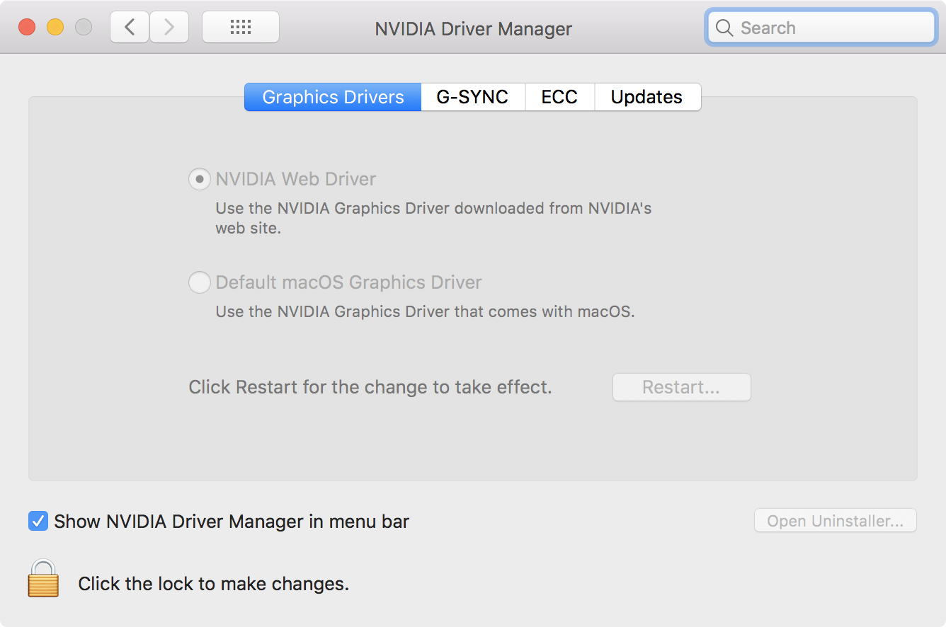

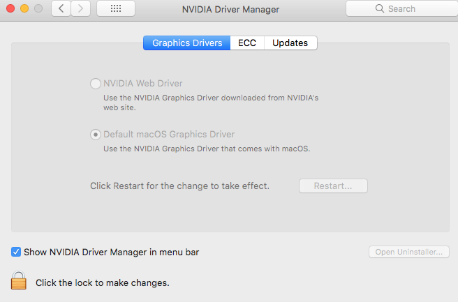

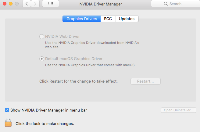

This is the problem.

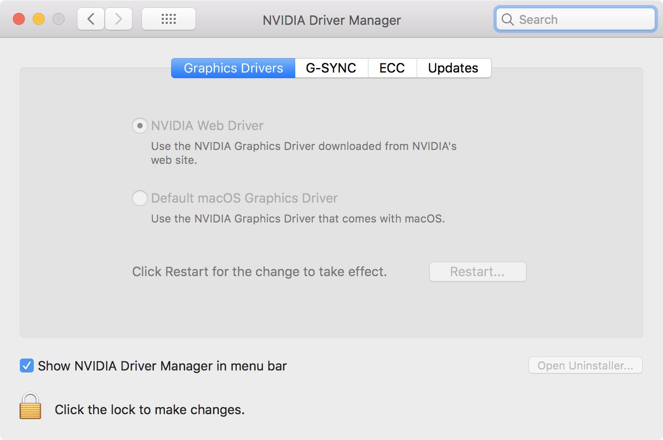

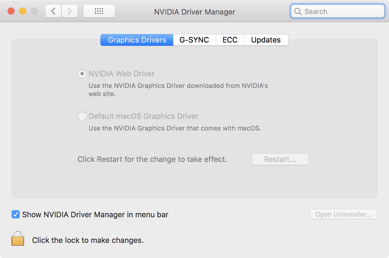

Unlock it, and select the Nvidia web driver. Should looks like this.
Yeah I have unlocked it and changed the setting to the web driver, at that point the problem im having is that the computer wants to instantly restart without the Titan X in the slot. Im going to try and hit "not now" select the web driver and then shutdown to install the card. Then if that doesn't work ill have to do the chrome remote thing. its got a lot of language that is confusing me on using the iphone to remote in.
again thank you for all your help. hoping this thing works out.

Don't worry about that, you SHOULD restart without the GTX TitanX. And just check if the web driver is correctly selected.
And then you can shut it down, and swap the graphic card.
On the next start up, the GTX TitanX should work as expected.
Man, Mac is really bugging out. I've selected this and restarted 3x and it shows that the recommended mac OS and not the Web Driver I keep selecting...
With the 5770 still there, I recommend a PRAM reset first, then try again.
If still no go, then use terminal command to set it.

Yes, with the 5770 when I restart it looks like it defaults to the MacOs driver and not the web driver. How would I reset the PRAM and then select the web drivers.
PRAM reset
1) Shutdown the Mac
2) Hold Command + Option + P + R
3) press the power button to start the Mac
4) Keep hold that four keys until you hear the 4th start up chirm
The system will continue boot to desktop after you release the key, and try to select web driver again.
PRAM reset
1) Shutdown the Mac
thank you... about to try this now.
[doublepost=1527618093][/doublepost]Ok sweet, That made it so now I my web driver is selected. going to shitdown and install my little Titan Baby. hope it works.

Ok sweet, That made it so now my web driver is selected on the start up. going to shutdown and install my little Titan Baby. hope it works.

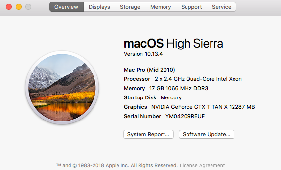

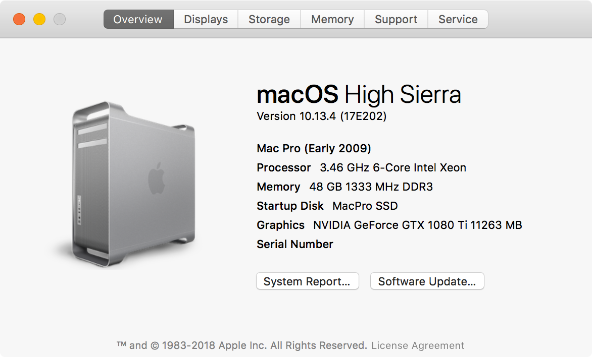

Dude. THANK YOU for your help. We now Have another successful TITAN X up and running in a mid 2010 Mac Pro Tower. Time to install the Adobe CC and get this mofo cranking on some exports.
