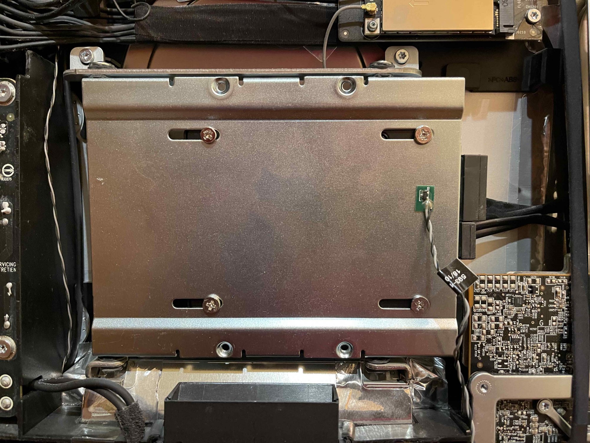

I have exactly that 27" 2009 iMac, and I've just (yesterday) completed the HDD to SSD swap, by the method detailed above. I had already upgraded it to Mojave using the Dosdude patcher as soon as I got hold of it, and am awaiting an extra 8GB RAM to complete the job.
Remember though, there is nowhere on the SSD to connect the thermal sensor cable, so I first installed the free Macs Fan Control and set the hard drive fan to a constant 2000 rpm, otherwise the fan will run wild and loud all the time 😉

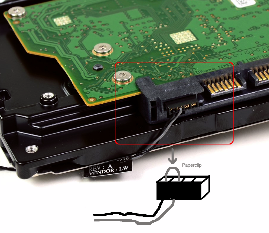

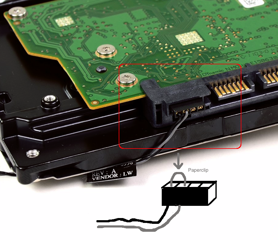

There might be a way to bridge the logicboard-located socket for the thermal-sensor cable e.g. with a piece of a paper-clip. Did this on either an early 2009 24" iMac or a mid-2010 21,5" iMac. (The longer I think about it, the more I believe it has been the latter ...) Too bad, I can't remember the details and couldn't find a note, posting or picture about that.
Don't know, if the 27" late-2009 allows such a fix too !?
Edit: added a picture ...

There might be a way to bridge the logicboard-located socket for the thermal-sensor cable e.g. with a piece of a paper-clip. Did this on my early 2009 24" iMac. Don't know, if the 27" late-2009 allows such a fix too ...

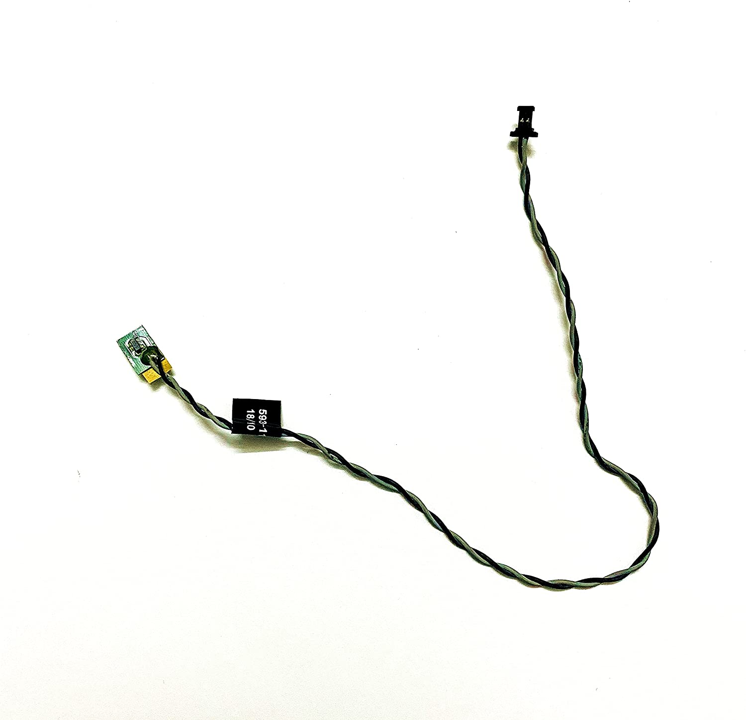

This iMac has a cable and connector onto the hard drive itself. It may be possible to connect a stick on sensor onto the SSD, but my Macs Fan Control solution works well.
Cheers 🙂

Found the source for the fix of the thermal-sensor-cable in my mid2010 21,5" iMac:
This is, what I posted here ... [ #15 ] - too bad, that I didn't take a picture of that fix.
But here is a link to the sources [ #14 & #1 ] (threads in german language) - but it's about the 27" 2009 iMac.
Here's a picture from that latter source, showing, how to brigde the in/out-cable of the sensor's plug: https://abload.de/image.php?img=dscn0521rpbd.jpg

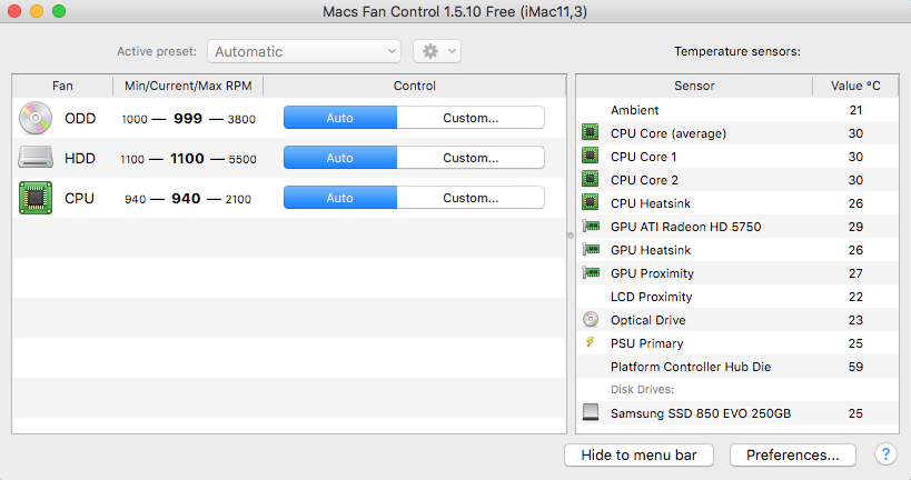

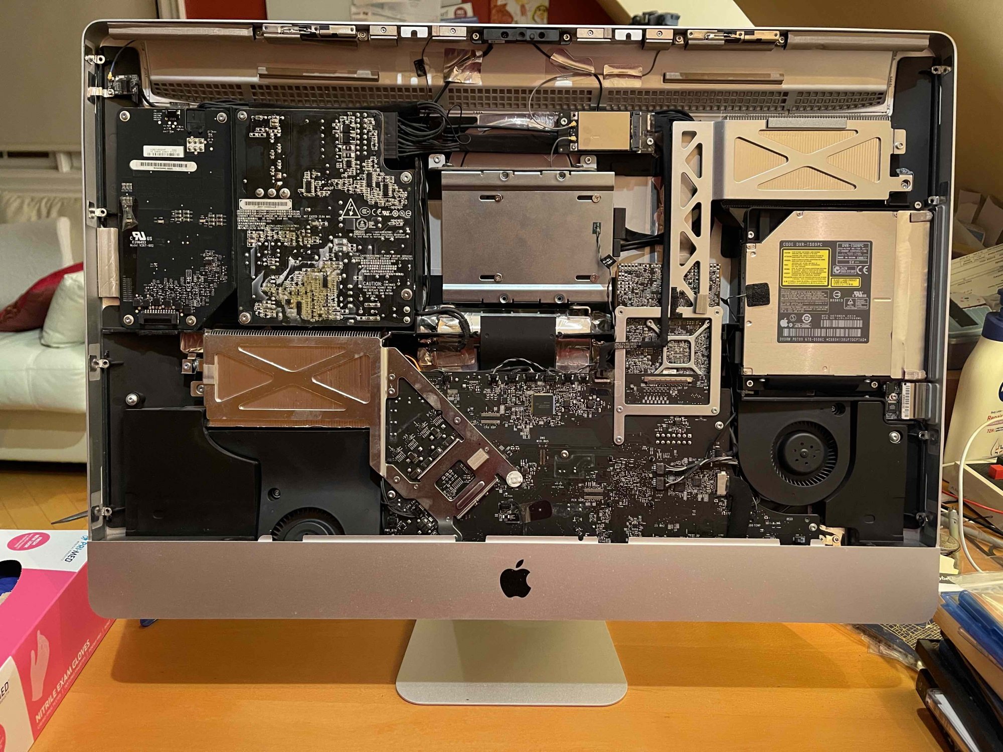

1. Don't trade it in. Apple offers exactly $0 for this model, and other companies don't offer much more.
2. High Sierra is fine as a minimum, but patched Mojave would be good too. (Too bad I can't easily use Mojave on my 2010.)
3. Don't rely on Macs Fan Control for your SSD installation, since it is a suboptimal solution. The better solution is to buy an optical drive temp sensor cable. It costs less than $10 US on Amazon. One end goes on the motherboard, and the other end you can stick anywhere you want (preferably on the SSD, although I just stuck mine on the bracket holding the SSD). It is essentially a sticker with a temp sensor on it.
Here is my 2010 iMac with everything installed. Note the last picture is MacsFanControl just to demonstrate it gets a temperature reading, but I don't actually need that software so after taking the screengrab I immediately uninstalled it.

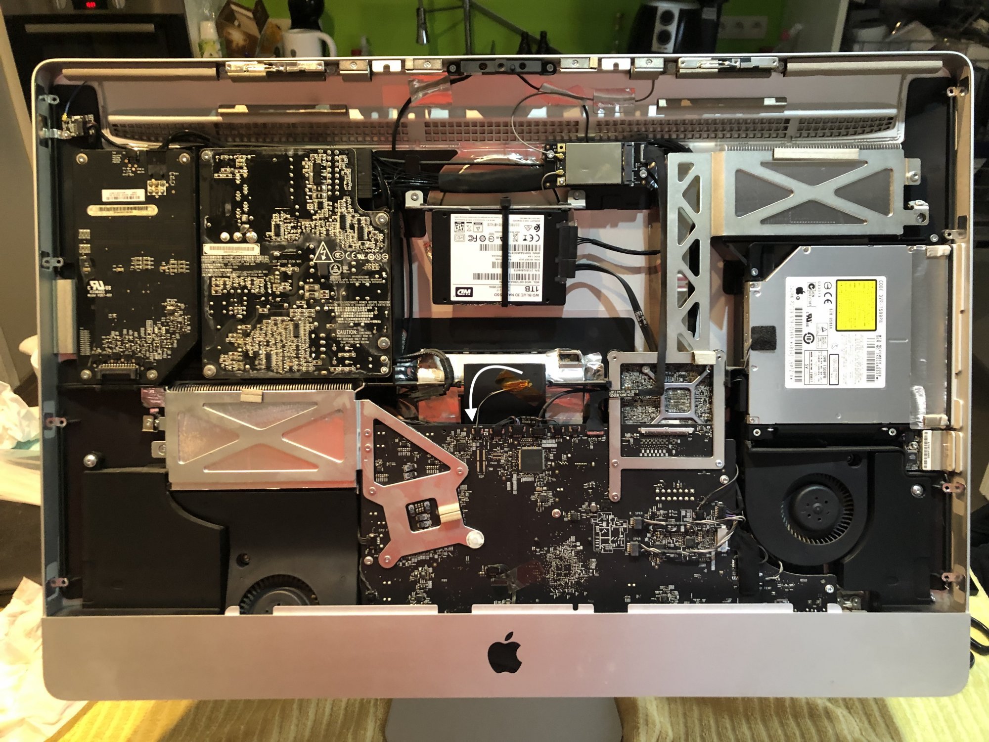

Was this a second hand computer? Or had it been repaired at some point?
Take a look at the arrow I added in the picture. IIRC, this is the connector for the HD temperature sensor, and it appears the cable has been cut, with the wires likely connected / soldered together (under the orange plastic). Shorting the circuit like this will disable the temp sensor in such a way that the fans don't ramp up. This is the cheap way to avoid using Macs Fan Control to control the fans. See the post from @bobesch above. I prefer my way with the optical drive temp sensor though, since you actually get a temperature reading.
