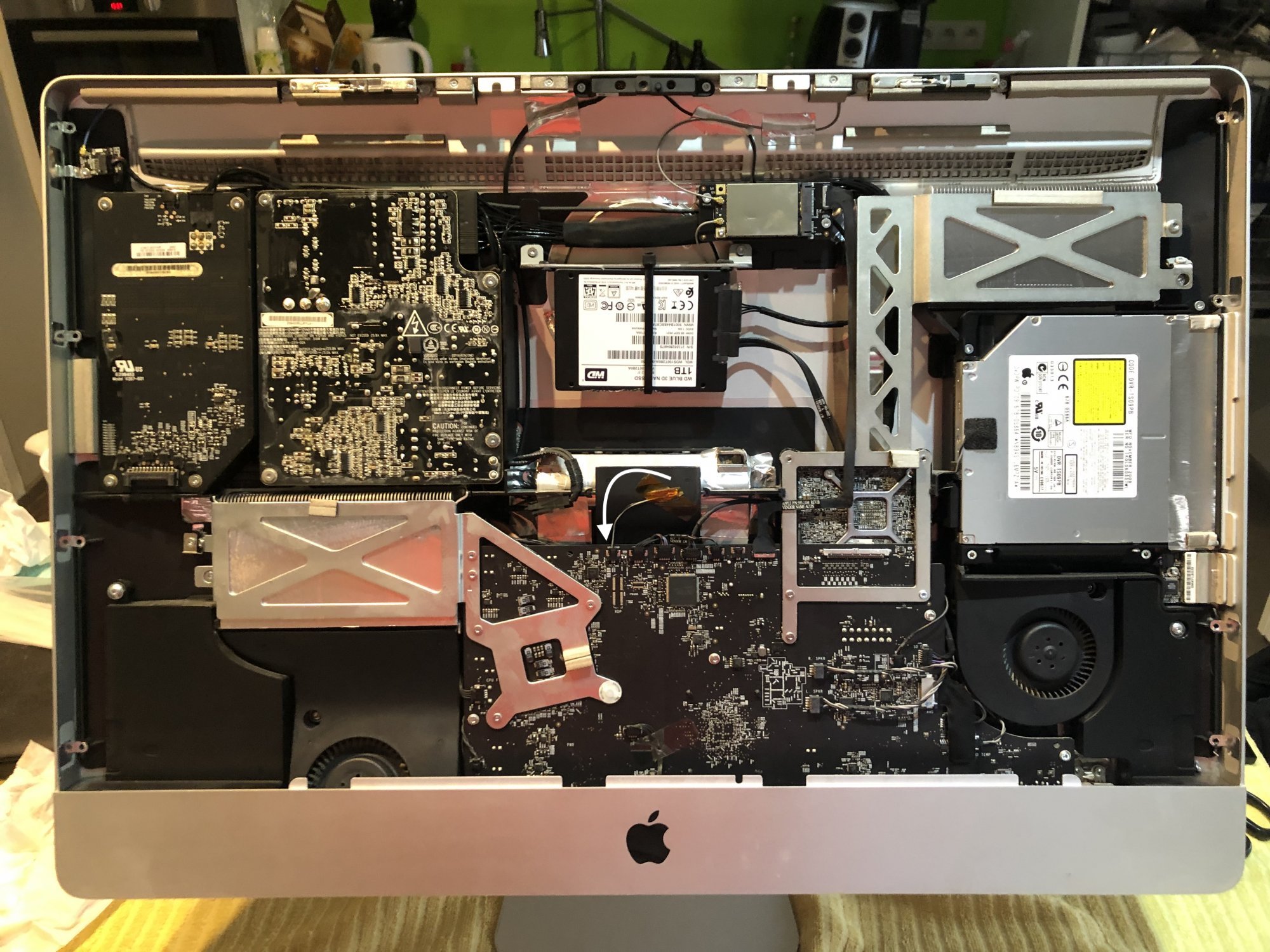

Take a look at the arrow I added in the picture. IIRC, this is the connector for the HD temperature sensor, and it appears the cable has been cut, with the wires likely connected / soldered together (under the orange plastic). Shorting the circuit like this will disable the temp sensor in such a way that the fans don't ramp up. This is the cheap way to avoid using Macs Fan Control to control the fans. See the post from @bobesch above. I prefer my way with the optical drive temp sensor though, since you actually get a temperature reading.
So currently my fans don’t work, is that what I understand?
What can I modify to remedy this..?
These are the various scenarios:
1) Remove HD temp cable. Fans run at maximum all the time. This is intolerably loud. The way around this is to run Macs Fan control.
2) Short HD temp cable. This is what you appear to have. This is fine. The computer just ignores the SSD and just runs the fans based on everything else, which is OK because the SSD won't get hot enough to matter anyway.
3) Replace HD temp cable with OWC's solution. This maintains all temp monitoring functionaity, but is way too expensive and is unnecessary. It also looks messy, but I'm sure that doesn't bother you, since it's hidden and also since you installed your SSD with a zip tie. ;)
4) Replace HD temp cable with optical drive temp cable, which is what I did. This costs under $10 and maintains the temp monitoring functionality, and has a clean look to it.

I think I prefer option 4 😉 will look for that.

Remember though, there is nowhere on the SSD to connect the thermal sensor cable, so I first installed the free Macs Fan Control and set the hard drive fan to a constant 2000 rpm, otherwise the fan will run wild and loud all the time ;)

The temperature-cable is not the problem - it has been fixed by the previous owner by shorting the cables, as @EugW already noticed. I'd leave that alone. Drive's temperature doesn't matter within this setting and you've already worked with the iMac/HDD without even noticing the mod.
