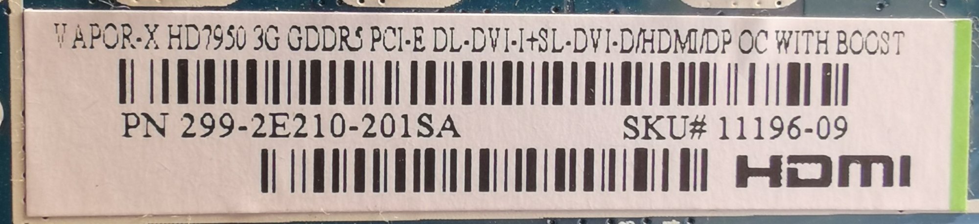

I was using OC+Big Sur successufuly until last week when I got a very good offer for my RX 580 8GB, and now I'm trying to create a .rom file to flash my HD7950, and I'm unable to create a good .rom file using the Bundle tool from netkas. Maybe my card is not compatible... It's a Saphire HD7950 Vapor X OC Boost, PN 299-2E210-201SA. I registered on Netkas but never received my confirmation e-mail.

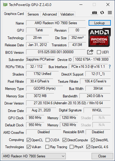

I tried to flash the card with this latest bios and it gives me a SUBSYTEM MISMATCH ERROR (using both ati flash 3.2 and 2 on windows 10). I tried flashing with Enricote's rom he sent me yesterday and I get THE VERSION OF VBIOS IS ALREADY INSTALLED message. I really want to flash this card, but I'm running out of time and patience.

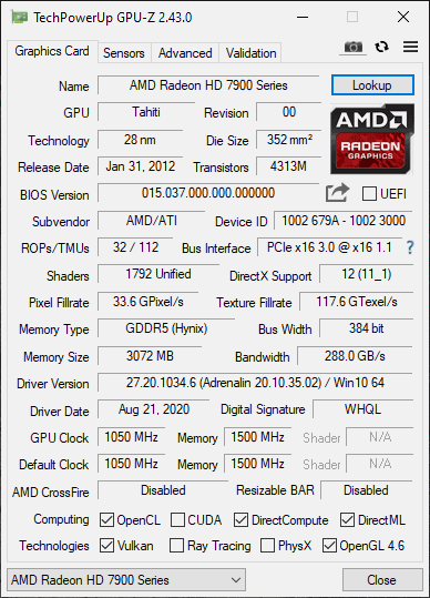

Funny...I just flashed the card with the latest bios from an hd7970 I found on TPU and the card is working flawlessly on windows 10, without a boot screen of course. What if I do all the process again using this rom as base?
I'm now in the process of installing Mojave on the original HDD so I can be 100% sure I'm doing the right thing. Windows runs on an SSD SATA on bay 1. My main OSX (BigSur) runs on an NVMe and I have not touched it since I started this process.
I'm starting to think the previous owner flashed the card with the wrong bios.

It's obviously a great idea to start with the best rom available.
So it doesn't matter if it's from a different model, as long as it's working correctly, I can flash it.
BTW, I just noticed the GPU and Memory clocks are much higher. Would this influence on the card performing correctly?
In a lot of cases various manufacturers use the very same ROM. And sometimes you can even use a ROM from a similar card (like some RX 470s can be flashed with RX 570 rom and will act like a 570). Similar things happened with 7950/7970 situation, however the performance benefits were negligible.
If it is for the same card but different manufacturer, there is a high chance of the rom to work correctly, especially if both products used the same reference design and the number and manufacturer of the memory chips is identical.
With higher clocking the card will be more prone to overheat so perhaps the fans will be more aggressive. On the other hand, it will be faster, that's why these clocks are set to higher values...
Excessive overheating will be clearly visible by showing artifacts on screen or even shutting down the computer entirely.
BTW if you want to play some more, try https://www.techpowerup.com/forums/threads/vbe7-vbios-editor-for-radeon-hd-7000-series-cards.189089/
Just make sure you edit a copy of the original ROM and only then convert it for Mac use.
I finally ran the script on Mojave and it worked, then flashed using the latest ATIflash 3.2 and now I have to boot screen. It's working great on Mojave and Big Sur (OC 7.3+Surplus) but I have no hardware acceleration (which I think it's normal for this gpu). The performance of this card is not so bad for it's age, and I want to thank you all for this help getting my Classic Mac Pro alive again.
