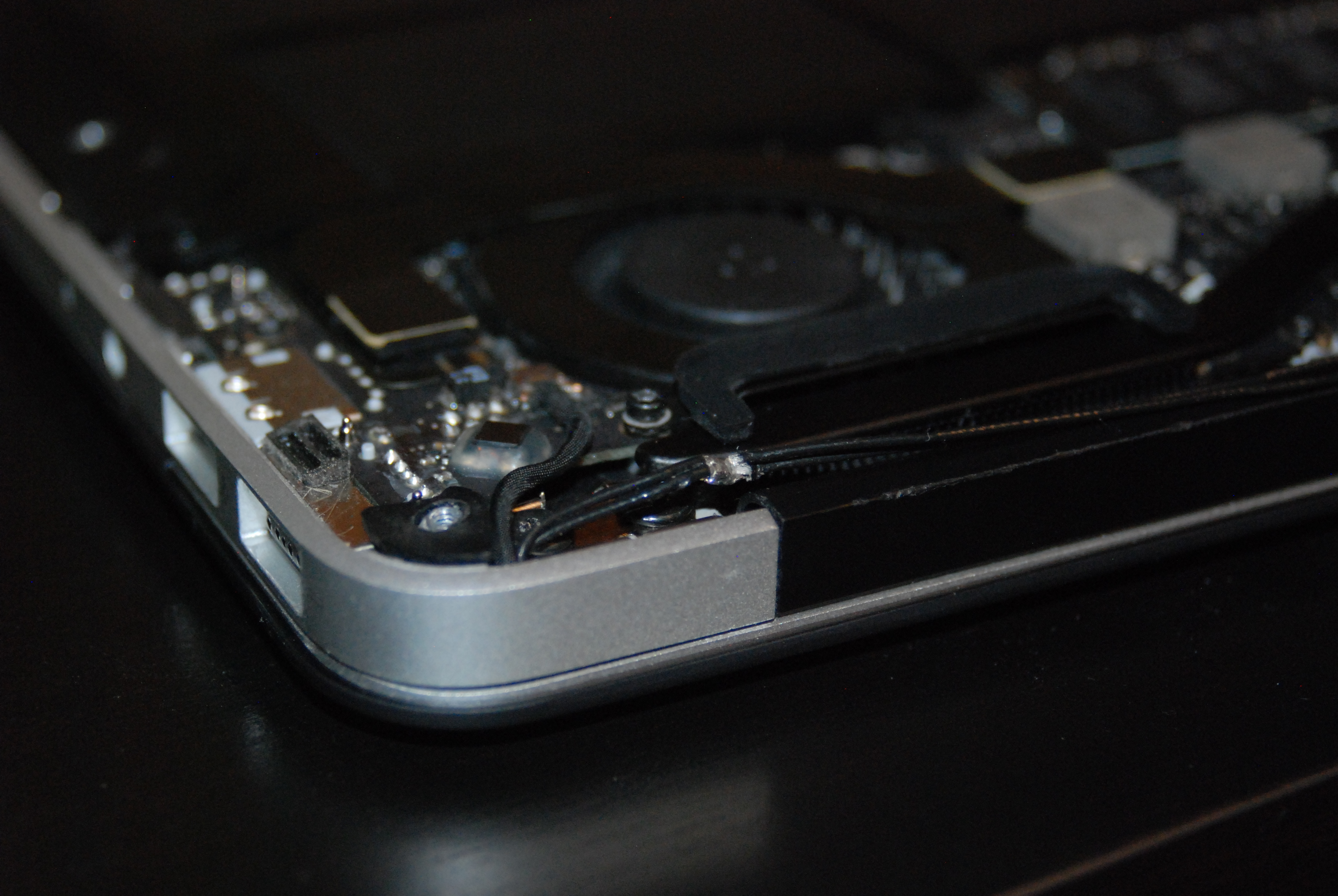

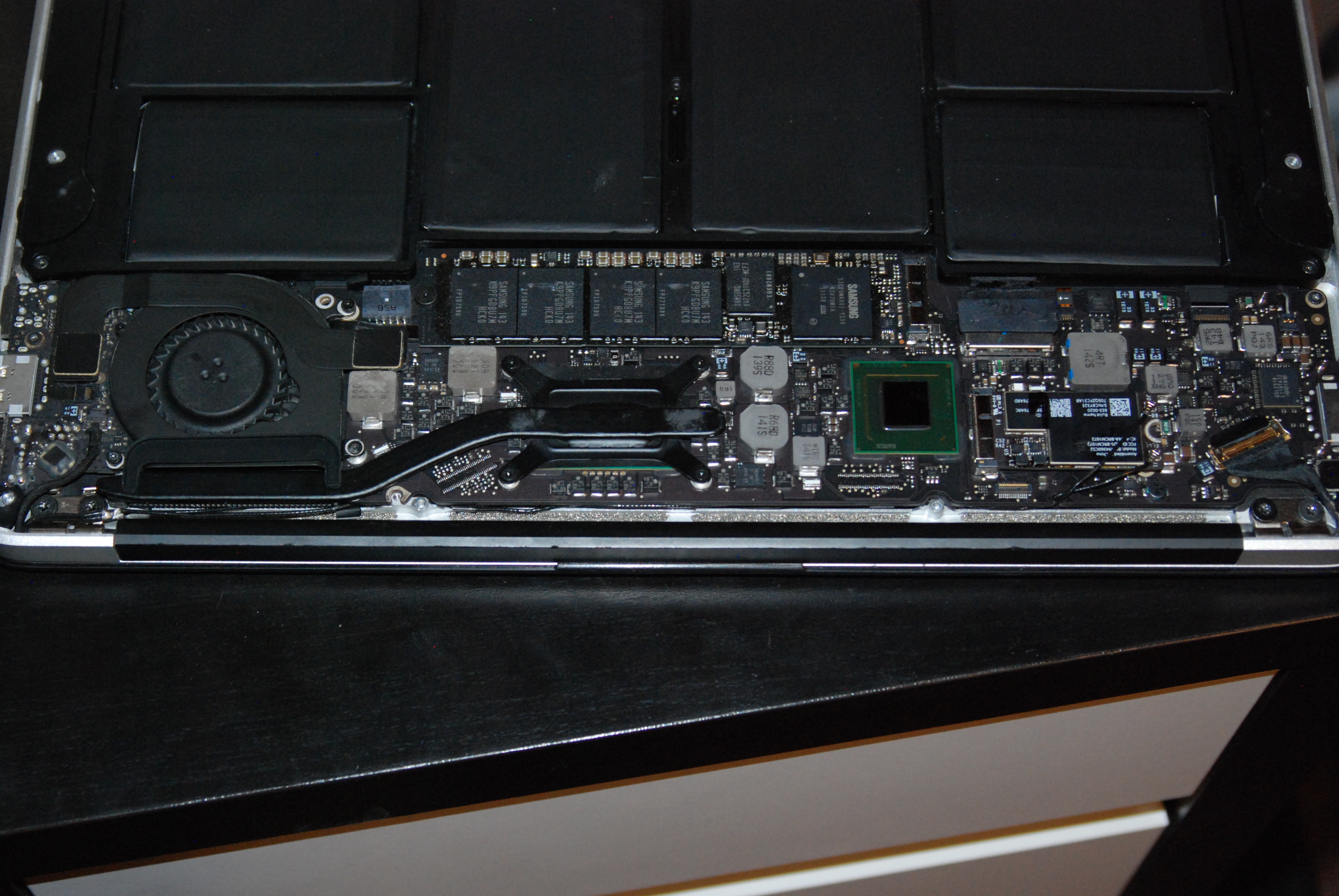

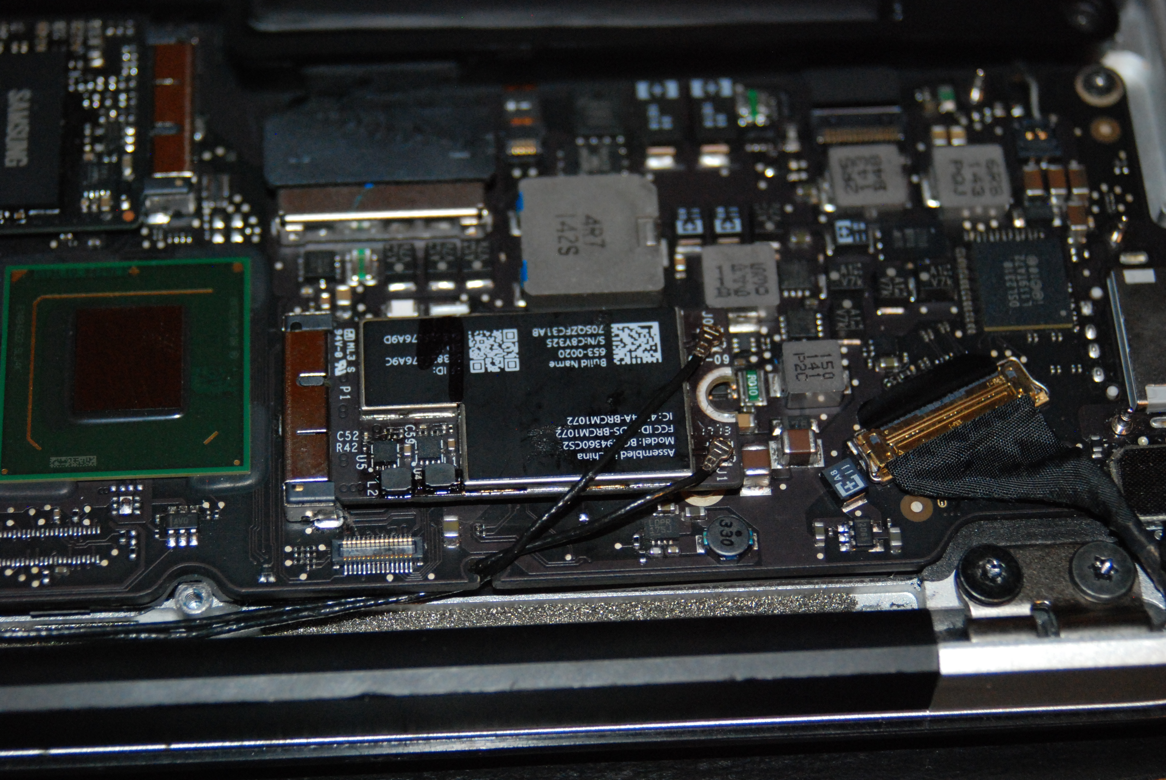

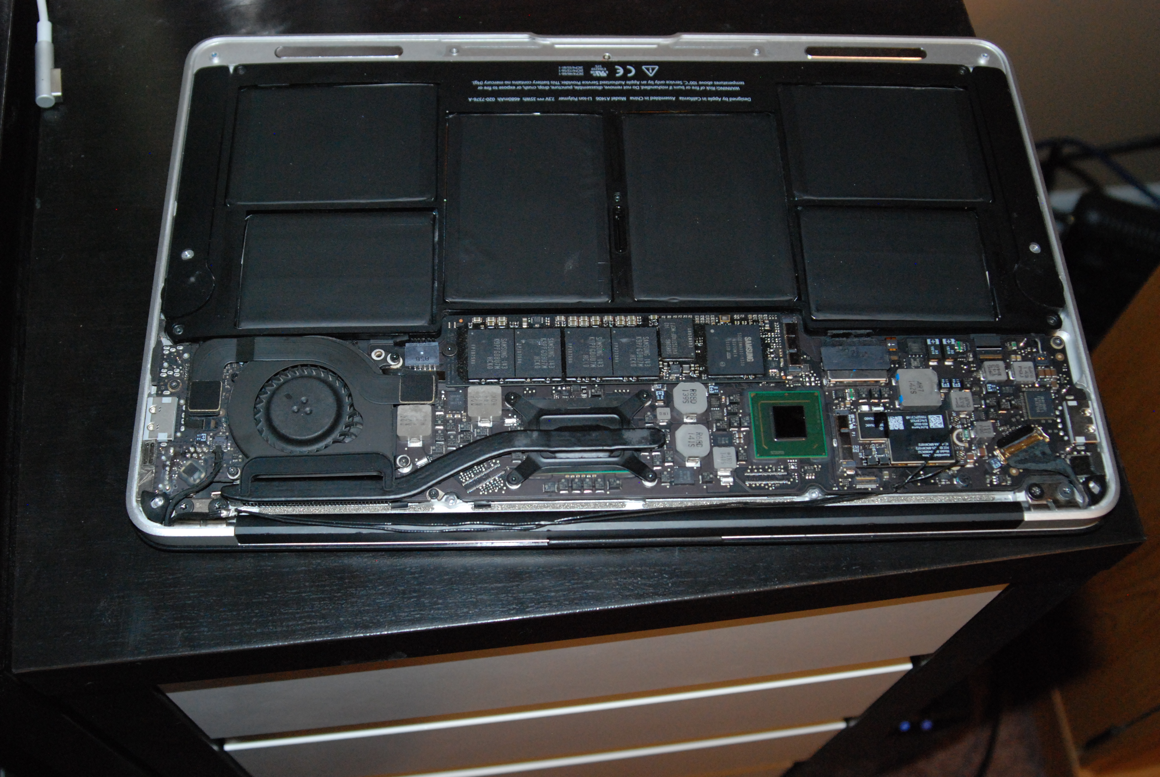

Here you are. The third picture shows a little piece you have to snap off the hinge piece, they solder the wires on so you have to clip it off but as you can see everything goes back perfectly.
the 4th picture shows how the new card is a little longer and the last picture is the wires rerouted so it looks just like normal again. I hope this helps people with the air. any questions feel free to ask.

Thank you, it worked great. Until I understood it, I stripped down a lot more than I needed. All you really have to do is open the cover, unplug the battery, and swap the cards. I ended up using a black tape over the old screw hole to prevent shorts on the new card. You can then unfasten the hinge on the left in the image and lift out the clamp for the BT cable. Then refasten. You might be able to pull the cable through the remaining plastic loop tie downs.
I ended up taking out the battery and unfastening and lifting up the main board to remove the plastic tie downs. But this is fiddly work requiring removing the screen connector and (I think) camera cable.
