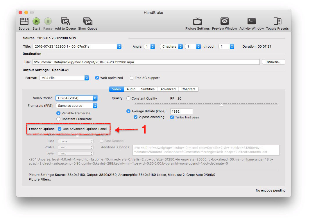

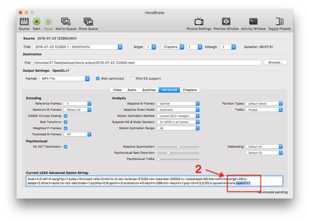

Unless you manually insert the command OpenCL=1 in the Advanced tab, the GPU should be doing absolutely nothing in Handbrake.

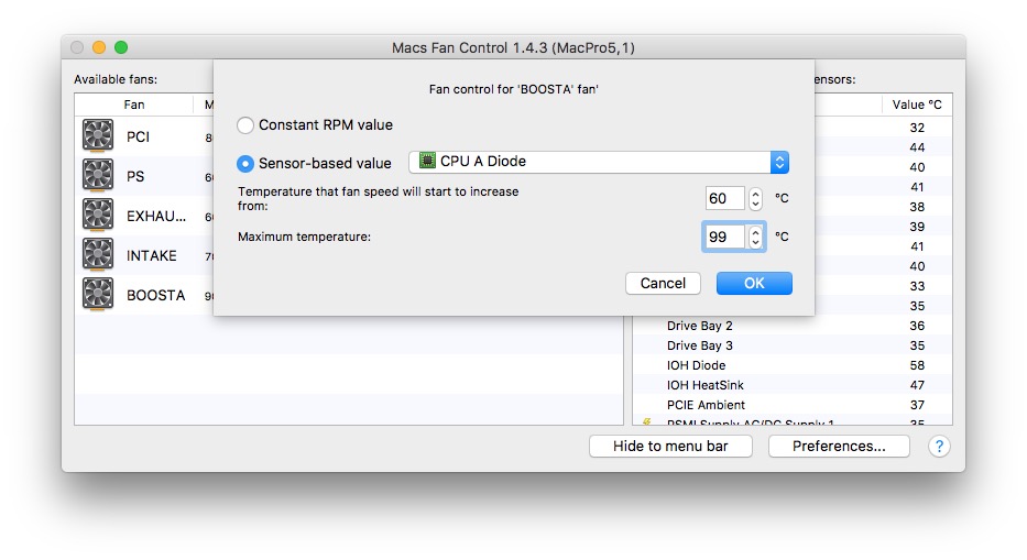

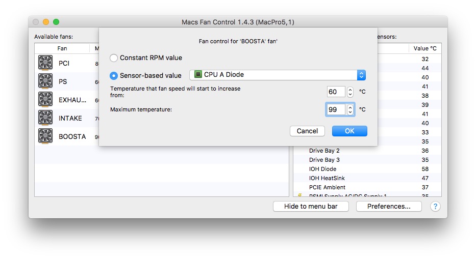

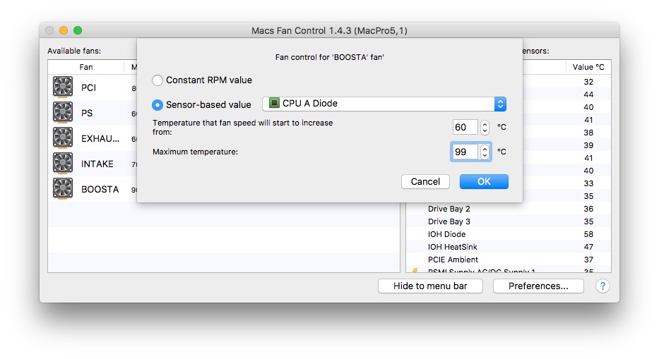

A simple work around would be setup your own Boost A fan profile in MacsFanControl. e.g.
You can try some different numbers and make it run at or below 80C. No need to be too extreme, and just make a profile that you are happy with (in both temperature and fan noise)
The way to find out the Min / Max temperatures is simple.
e.g. You want to keep it at 70C as you first pic does.
Assume CPU A idle at 50C - 800RPM, Max at 70C - 4000 RPM.
4000 - 800 = 3200
e.g. If you want the fan start spin up at 60C.
70 - 60 = 10
That means you want the fan spin up 320 RPM for every 1C
Boost A max RPM is 5200.
5200 - 800 = 4400
4400 / 320 ~ 14
So, the profile will be
Min 60C
Max 74C (60+14)
In this case, the fan will start spinning up from 60C, increase 320 RPM for every 1C, and slowly reach your decided equilibrium point (70C, 4000RPM).
4000 - 800 = 3200
70 - 60 = 10
5200 - 800 = 4400
4400 / 320 ~ 14
Min 60C
Max 74C (60+14)
