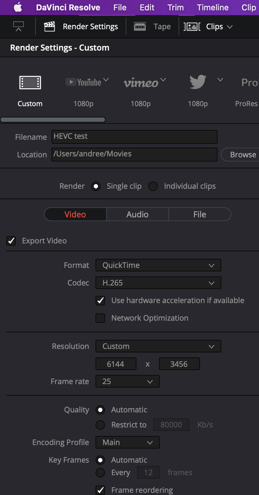

Depending on your software of course.... if you have Resolve you can drop any clip on a timeline (hopefully you already have a project or two up and running) and on the 'Deliver' page chose h.265 as export format, check 'use hardware acceleration if available'
Then set it to UHD and export. If HEVC encoding works, the export should progress realtime-ish. If not, you might see the first few frames export at a promising speed and then after a short while you'll end up between 0-3 fps. Or similar... I don't have any expericene with the newer Mac Pros.

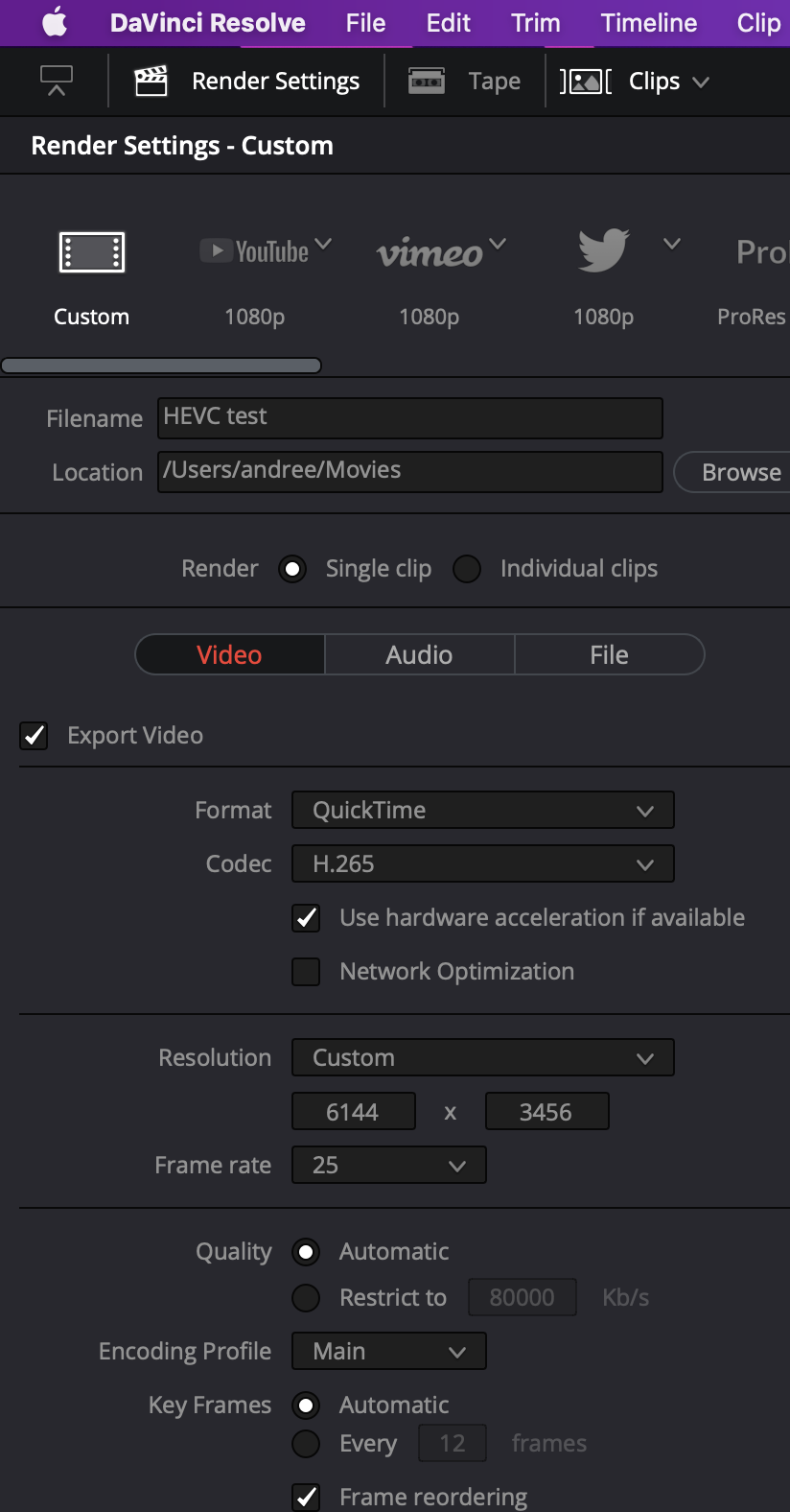

Hmmm so the above mentioned method it blazes through the export in no time at all. Do you want me to try out somehow the 10 bit hdr part? If so, how do I do that?
If you have things up and running: a minimal change.
Just go down a bit in the settings. The 'encoding profile' says Main. Click the dropdown and select Main10. This creates a 10bit HEVC, which is what I'd use for UHD HDR content for my OLED TV for instance.

Did the test in Resolve, a 50 second video took 29 seconds to export.. so is the HW acceleration active? I assume so?
