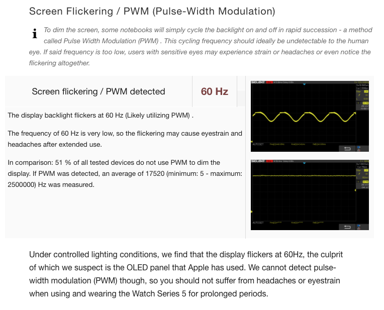

It does however still flicker at 60 Hz. I don't know why Notebookcheck says it shouldn't case headaches or eyestrain when it obviously flickers and at a low frequency too. Maybe the flicker percent is low, but they never seem to mention that number. If the flicker percent is under 8-12% with that smooth curve that should be fine at 60 Hz. That's about the amount of flicker coming from an incandescent light bulb.
But if Apple can get rid of that too it would be great. I'm just not holding my breath as color accuracy at low brightness suffers when drive voltage drops, which is one of the reasons for using PWM in the first place. Hopefully Apple or someone else is hard at work on improving backplane technology for these types of displays, or else anyone sensitive will be screwed for years to come. That and MicroLED and the two biggest drawbacks of OLED will be solved. Flicker, and permanent image retention.
I guess a slight flicker is better than a full strobing on and off even if it is at a much lower frequency.
For most people PWM isn’t an issue if the frequency is high enough it’s just when it is down around the 200-300Hz area which most smartphone OLED panels use it becomes an issue. So if they can’t eliminate PWM maybe they can find a way to increase the frequency because at least that will be a fix for most people.
