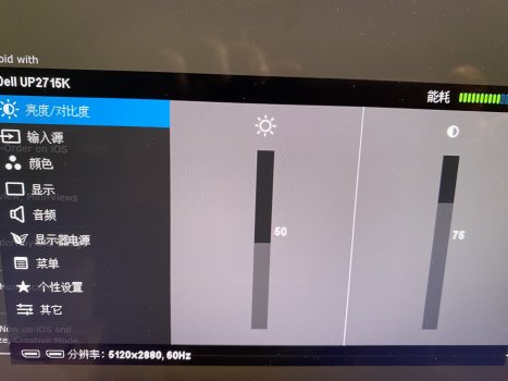

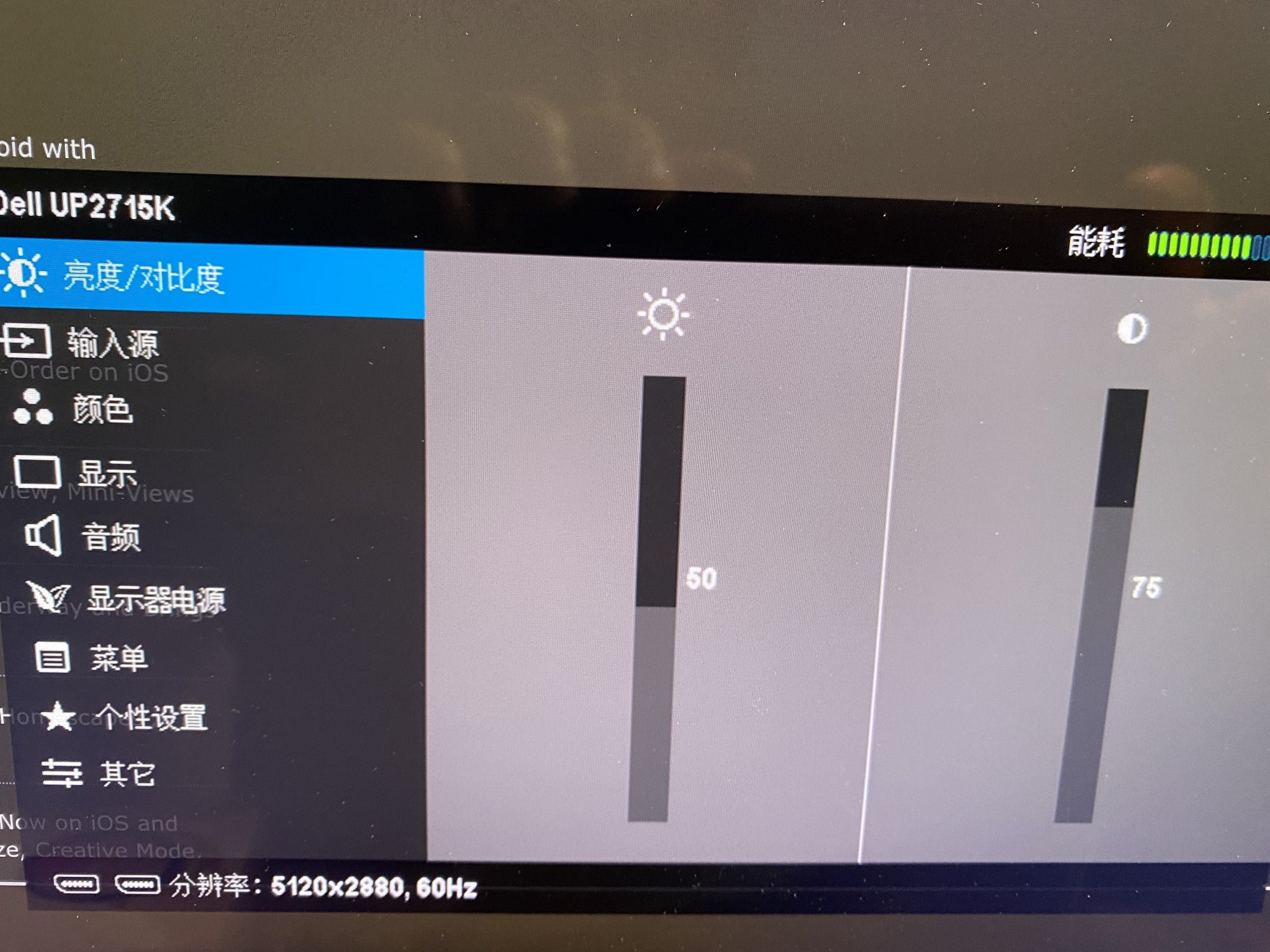

If it works for the LG UltraFine 5K and HP Z27q then it should work for the Dell UP2715K. You need to connect both DisplayPort cables. You can try one per Thunderbolt port. If that doesn't work, then you need to connect both to the same Thunderbolt port using a Thunderbolt dock or a Thunderbolt to dual DisplayPort adapter. Let us know if it works. Take a photo of the onscreen menu showing 5120x2880 resolution.

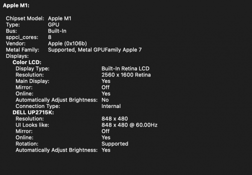

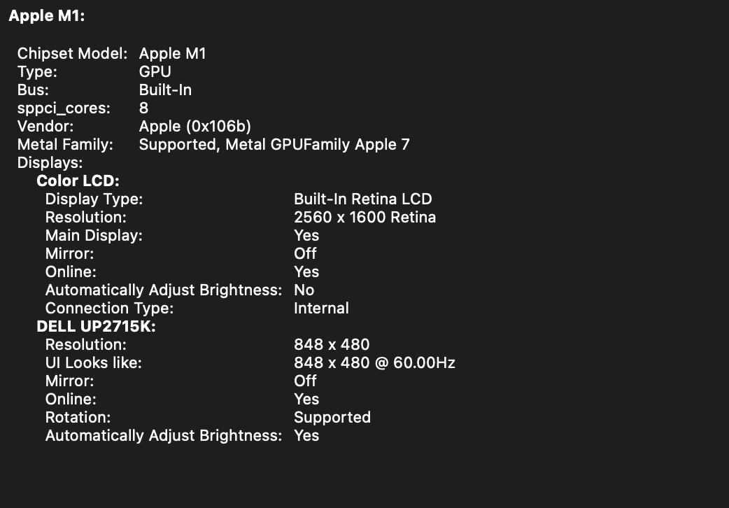

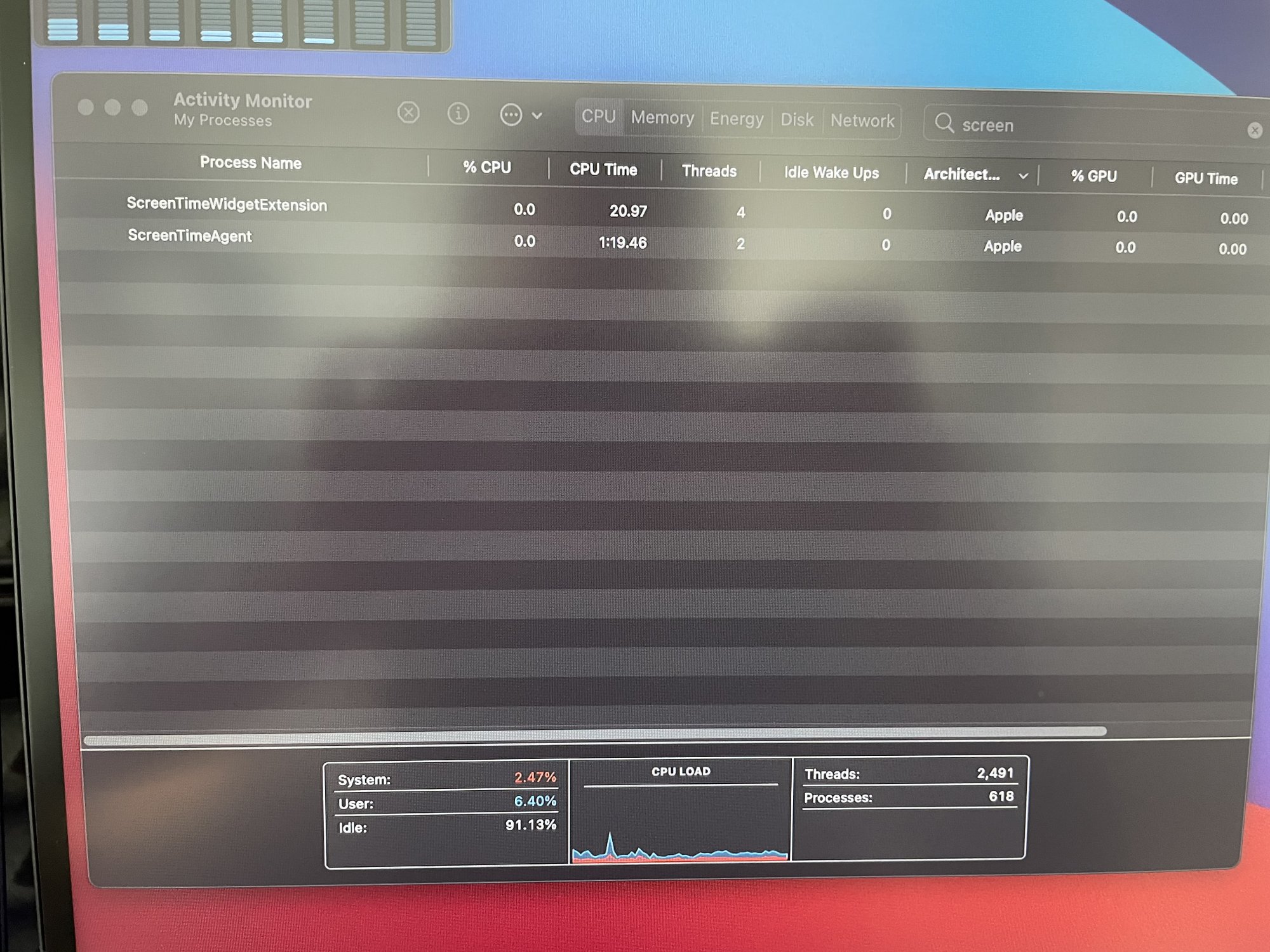

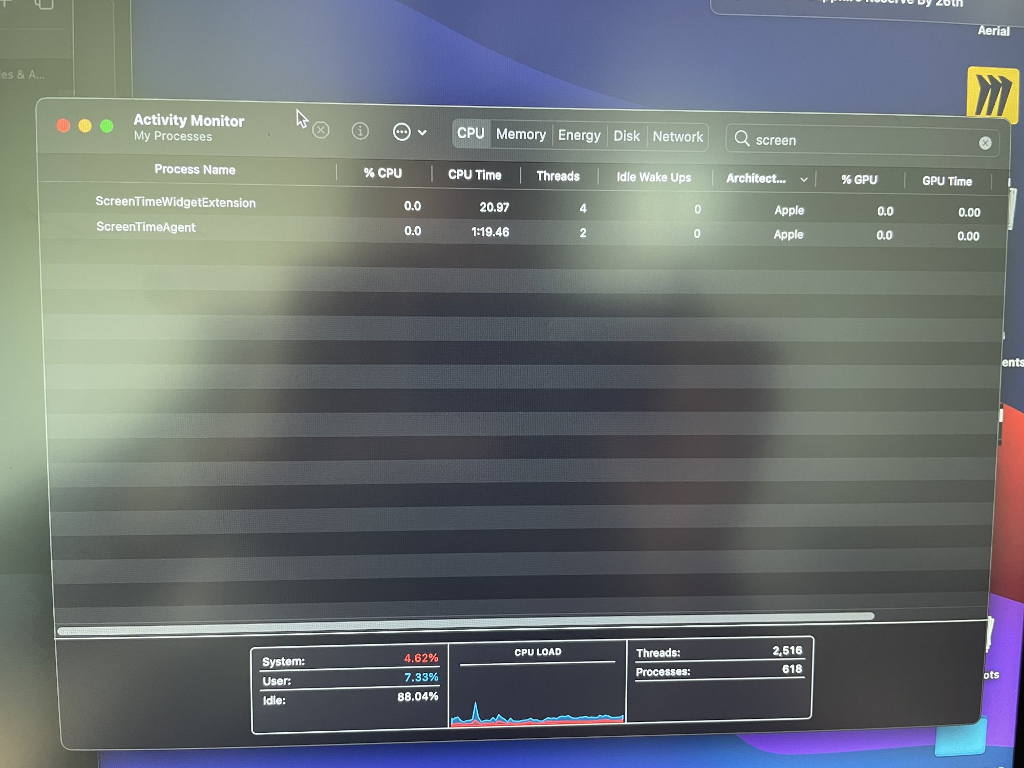

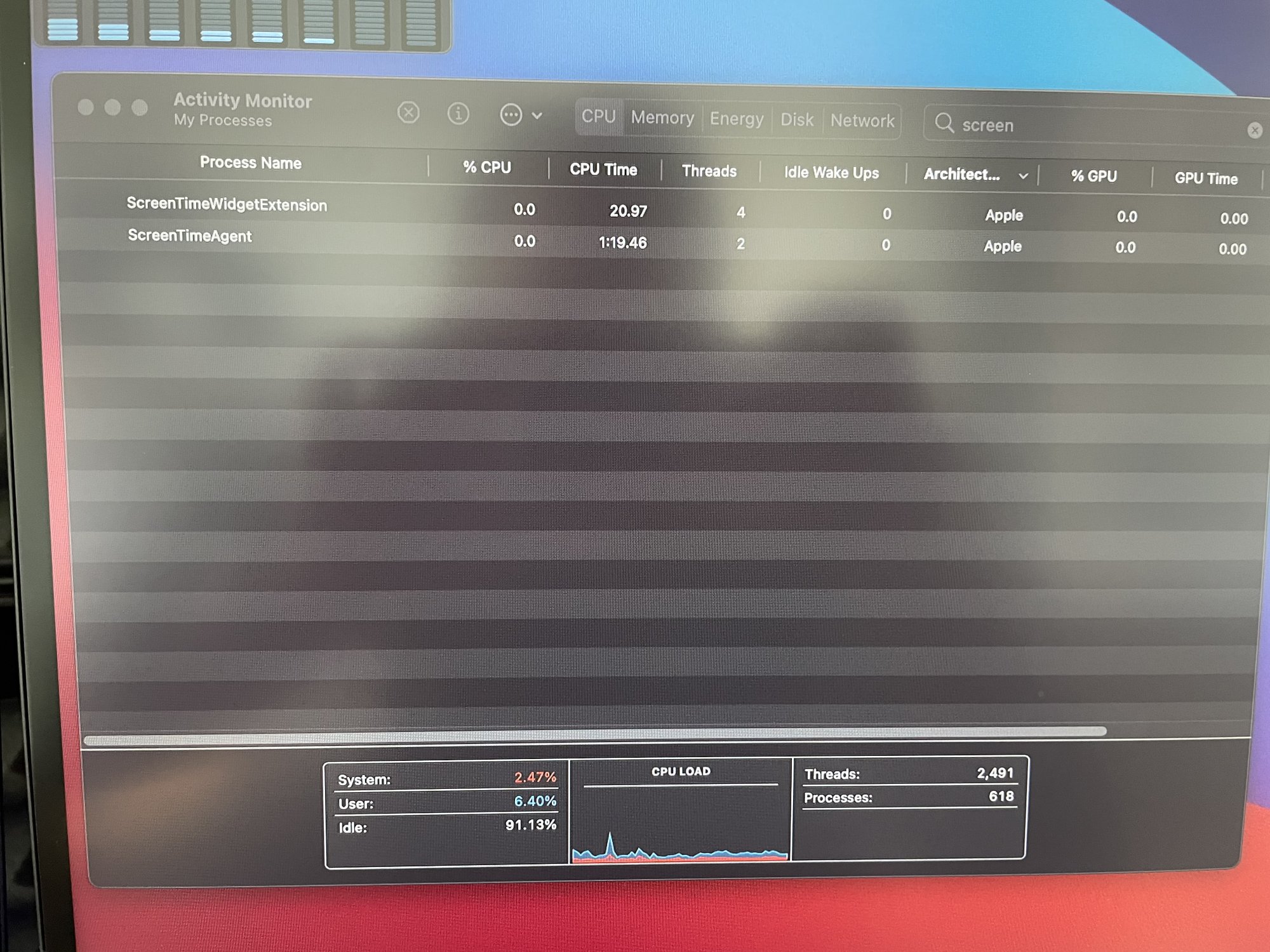

Finally figured out how to make it work. When first connected thunderbolt 3 to dual displayport from new mac to my Dell UP2715k, it only outputs 848*480 for some reason. I can use apps like EasyRes to manually set my Dell to 5120*2880, but no High DPI option available.
However if i put the laptop on sleep and wake it up, it will correctly recognize my dell and shows the 5120*2880 at 2x Retina scale correctly.
It's the weirdest thing ever and I have to do it again every time I turn on my laptop but at least there is a way to make it work now.
