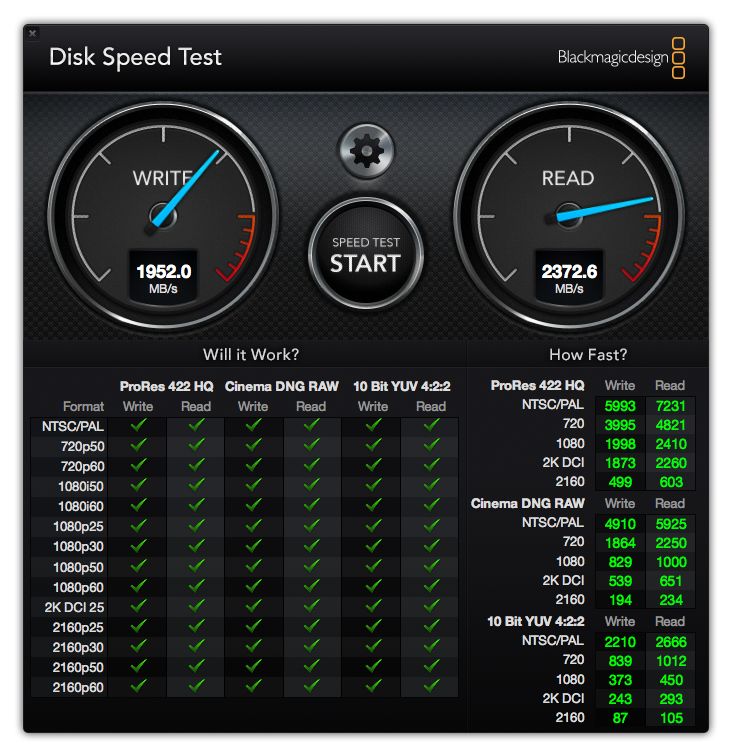

512 GB SSD in the mid range 21.5" 2017 iMac.
Impressive. Who is the manufacturer? :apple:
According to what I could find it appears to be a Samsung SSD, SM1024G. I was actually expecting the SSD, in the 2017 iMac, be around the same speed as the SSD used in the 2016 MacBook Pro which is about 3GB/s. Maybe the SSD in the 27" is different from the one used in the 21.5".
According to what I could find it appears to be a Samsung SSD, SM1024G. I was actually expecting the SSD be around the same speed as the SSD used in the 2016 MacBook Pro which is about 3GB/s.
Thanks. Most likely correct. I was assuming 15% tops. 30% is big. Looks like a lot of new engineering in these new iMacs. It's nice to feel good about a new Apple Hardware release for a something other than a phone. ;)

The internal SSD on the 27" should be ~2000MB/s Write and 3000MB/s Read. The additional 500G will cost $400 more. You can't even come close to that performance in an external drive without spending considerably more money. If you ever think you can use this (Pro Audio, or Video editing I would assume) - then spend the extra $$. FWIW - I did :). If all you need is bulk storage - 1TB SSD in USB3 is ~$350 and will do ~350MB/s.
