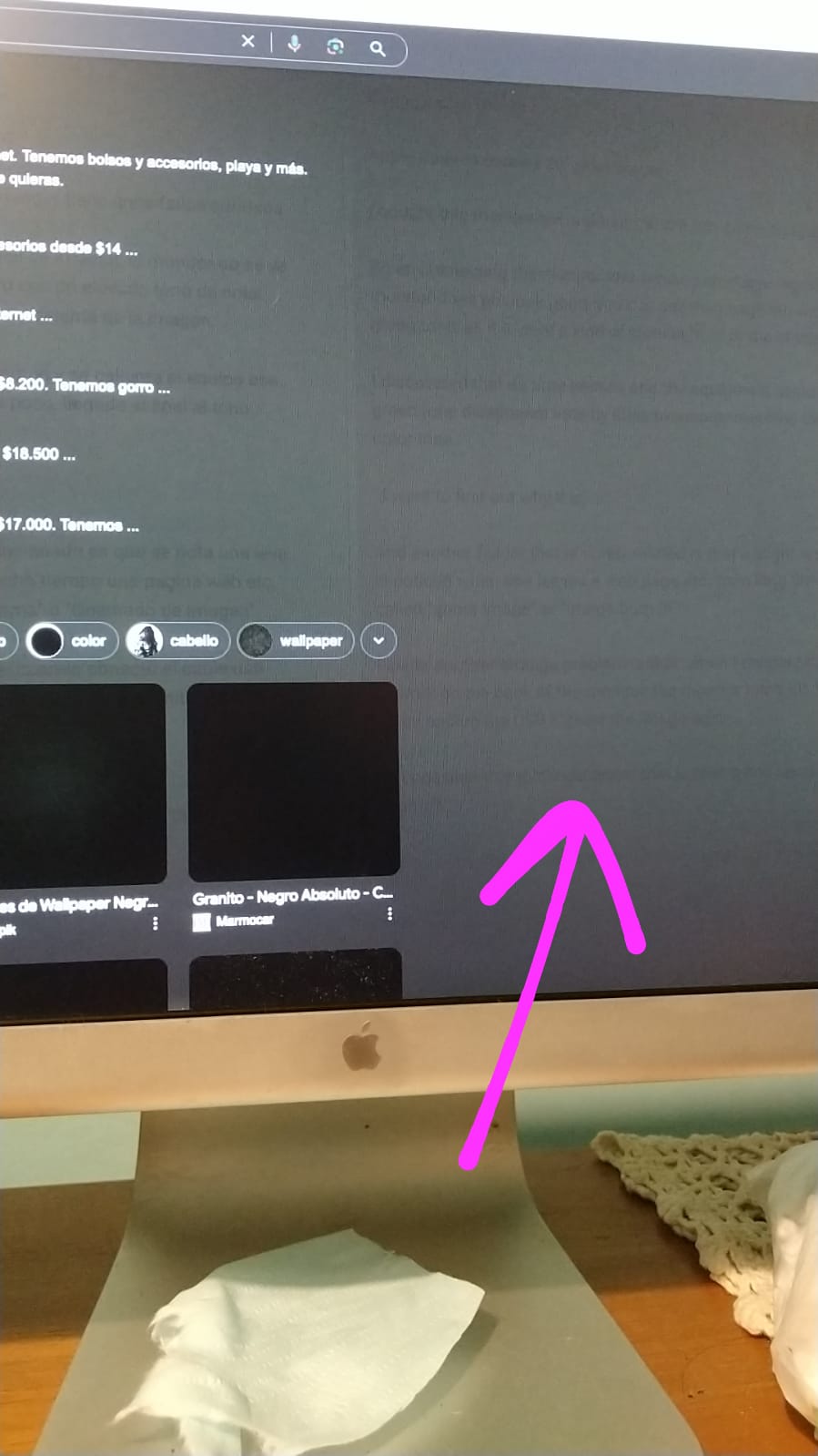

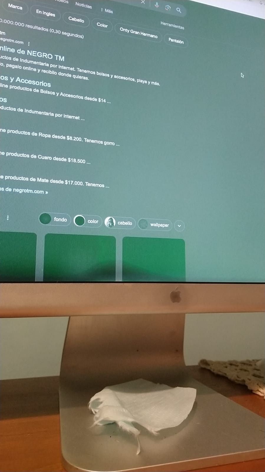

When connecting the monitor and sending an image signal, the monitor does not look good, you can see the image but with a high green tone, as if it were a kind of cloth in front of the image.
I have checked the cables and there are no false contacts. I am using a Mac Pro, I am not using any adapter.
I discovered that as time passes and the equipment (the monitor) heats up, that green tone disappears little by little, eventually reaching the optimal color tone.
I want to find out why it is

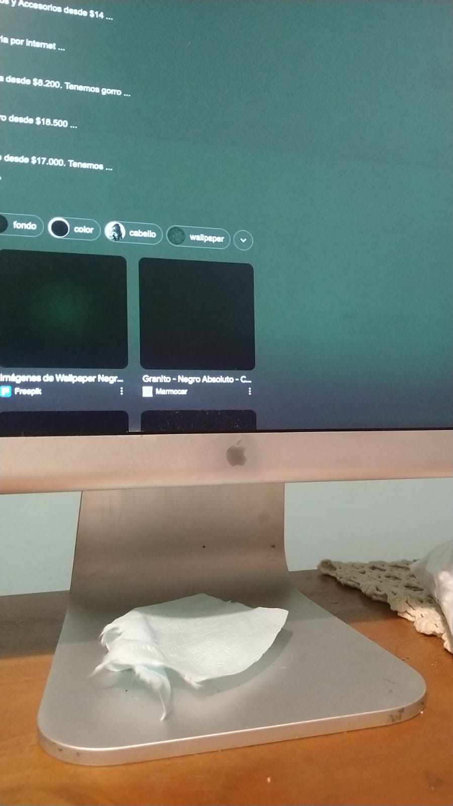

Another error that is surely related is that a slight residual image is noticed when one leaves a web page etc. for a long time, commonly called "ghost image" or "Image burn-in".
Finally, another strange problem is that: when I connect the USB cable to work on the back of the monitor, the monitor turns off, for no reason.
If you unplug the USB it gives the image again.
I attach images for greater compression.
Is it possible that it is a capacitor that is failing and takes a while to charge?
Is it possible that it has to do with the external power supply?
I appreciate any information you provide, I hope it can be fixed. Greetings and thanks.

It could be the power supply, or the inverter / CCFL backlight bulbs that provide the backlighting perhaps? But I mean with so many other faults too, is it really worth repairing unless you want a (potentially high voltage) project? I looked up the cost for an inverter board (used) and it's around $30. For $120 you could get a modern 24" display (admittedly not as nice looking).
These things were originally released in 2003-2004 and were discontinued in 2008 so it is potentially 20 years old now. Any parts you could get for it would also potentially be up to 20 years old (and well used) too.

Thanks for the contribution, I hope it can be fixed, I like electronics, I can take it as a project, I'm sorry to throw it in the trash when I can try to fix it.
Also, maybe we will discover what problem is causing it and in the future someone will find the solution useful.
I have checked the power supply. it's perfect.
That board you mention "inverter / CCFL" could be the cause, is it exclusively responsible for controlling the Color?
Other themes. I have been thinking:
What if what happens is that one of the basic colors does not load? For example, Blue.
Maybe the Green and Yellow charge and take a while to charge the Blue....?
I don't know which sector of the plate is responsible for controlling the colors.
I found a video on YouTube, someone explains a very common failure in this equipment, a small component that allows certain volts to pass through. I attach the link:
