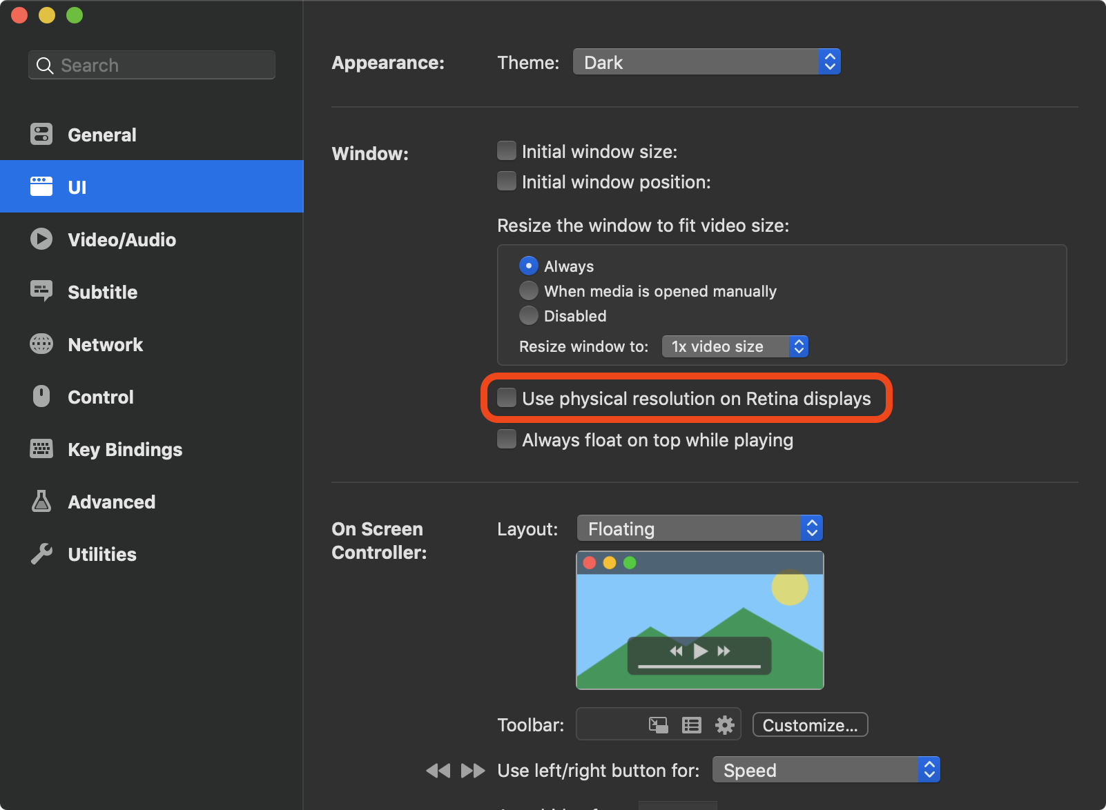

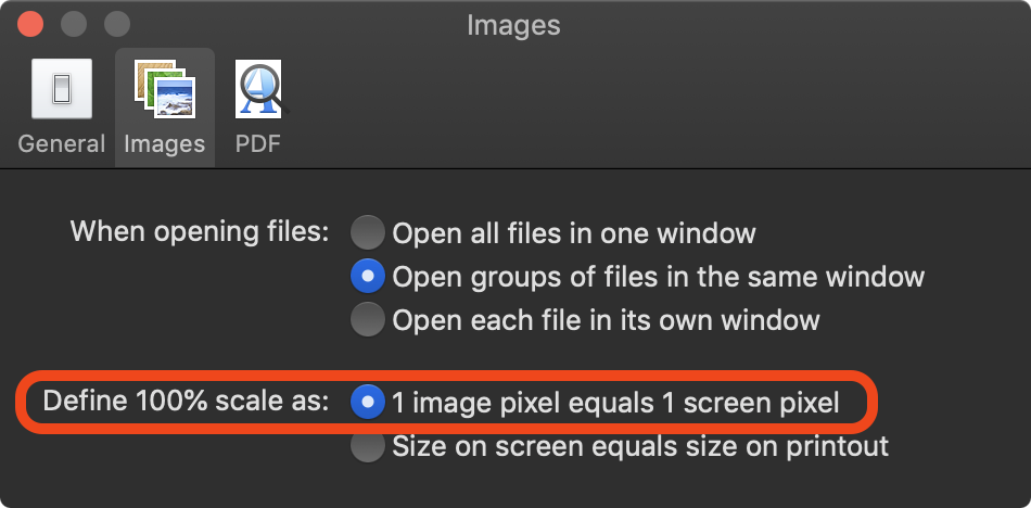

Hmm, however I've got a problem going on... if I open a photo or video it won't be the correct resolution according to 2160p. Quicktime, VLC, or Preview for pics, will resize the file according to 1440p. So for example; when I open a 4K video it goes out beyond my monitor, as though my monitor was 1440p. This doesn't really work for me. Everything else is great regarding the UI being a good size for me, but if pics and vids don't open at the correct resolution according to 2160p it's unusable.
Know how to fix this?

IINA has his option
Preview has this option
I use HiDPI resolutions for quite a few years already, never have trouble about play videos or viewing photos. They should display at their native resolution.
