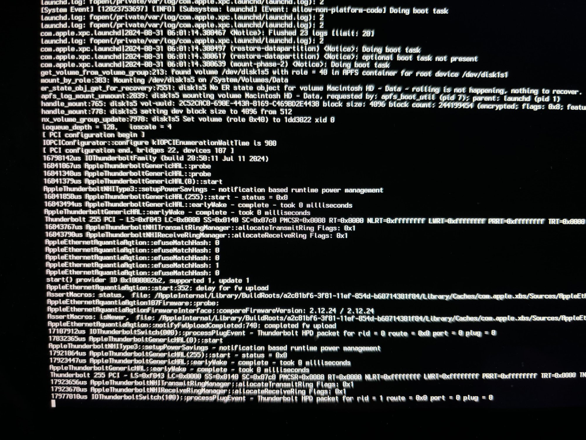

Out of the blue, my 2017 iMac Pro stopped booting. The Apple logo appears, it progresses to about 50% (within a minute), and then it just stops without any further action.
When I try to boot in Safe Mode (by holding Shift), nothing changes. Attempting to boot with Command + V (Verbose Mode) causes it to hang at a certain point (see the attached photo).

Reinstalled macOS to the current version (the reinstallation completes successfully, but the system still doesn’t boot).
Current version exactly being?
Appears to be related to Thunderbolt bus… at least when logs stop. What TB peripherals did you have attached?
Thanks for the reply, I was able to solve the problem. Fortunately it was not the ports, the problem was that the existing disk volume did not want to start the system.
Updated the post to help others if they have a similar situation.
