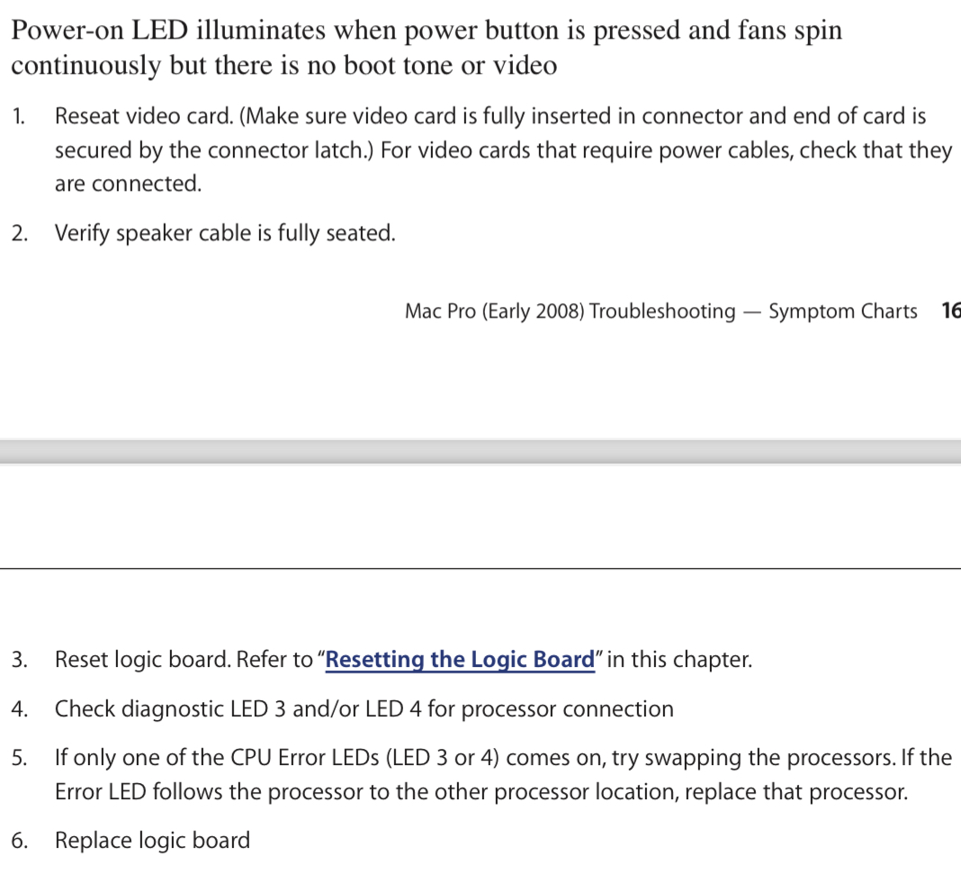

I think that the attached scenario present on the service manual is the one I am facing..
