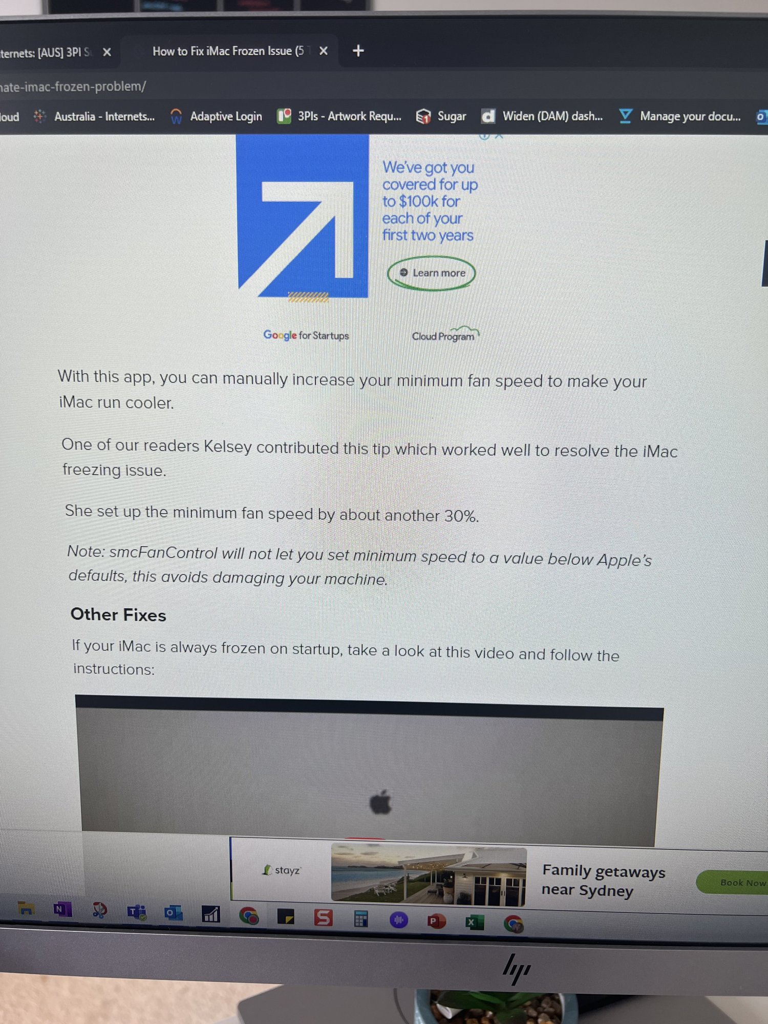

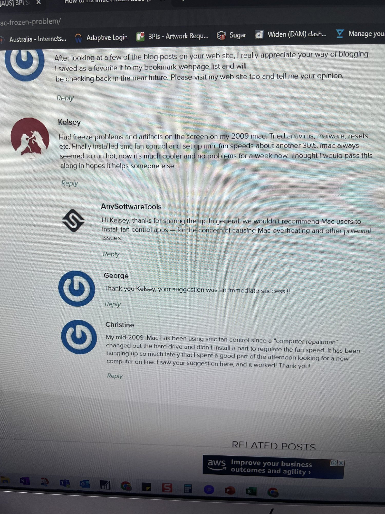

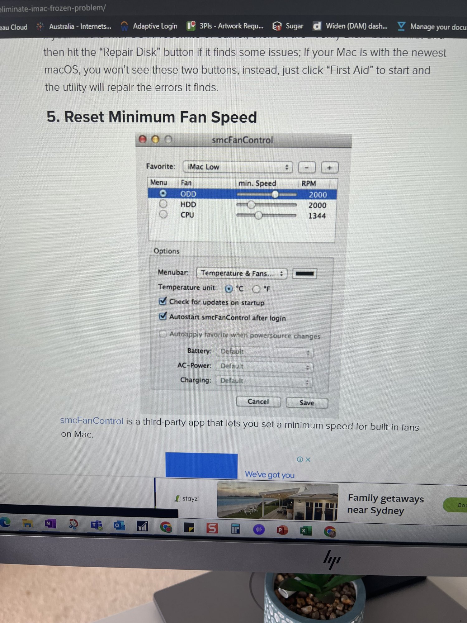

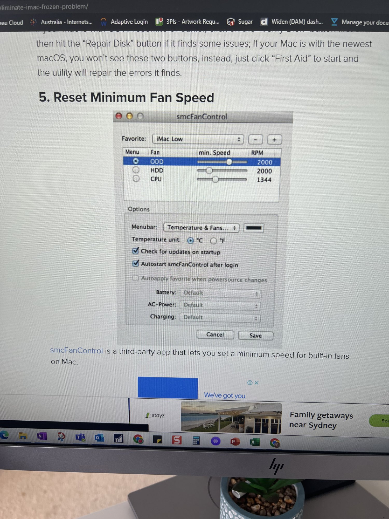

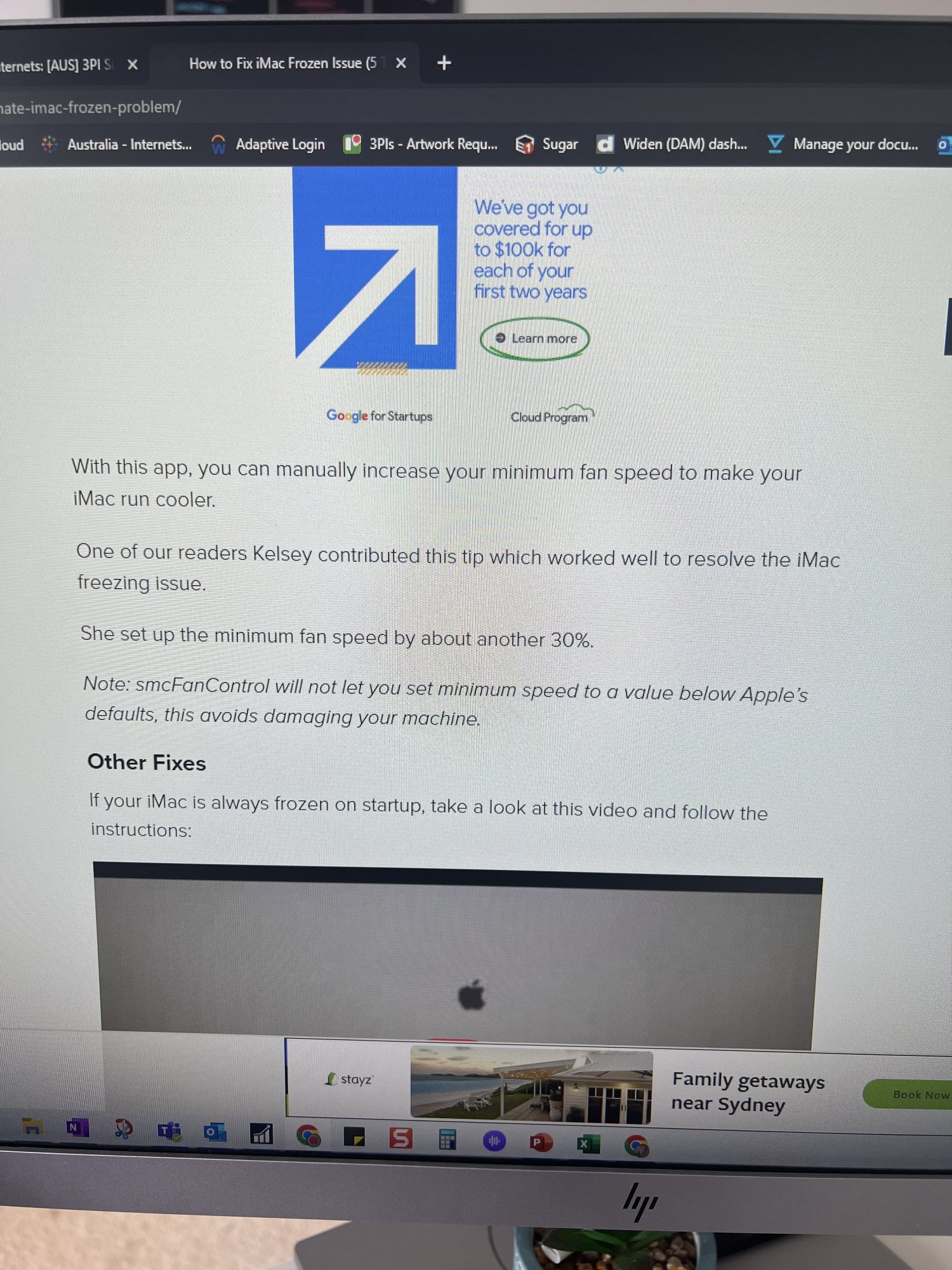

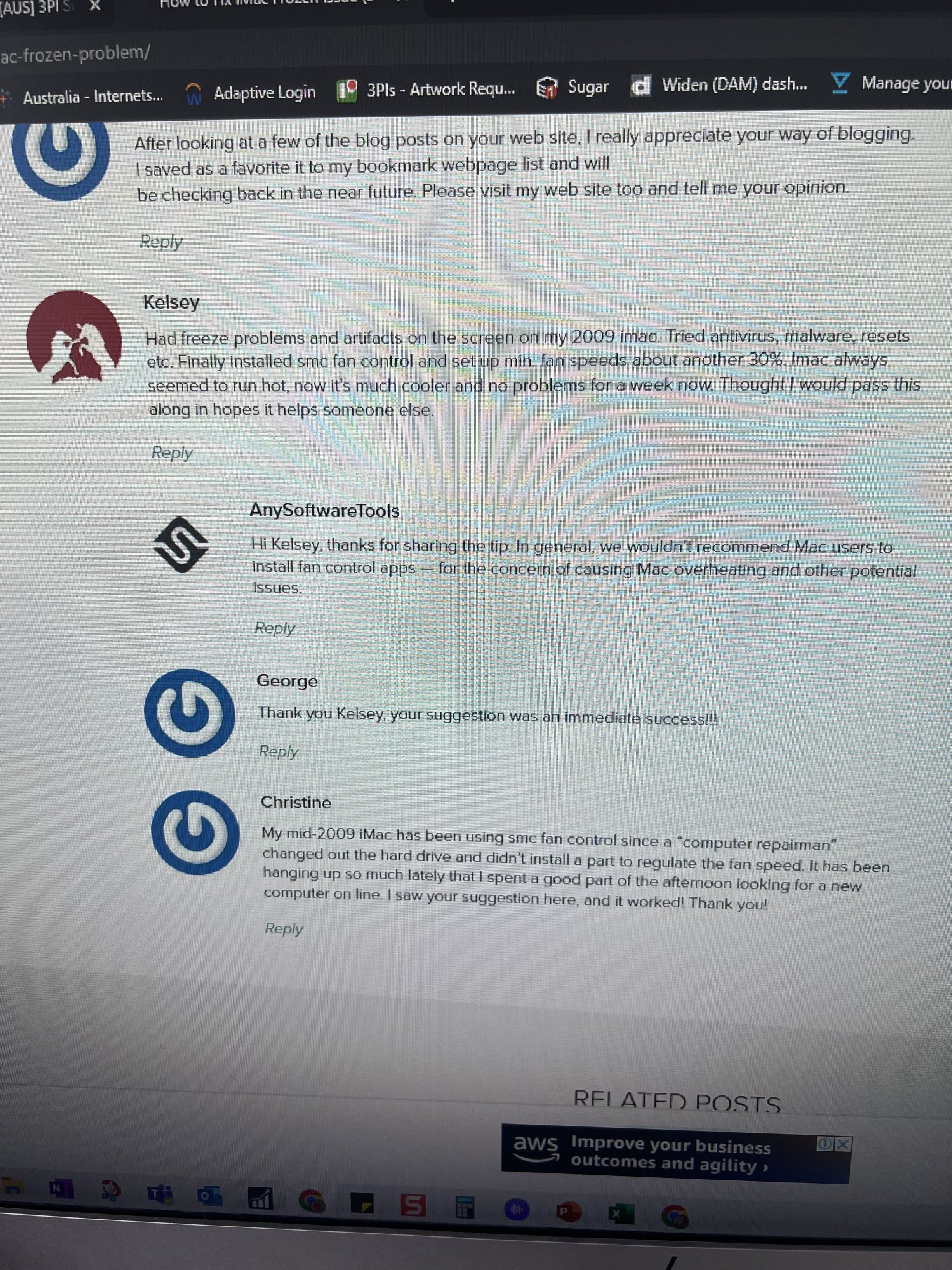

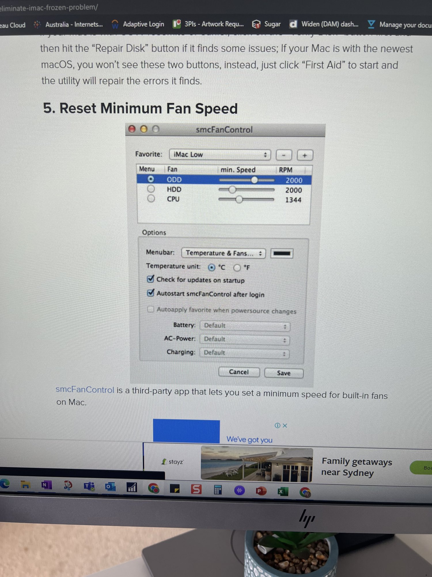

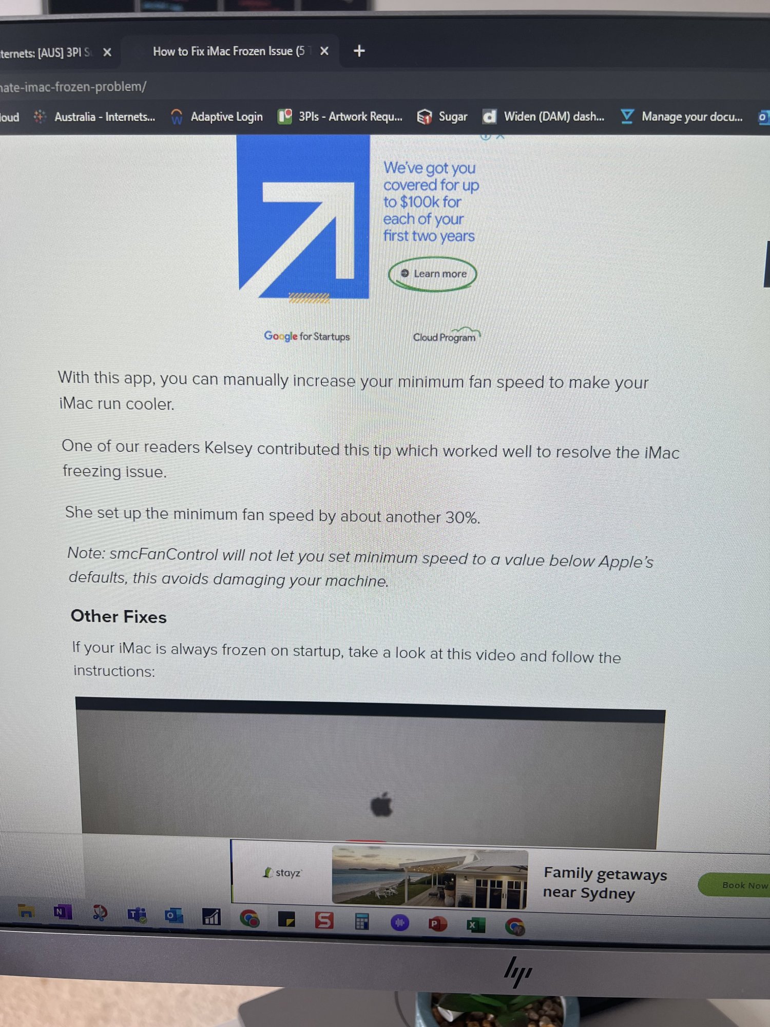

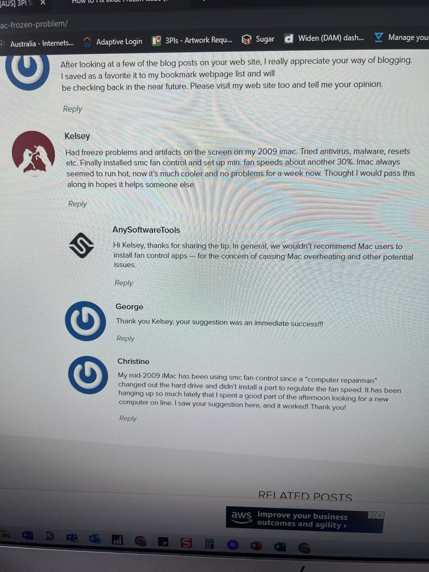

I was having issues as well with my iMac getting hot, freezing and crashing at boot and tried everything you did - I have a 2009 iMac. 2 things that worked for me - installing SMC fan control and set fans from top to bottom to 2000, 2000, and 1000, uninstalling anything that I installed around the time things stopped working, and looking at my login items where a rogue app placed itself so I deleted it. My iMac is now running perfectly again

Thanks for this man. Much appreciated. I think I’m going to try a factory reset first with a fresh update and see if that deletes anything that causes this problem. Failing that I’ll give this a go and see what happens. Thanks for the advice
