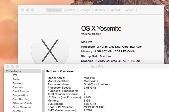

I've attached screen grabs of my system report and about screens.
I see you're using an nvidia card with Yosemite on your 2,1, is that an 'off the shelf' card or has it been flashed or is it second hand Mac, are you getting a boot screen? I found this card on eBay, is it the same as yours and will it do the job for me? http://pages.ebay.com/link/?nav=item.view&alt=web&id=171442619101&globalID=EBAY-AU
Off the shelf generic PC card. Works perfectly. No boot screen but my mac hardly ever switches off so its not a problem. And besides you can keep the old 7300 or x1900 card in one of the other slots if you need a boot screen for some reason.

The stock drivers in Yosemite work fine, but with my card I had to install the latest web drivers in order for the card to show up as a Gt730.
