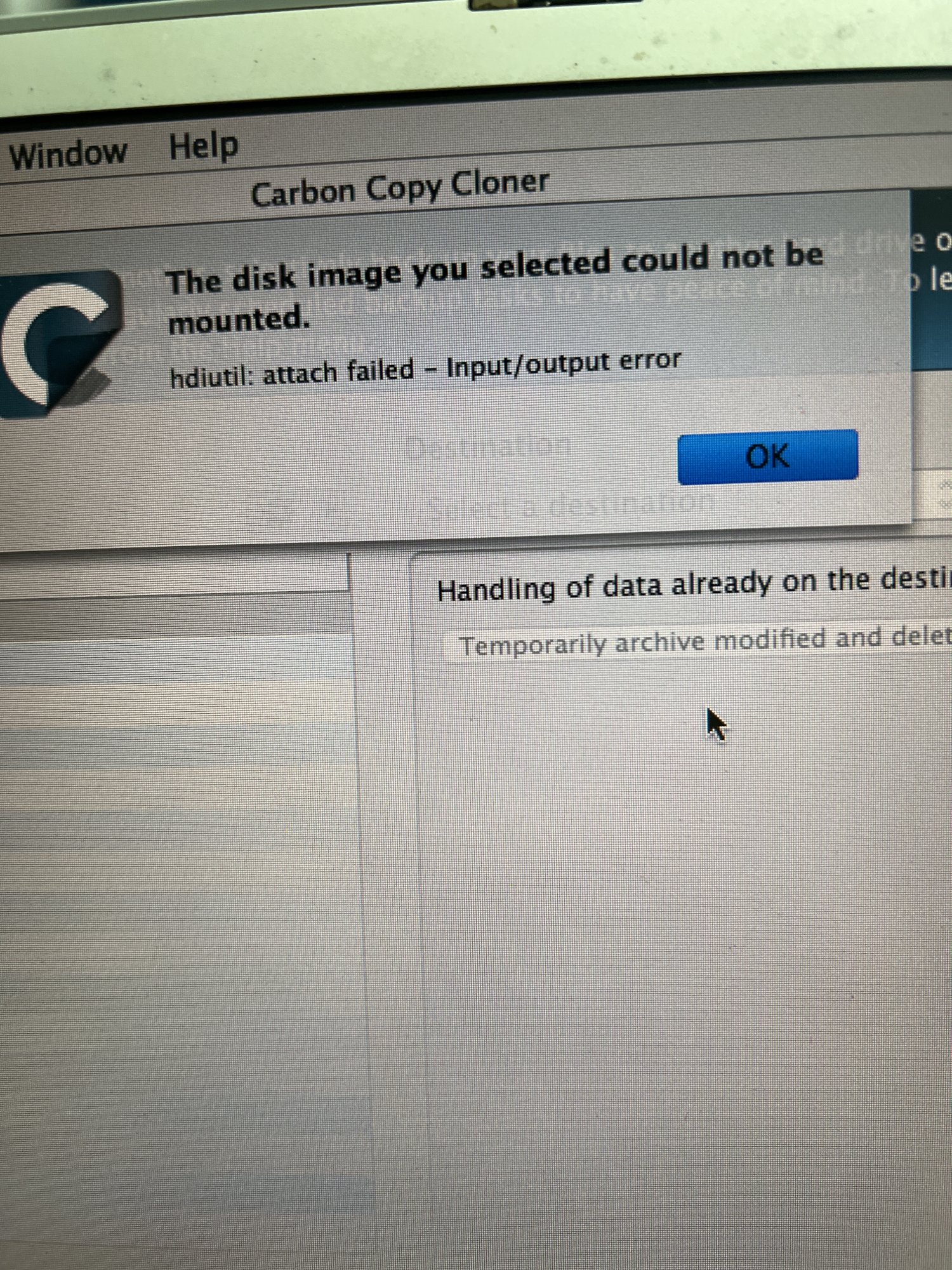

I was very stupid, I partitioned my drive wrong and deleted EVERYTHING. But I have a back up there’s just one problem the DMG won’t mount.
