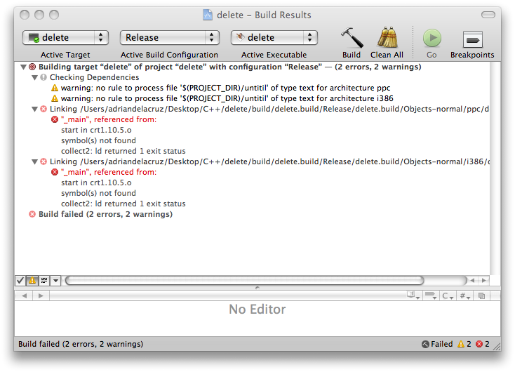

hi im having his result failed results any idea what i did wrong? thanks:)
here are my codes:

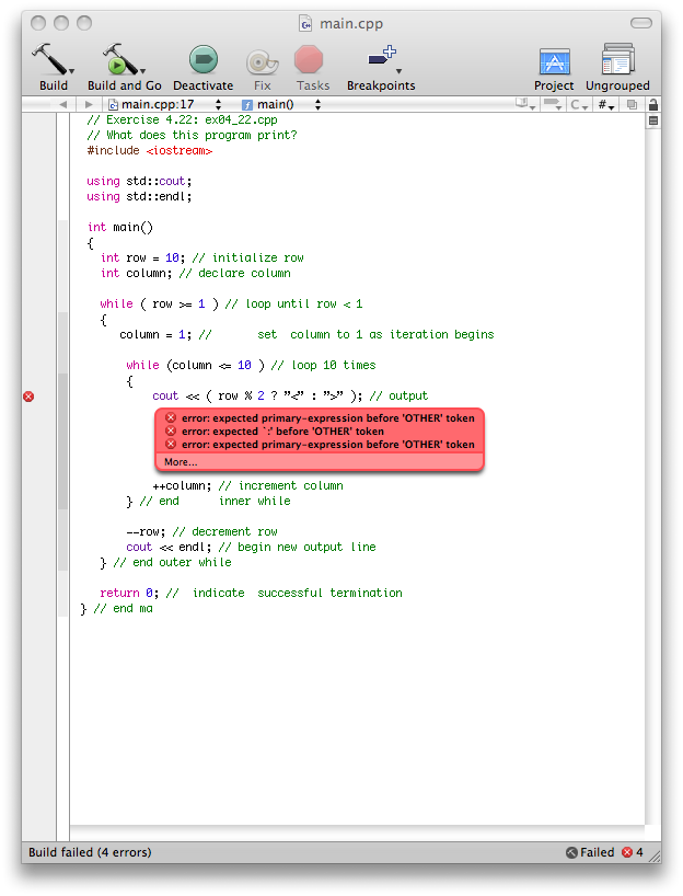

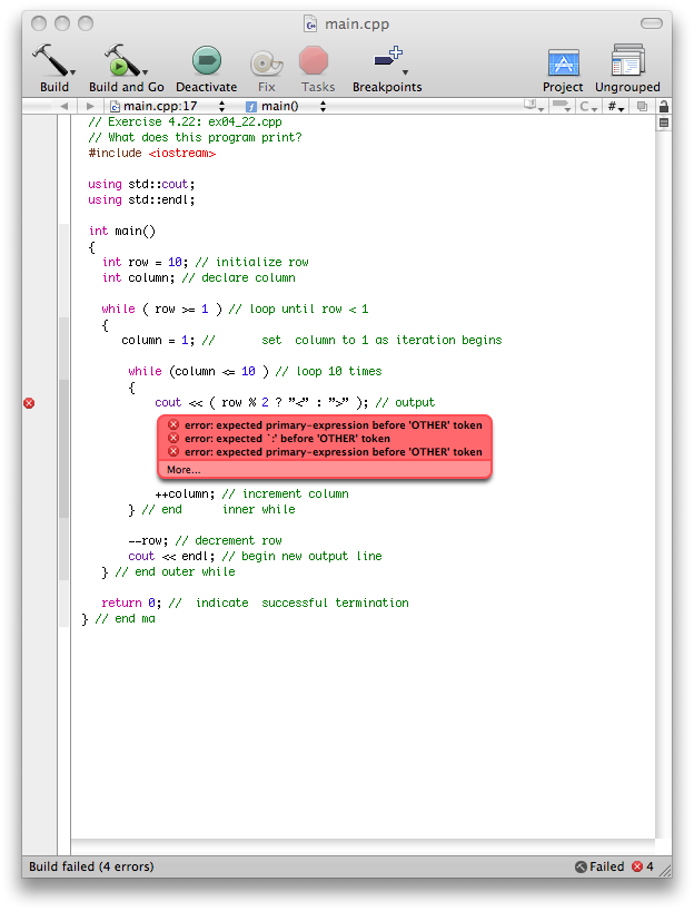

hi, can anyone tell what is this annoying error about and what should i do? thanks!!:)
Those double quotes look a bit strange. Not sure if you are using the correct character for double quotes or if it is just the font you are using. But the error message implies that the double quotes are wrong.
b e n
By the way, instead of listing all the methods/members of a namespace you want to use, you can pull the whole namespace in with the line
Code:
using namespace std ;
It looks OK to me?????
Are the double-quotes around the < and > generic double-quotes?
They look like they might be the directional ones, which wouldn't be valid in C/C++.
If you're not sure, try deleting and retyping them.
Edit: beat to the punch.
:Dyou were right guys its the double quotes, changed it and got it working:)

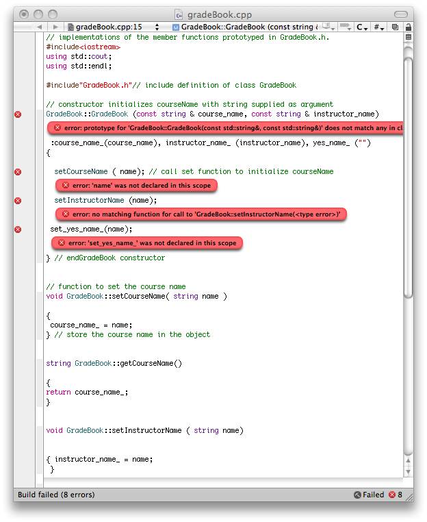

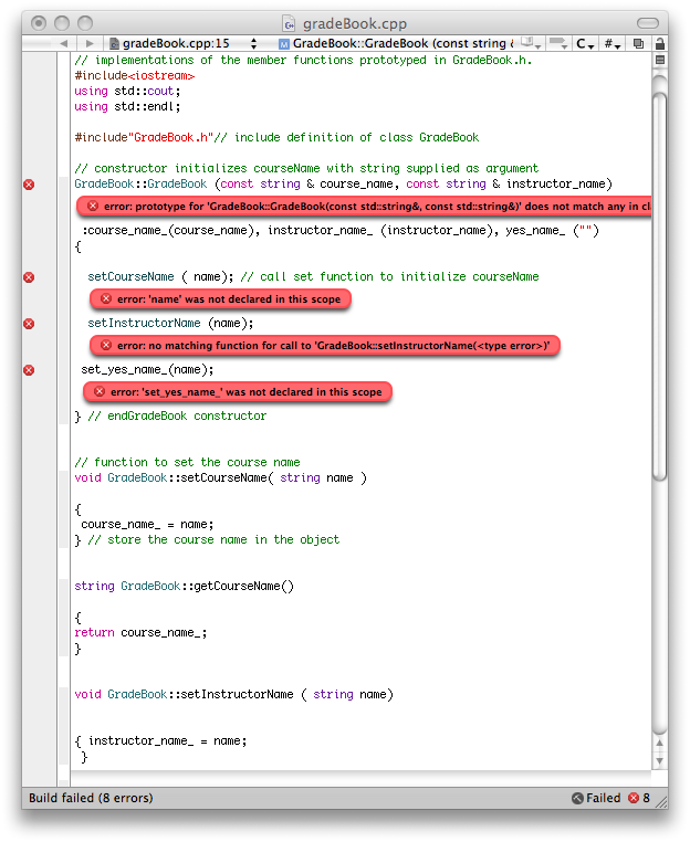

hi, can you please follow up on what i did? i cant seem to get rid of the errors:confused: thank you for you patience:D
It would be much more helpful if you copy that source code and paste it in here in CODE blocks.
Include your .h file as well.
-Lee
Hi
Looks to me as though gradebook.h is missing the declaration of the new constructor.
The other 3 errors are just typos, you're using name which is not one of the parameters passed to the constructor. But then again those 3 lines are redundant because course_name_, instructor_name_ and yes_name_ are all initialised anyway because they are in the initialisation list ( the initialisation list is the stuff after the : and before the opening {.
