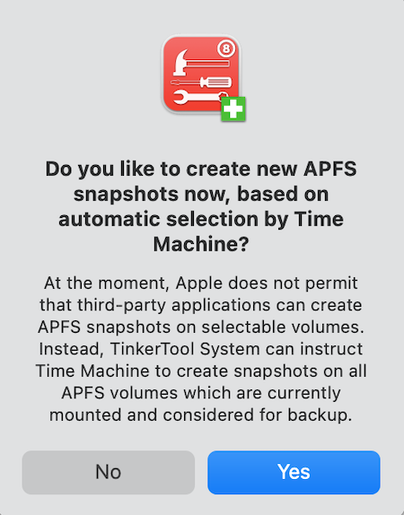

Third party apps can't actually create local snapshots on the Boot volume. Only Time Machine can do that. Tinkertool System Pro has this helpful comment when you try to instruct one. If you click 'yes' a snapshot is created on the local boot rive but it appears in Disk Utility as a Time Machine Snapshot.
Not quite. Creating snapshots (local or backup) requires a special entitlement from Apple. Apps I use (CCC, Chronosync, Arq) have that entitlement and do create local snapshots on both boot and other backup source volumes. The apps have to take responsibility for removing the snapshot at some point in the future. CCC, by default, deletes local snapshots on backup source volumes after 24 hours (just like TM), but is configurable. Chronosync and Arq create local snapshots to provide a consistent file system before backup and remove the snapshot when the backup is complete.
That is a neat trick. I assume TM deletes them after 24 hours - is that correct?
Reactions: Mike Boreham
Yes you’re right. I realise I was trying to use CCC to create a snapshot on the SSV which of course it can’t but it can on the -Data volume of the boot drive. I assume Tinkertool System doesn’t have permission so has to ask TM to do it.
The advantage of CCC (and probably the other apps) is that the control of snapshot retention is much more flexible than TM which is 24hrs only.
I don‘t know but expect so. I will try and observe. Unlike CCC, Tinkertool System has no options to manage snapshot deletion, and uses TM to create them I expect it relies on TM to delete them as well.
