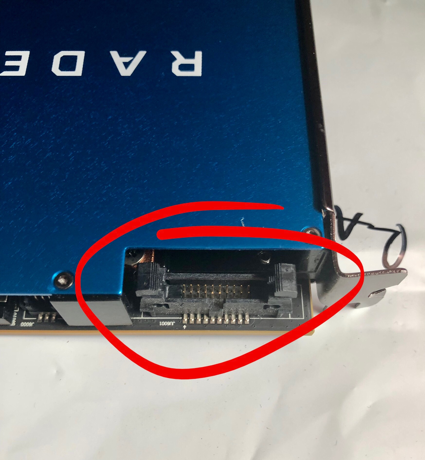

Alright, so the video card arrived but instantly I noticed something I had not noticed in the pictures before and I’m not sure if it’s something I need to worry about or what.
Near the metal plate with all the video ports, I noticed this odd connection:
Can anyone please explain what that’s for or if I need a cable of some type to connect it to my cMP?
This is the connector for a external framelock/genlock.
No, you probably don't need it.
Ohh, I see. Thank you! I kept looking and looking but, without knowing what it's called I could not find anything on it. Every article and video I saw, they all seemed to overlook that connection, as if it didn't exist.
You're right though, that looks something geared more towards high-end production studios. It's a relief knowing I won't have to hunt down the cable that goes with it.
